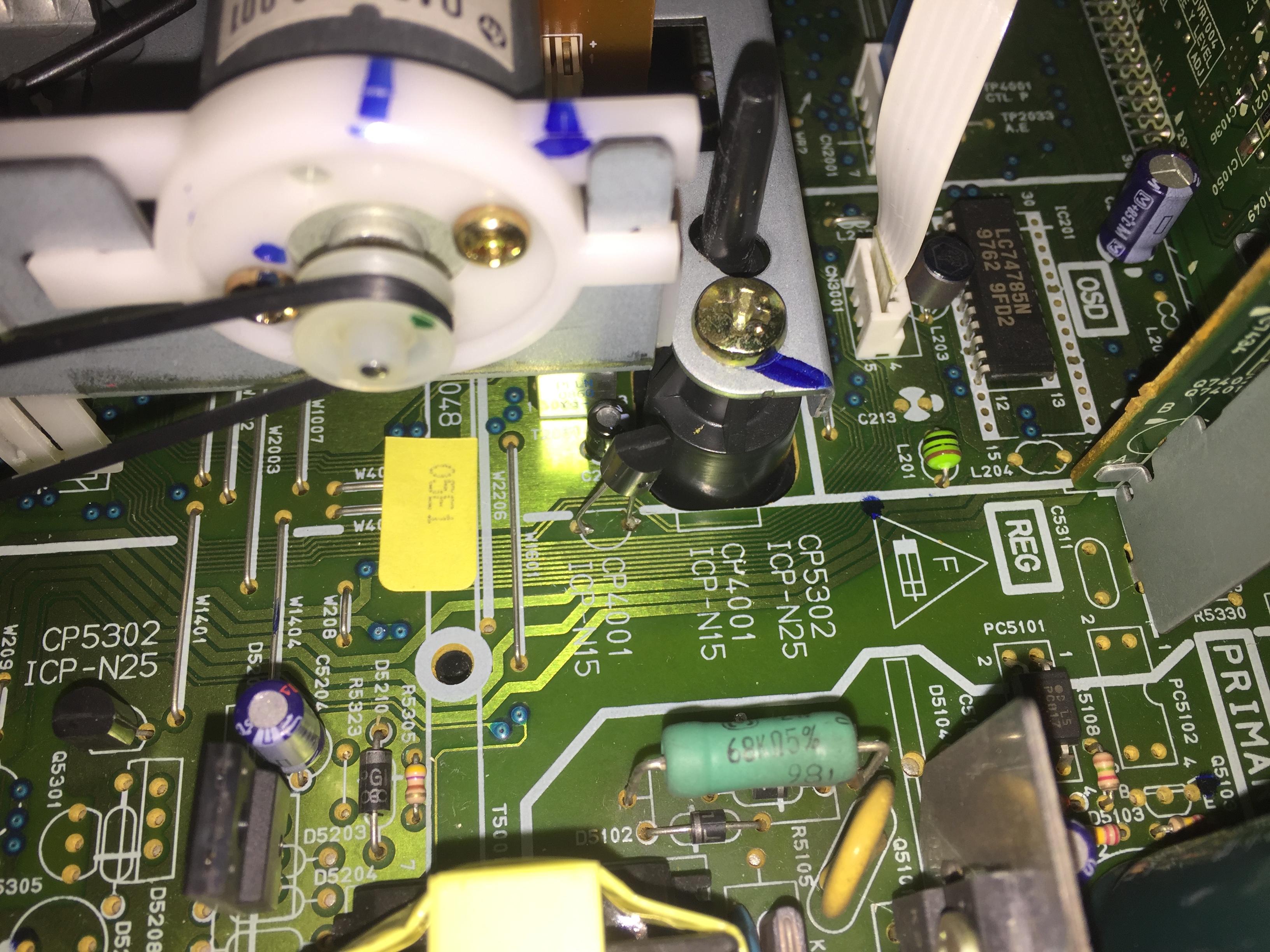

  1. I have a JVC HRS-7600U and the video drum is not spinning, so I found a solution in this thread. https://forum.videohelp.com/threads/357584-JVC-HR-S7600U-troubleshooting-Need-help-to-fix
    I installed a new CP4001 fuse and now the video drum will not stop spinning until I unplug the power cable. It also seems to be spinning too fast. It just auto shut off once a tape is inside.
    Attached is the service manual
    Image Attached Thumbnails JVC_HRS-7600_service_manual.pdf
  2. The drum does not stop spinning when power turned off unless I unplug the power cord.
    The tape loads and ejects properly. Capstan motor turns for a couple of seconds and then the VCRs shuts off.
    First video. The video drum starts spinning once I plug the power cable in and it's spinning too fast as I can feel vibrations throughout the VCR. I insert a tape and it shuts off.
    2nd video is when a tape is inside and I power on, then it shuts off and I press eject.

    This is a circuit protector with two legs. Does it matter which way round it's installed ?
  4. Yes it matters according to the diagram on the board.
    Mar 2008
    Did you get it the right way round ?
    Mar 2008
    Originally Posted by digicube View Post
    yes.
    OK, sorry, I've no further thoughts on this one.

  8. Check out my lazy soldering. I wonder which electronic component controls the speed of the drum.
    Mar 2008
    Doesn't look that bad to me. Did you get it working ?
  10. No. I have to figure what's controlling the drum speed because it won't stop spinning even when shut off.

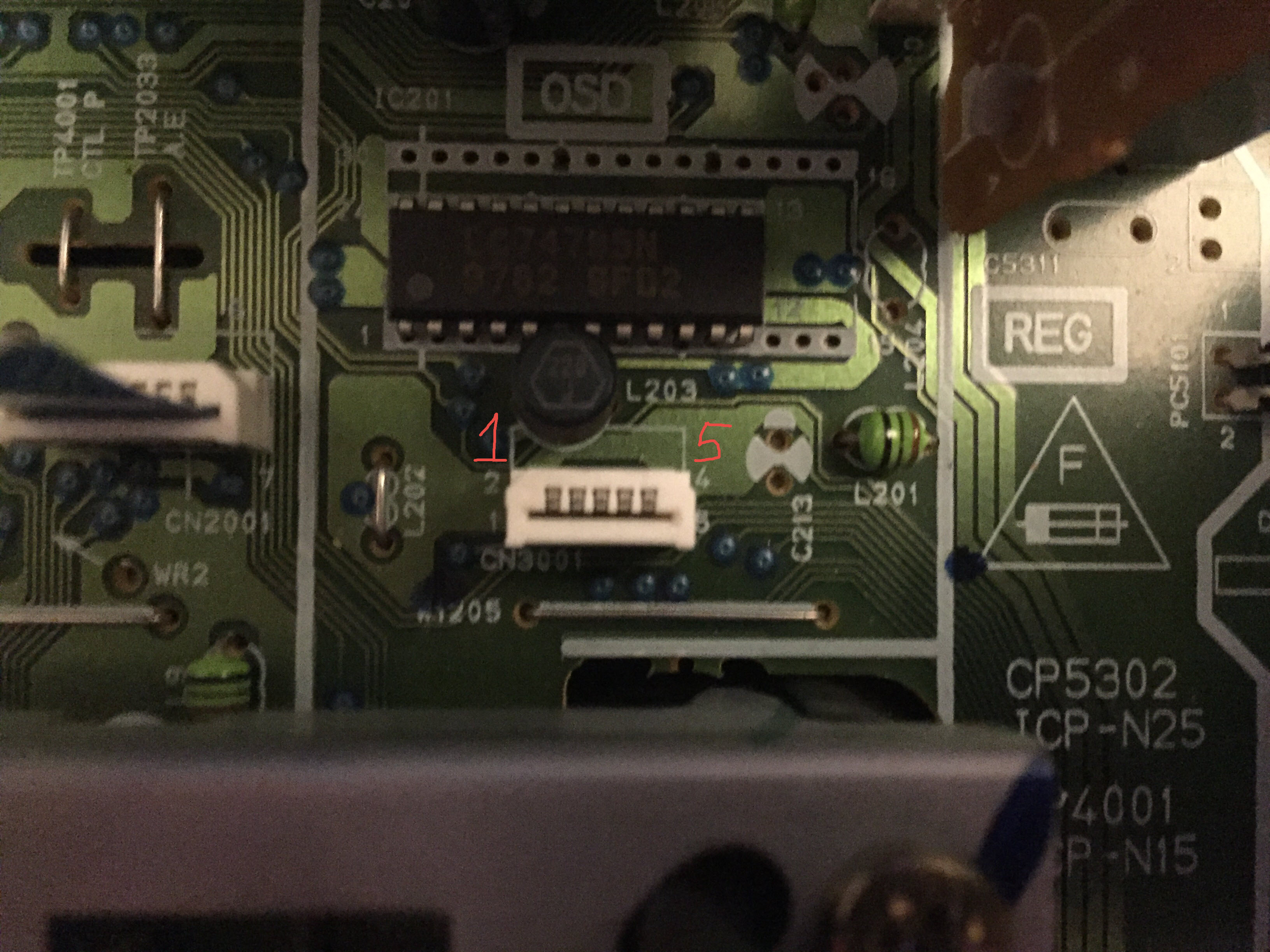

    The fuse blew again, I had to solder a new one again.
    Here is the pic of CN3001 Pin 1-5. Pin 1 is 12V, Pin 2,3,4 is 0V, Pin 5 is 1.3V
  16. Looks like the stator chip JCM5039 maybe bad.
