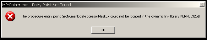

    * ffmpeg.exe in there doesnt work on XP, it returns a prompt right back at me
    * when i ran MP4Splitter.exe in xp, this showed up
    [Attachment 41843 - Click to enlarge]
    * maybe someone can tell me what might cause a kernel problem.
    in the mean time, all cuttings will be done in win10
