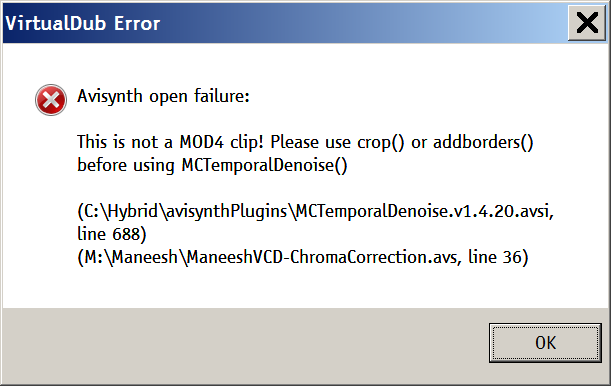

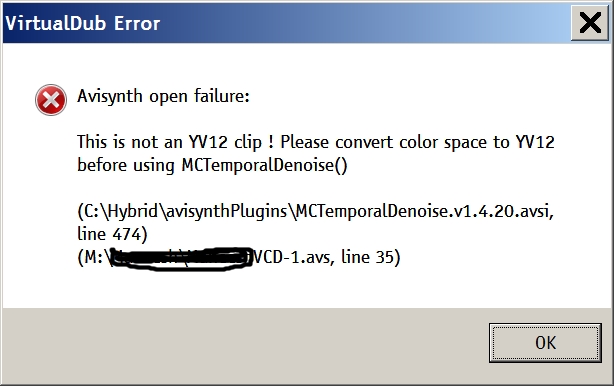

  16. @jagabo
    Using VCDGear, I converted DAT files to mpeg.
    Using VirtualDubMPEG2 to test the script.
    After running the script and modifying for path/installation of various plugins, I am stuck with "AVSEQ001.mpg is not Mpeg2" warning.
    SetMemoryMax(512)
    LoadPlugin("C:\Hybrid\avisynthPlugins\DGDecode.dll")
    LoadPlugin("C:\Hybrid\avisynthPlugins\mt_masktools-25.dll")
    LoadPlugin("C:\Hybrid\avisynthPlugins\YadifMod.dll")
    LoadPlugin("C:\Hybrid\avisynthPlugins\NNEDI3.dll")
    LoadPlugin("C:\Hybrid\avisynthPlugins\SmoothAdjust.dll")
    LoadPlugin("C:\Hybrid\avisynthPlugins\MVTools2.dll")
    LoadPlugin("C:\Hybrid\avisynthPlugins\GScript.dll")
    LoadPlugin("C:\Hybrid\avisynthPlugins\Grunt.dll")
    LoadPlugin("C:\Hybrid\avisynthPlugins\RemoveGrainSSE2.dll")
    LoadPlugin("C:\Hybrid\avisynthPlugins\FFT3Dfilter.dll")
    LoadPlugin("C:\Hybrid\avisynthPlugins\TTempSmooth.dll")
    LoadPlugin("C:\Hybrid\avisynthPlugins\RgTools.dll")
    LoadPlugin("C:\Hybrid\avisynthPlugins\DeBlock.dll")
    LoadPlugin("C:\Hybrid\avisynthPlugins\DctFilter.dll")
    LoadPlugin("C:\Hybrid\avisynthPlugins\EEDI2.dll")
    LoadPlugin("C:\Hybrid\avisynthPlugins\SangNom.dll")
    LoadPlugin("C:\Hybrid\avisynthPlugins\GradFun2db.dll")
    LoadPlugin("C:\Hybrid\avisynthPlugins\AddGrainC.dll")
    Import("C:\Hybrid\avisynthPlugins\GradFun2DBmod.v1.5.avsi")
    Import("C:\Hybrid\avisynthPlugins\Deblock_QED_MT2Mod.avsi")
    Import("C:\Hybrid\avisynthPlugins\SRestore.avsi")
    Import("C:\Hybrid\avisynthPlugins\LSFmod.v1.9.avsi")
    Import("C:\Hybrid\avisynthPlugins\LimitedSharpenFaster.avsi")
    Import("C:\Hybrid\avisynthPlugins\MCTemporalDenoise.v1.4.20.avsi")
    # Mpeg2Source("AVSEQ01.mpg", CPU2="xxxxxx", Info=3)
    DirectShowSource("AVSEQ01.mpg")
    ColorYUV(gain_y=-20, off_y=-10)
    ColorYUV(cont_u=50, cont_v=50)
    MCTemporalDenoise(settings="medium")
    ## Dup(threshold=5, blend=true, show=false)
    MergeChroma(Sharpen(0.2), aWarpSharp(depth=5))
    nnedi3_rpow2(2, cshift="Spline36Resize", fwidth=768, fheight=576)
    ## aWarpSharp(depth=5)
    ## Sharpen(0.4)
    Is my modified script OK?
    Sword is no substitute for kitchen-knife.
  17. Screenshot
  18. Originally Posted by ConverterCrazy View Post
    Use MPEG2Source after making a D2V project file from it. It's explained in the docs included in the DGMPGDec package.
    Mpeg2Source("AVSEQ01.d2v", CPU2="xxxxxx", Info=3)
    Take a look at jagabo's script earlier. There's no MPG mentioned in his script. And forget DirectShowSource.

  30. This code works:
    MergeChroma(MCTemporalDenoise(settings="low"), MCTemporalDenoise(settings="high"))
    Change in people's faces… well, amazing!
    This one doesn't:
    U = UtoY().McTemporalDenoise(settings="high").aWarpSharp(depth=15) # plus sharpening
    V = VtoY().McTemporalDenoise(settings="high").aWarpSharp(depth=15) # plus sharpening
    Y = McTemporalDenoise(settings="low")
    YtoUV(U, V, Y)
    Gives Error:
