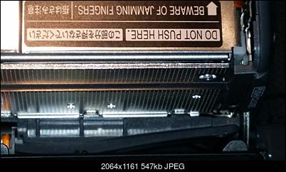

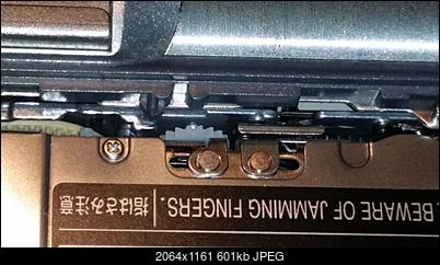

    When I open the cassette compartment cover, I see this hardware. In the gap at the top, the white nylon gear can be turned
    with a probe. The larger one to its left seems fixed and I see no obvious latch to open the compartment.
    This pic shows the cover that's not openng. The metal lid is pushed towards me by a spring and when push the lid in and out, the gap closes.
    However, when I let the lid go back to its rest position (as here) it's clearly latched by a metal stop, whose action can be felt. If I gently insert
    a ****tail stick, there seems to be a tape in there.

    If the problem were just a jammed cassette, the camera would at least light up and chirp and you might hear a motor straining before it gives up. There is a problem in the power path and/or the microprocessor is dead.
