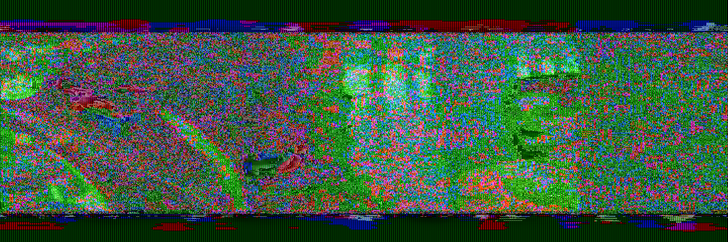

  1. Hi videohelper's , i am struggling to get start with 16bit (High_bit_depth) encoding but it is not working correctly in 10bit . i am getting all green picture with the double width/1440 but height/480 remain same after encoding (it is my first time i am trying learn but cant figure it out ), please can someone point me to the right direction, how this should be done ?
    I am using MeGUI with Avisynth Plus
    this was script for starting test
    Loadplugin("C:\Users\Mod\Downloads\ffms2-6e0d654+a9fe004-ffmpeg-1e4d049\ffms2.dll")
    FFVideoSource("C:\Users\jo\Video\Jasmine Sandlas Ft. DJ Flow - White Hill .mp4", fpsnum=25, fpsden=1, track=-1, cache=true ,seekmode=1, enable10bithack=true,  resizer="spline", threads=1)
    Dither_Convert_8_to_16()
    smdegrain(tr=3, slices=true, lsb_in=true, lsb=true, lsb_out=true, mode=0, Always_MdegrainN=true )
    GradFun3(thr=0.35, radius=12, elast=3.00, mask=3, mode=0, smode=0, debug=0, lsb=true, lsb_in=true, staticnoise=False, thrc=0.35, radiusc=12, elastc=3.00, y=3, u=3, v=3)
    LinearResize(720,480,kernel="spline36",mode=0, Lsb_in=true, Lsb_out=true)
    Dither_out(bigendian=False)
    I was excepting normal picture just with more bits pixel , my result is in 10bit but looks terrible . which tool i use to do this High bit-depth encoding ?
    Any help would be much appreciated ,TIA.

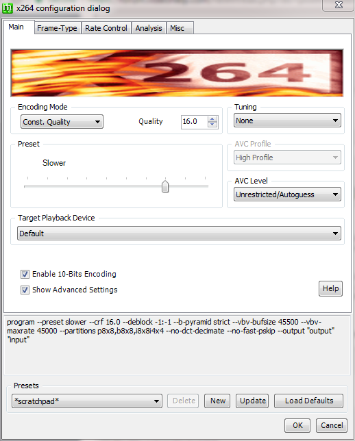

Name:	MeGUI x264 10-bit.png

    it is working mate check here http://prntscr.com/ff7d48 but result are all green (i wasn't clear about dvd shouldn't be processed) so only Blu_ray or HD material should be used , and please can u post a script to start test for avs2pipemod to read the 10bit hack.

  15. Originally Posted by BÌG•bµdd View Post
    Yes, that's what I meant and expected by "not working".

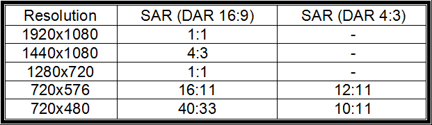

  27. --sar for aspect ratio, e.g. "--sar 40:33" for NTSC DVD with 16:9 display aspect ratio.
    [Attachment 41804 - Click to enlarge]
    --crf to control quality/bitrate, --bitrate if you need a specific bitrate (ideally with 2 passes). I recommend --crf, e.g. "--crf 18".
    great , sneaker u r very good on it , thanks lot mate now all good to start with Dither_out . happy dayz
