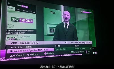

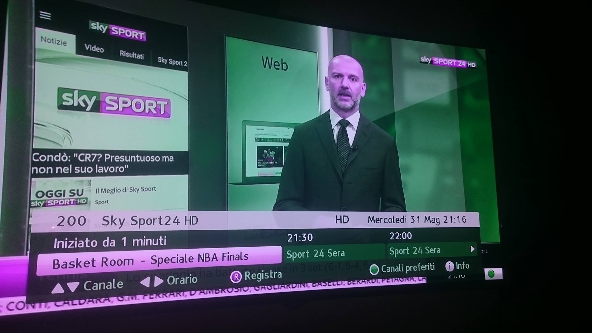

    i have a satellite decoder given to me by my provider (i watch mostly football)
    I have a avermedia 727 capture card and a splitter HDMI (the one that takes off the HDCP, as seen in another thread)
    Yesterday the provider sent an update, and since then the screen has false colours, mostly pink and green (what should be blue is green, what should be red is pink)
    If you only attach the television, the screen is ok, but if you attach the avermedia card, BOTH screen turn green and pink, and even with only the card, it's still pink and green!
    It was working fine until the decoder update !! Whats this and how can i bypass it?

    my problem is not sporadic, and i tried even with the card disconnected from the pc... as soon as i plug the HDMI in the avermedia card, the television becomes green and pink. But if i put both exits of the splitter on different channels of the TV, they both work fine!
    So the problem would appear to be that the update of the DVR created some issues of compatibilty with the avermedia card!
    Do someone have an idea on how to resolve this issue?

    exactly.. weird isn't it?? but the weirdest thing is that it started after a software update on the Satellite DVR and i know it's not a coincidence because last month same thing happened and they changed my DVR... but after a month of everything working perfectly, software (or firmware) comes and screws everything up!
