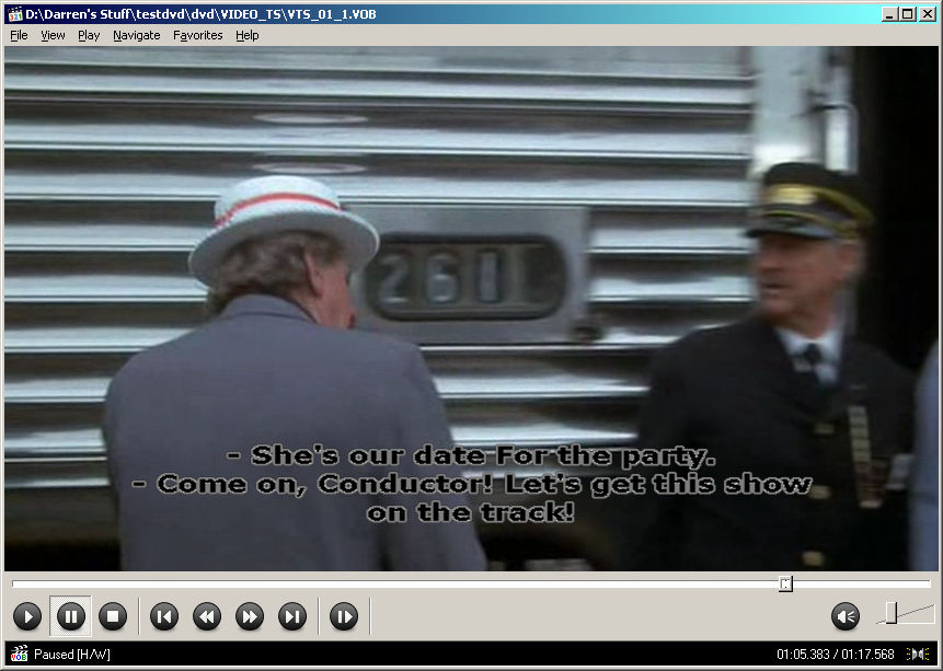

  2. I tried vlc and Media Player Classic Home Cinema and also the Windows Print Screen. All had the subtitles. Here is a test DVD (27mb) with subtitles (have to be enabled) if anybody else wants to try and find a method to screenshot capture without the subtitles with the subtitles enabled.
    https://files.videohelp.com/u/61125/testdvd.zip

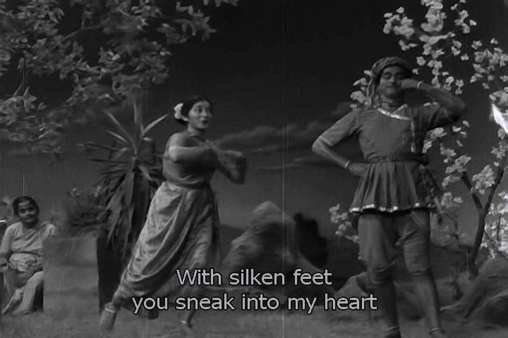

  3. So far, I haven't been able to convince MPC-HC to save the subtitles with the picture. I've tried two different renderers and an external subtitle filter, but only the "picture" is saved. If I use PrintScreen to capture the image I get the subtitles too, but not when saving an image with Alt+I. Maybe it's an XP thing.

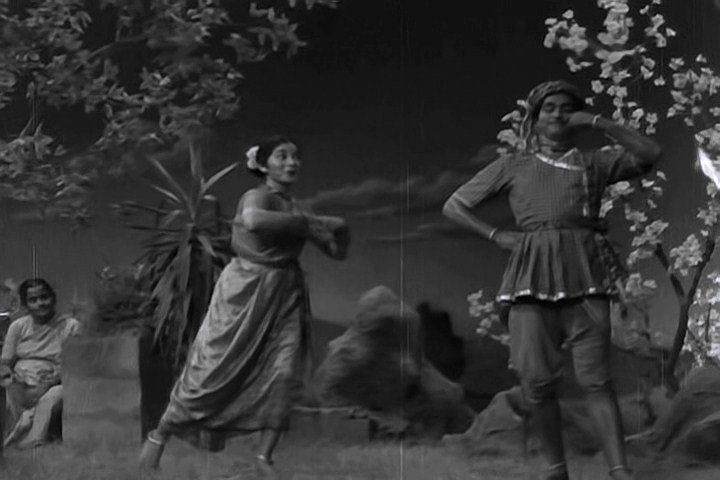

    On the other hand though.... Alt+I saves the image using the picture resolution, not the picture aspect ratio, so a DVD will always save as 720x480 or 720x576. If that's not satisfactory you could try MPC-BE. I don't use it myself but I believe it saves images with the same aspect ratio as they appear on the screen. Or you could batch resize the images when you're done saving them.

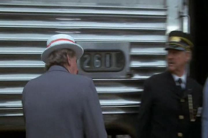

  7. Using MPC-HC I have to turn on the subs. With them on I take pictures (File->Save Image) with subs, with them off I take pictures with no subs.
    To choose one or the other I right-click the screen and then Subtitle Track->Enable DVD subtitles (on or off). I have no idea why "turning off the subtitles to take each screenshot is not an option."

  8. Originally Posted by DB83 View Post
    ^^ Didn't XP handle the video acceleration/overlay different to more current OS's such as Win7 . Could explain why it's working for you and not us mere mortals.
    But snap-shot within the player will always capture the SAR. No way around that methinks.
    Curiouser and curiouser....
    Because manono mentioned "DVD subtitles" it made me wonder, as the MPC-HC menu doesn't say "DVD subtitles" if you don't open a DVD the traditional way, and that's something I almost never do as I rarely play DVDs. So it turns out if I open a vob file directly or open it via a corresponding IFO file, the subtitles aren't included with using Alt+I. If I open the DVD via the VIDEO_TS.IFO file, or via the File/OpenDVD menu, the "DVD Subtitles" option appears in the subtitles menu, and the subtitles are included when using Alt+I.
    I tried an MKV containing both srt and DVD subtitles and in both cases the subtitles weren't included with the saved image, so maybe it's just a DVD thing, although I don't know why they'd work differently.
    I did realise the subtitles in the sample from the second post are displaying oddly if I open the vob file directly. Initially I thought someone created crap looking subtitles, but if I open the sample via the File/Open DVD menu the subtitles look normal (white text). If I open the vob file directly though, they display as black text with a white outline as they do in the image in my previous post. When I tried to extract them so I could mux them into a different container, VSRip said it found an encrypted sector but no key to extract them, so maybe that's the problem there.
