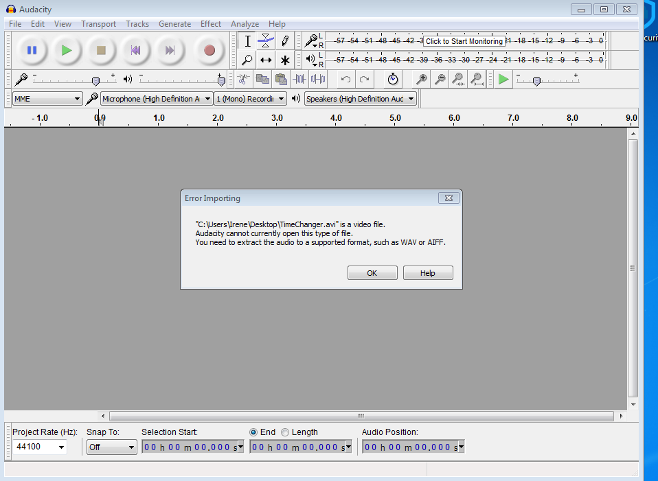

    I downloaded the ffm peg and extracted all to audacity but when I try to open the file to work with the audio i get the error "audacity cannot open file, you must first extract the audio to an avi file. Or something like that. I was able to make an mp3 file of it however. Thanks

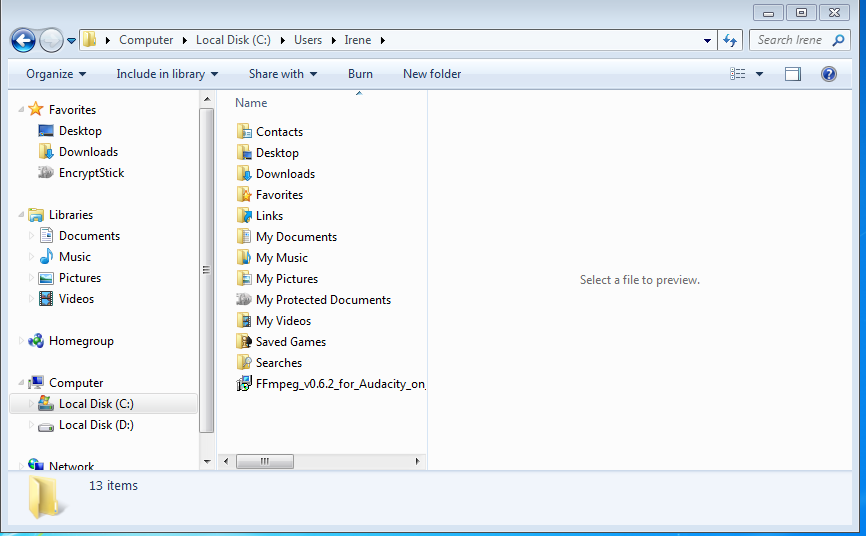

    Apparently the avformat-55.dll.mine is not in the zip or win file I downloaded to my pc. I cannot open a .dll file so I cannot check it but when audacity searches for it nothing is found. I downloaded both the zip (and extracted it) and the win file. Thanks
    Image Attached Images
  19. You downloaded the wrong package. You want "FFmpeg v0.6.2 for Audacity on Windows.exe" or the ZIP version from here:

    I hate to be a smudge/problem but audacity still will not open the video. Should I convert this file to another format? Thanks

  21. Did you tell Audacity where the dll is? Edit -> Properties -> Libraries -> FFmpeg Library -> Locate.
  22. Member
    May 2017
    Philippines
    When I go to pref and try to "locate" audacity does not find it. I put it in the audacity folder twice and still audacity cannot find it. So then I browsed for the location but the file is not there in audacity where I put it twice so I cannot show audacity where it is. Besides, this is an executable file. It has its own installer which I used and installed. Confused.
