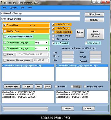

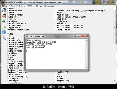

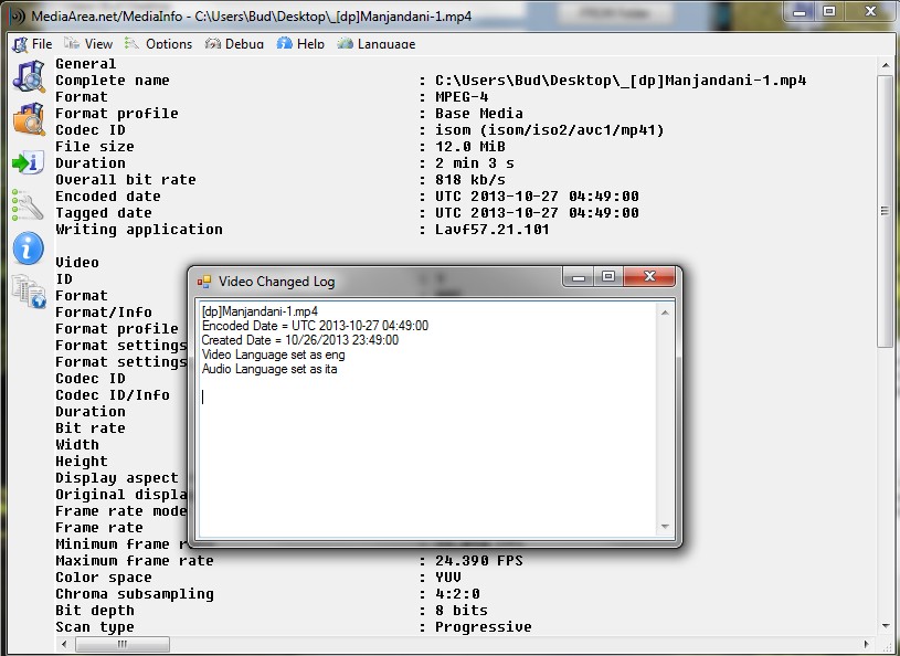

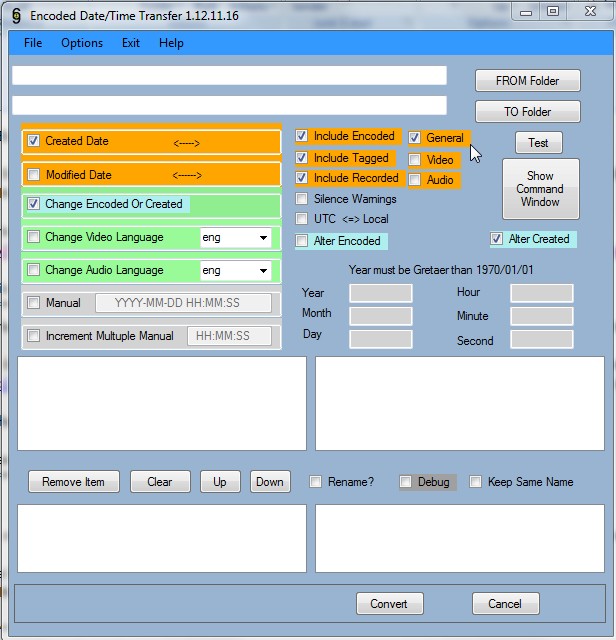

    @ArieTillens, I have redone the date change program and cleaned up the code and added a guide to it but still need a few tests to run on it. It takes the Windows Created date OR Modified Date (Modified checkbox overrides Created) and sets it into the Video Metadata Encoded and Tagged dates.
    It also Reads the Video Encoded date, Tagged date, and Recorded date and uses whichever comes first in that order and changes the Windows Created date and/or Modified date. So it works both directions. You can also set Dates manually (encoded/Tagged/Created/Modified).
    Basic instructions are:
    Manual Alter Encoded checked
    Encoded set to Manually set Date/Time
    Created set to Original video Created Date/Time
    Modified set to Original Video modified Date/Time
    Manual Alter Created checked
    Encoded remains the same as set Manually or from Original Copy
    Created set to Manual Date/Time if {Date Coded <-> Created} checked, else Original video date/time
    Modified set to Manual Date/Time if {Date Coded <-> Modified} checked, else Original Date/Time
    If changing both Encoded and Windows Created times, manually, set Encoded first then Alter Created
    Auto Alter Encoded checked, Only {Date coded <-> Created} checked
    Encoded will be set to the Original Created Time
    Auto Alter Encoded checked, {Date coded <-> Modified} checked, OVERRIDES {Date coded <-> Created}
    Encoded will be set to the Original Modified Time
    Auto Alter Created and/or Modified checked
    Encoded remain the Original Encoded Time
    Created set to video Encoded Date/Time, if {Date coded <-> Created} checked, Else Original Video Created
    Modified set to video Encoded Date/Time, if {Date coded <-> Modified} checked, Else Original Video Created
    Silence Warnings eliminates Popups telling you that the file already exists as when you manually change the
    encoded and the wish to change the Created on the same files. It also stops warning that no data was found during
    Encoded to Created methods. A summary window will show this information instead.
    UTC <-> Local makes Video UTC and the Local time zone time of your computer the same.
    THIS IS NOT A NORMAL SETTING SINCE VIDEOS ARE ALMOST ALWAYS IN UTC DATE/TIME FORMAT.
    WINDOWS CRATED/MODIFED/ACCESSED ARE ALWAYS IN LOCAL DATE TIME FORMAT.
    The only reason this is here is someone requested it even though it makes their Metadata invalid.
    The Latest download is posted below but the new one will be posted soon. It also allows to set the language of the Video and/or Audio Track.

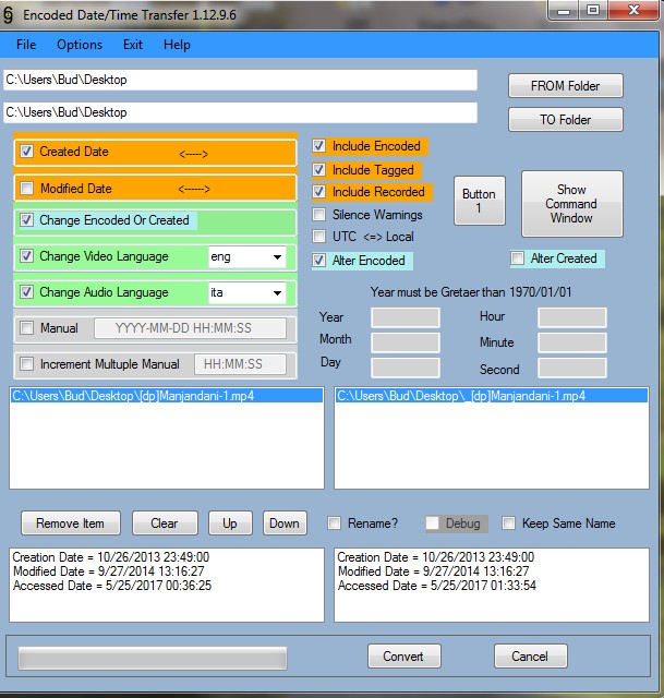

    @ArieTillens,, In the mean time download the program from https://files.secureserver.net/0shb4dnzGQzyPe and set up as shown in the attached image. I tested in on mp4 Videos and it worked correctly. It will also do a folder at a time.

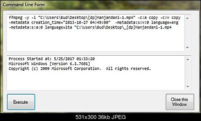

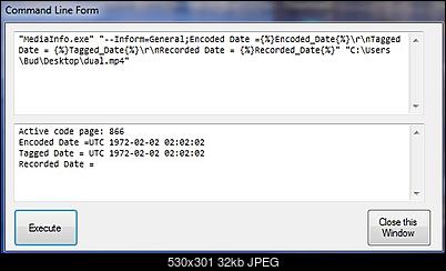

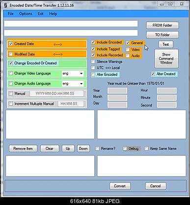

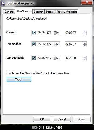

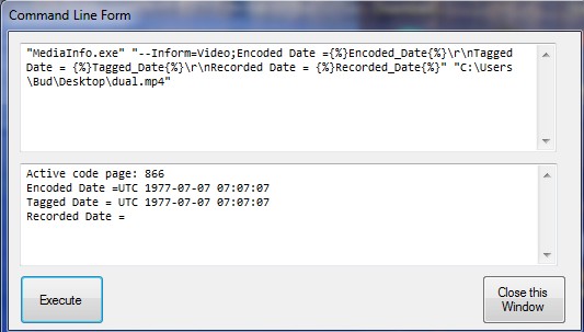

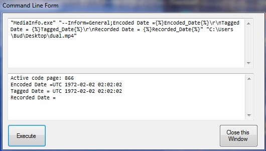

    Just so i have it right, you wish to find the encoded date in the video metadata and change the windows created date to the same correct? The program uses media info to find "ENCODED DATE = YYYY-MM-DD HH:MMD" . This should be showing in tbe lower box of the command window.
    Setting the checkboxes is critical to cause the search and replace functions to occur in the right direction. If you use manual the checkbox for that is also necessary. other information is shown below. Can you post pictures or let me know what it says?
ID:	41717Click image for larger version
    Bear in mind ENCODED is in UTC time and the created date for windows will be off whatever your time zone is. THIS IS NORMAL If you want otherwise use manual or check UTC <--> Local checkbox. Noticed in my example created date is -6 hours behind and on the 2nd of march at 21xx because Encoded date is the on the 3rd of March at 03xx. I am in the USA Central time zone -6 hours from UTC.
    The new version is almost ready except for final test which i am doing as we speak.
    Budman1

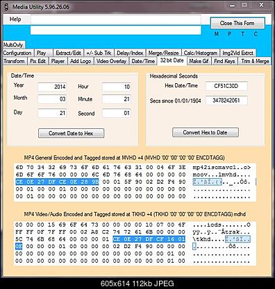

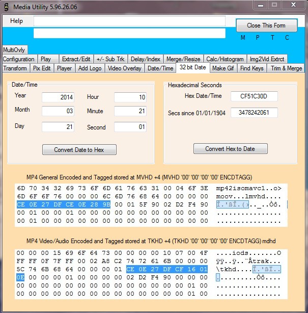

    @ArieTillens I see the video Date/Time Metadata is different than the Header Date/Time Metadata. This would be harder to do unless a routine was written especially to change certain BYTES in a video file. MP4 data is written in 'Atoms' and the date and time is 4 bytes for encoded and 4 bytes for tagged. It is a binary representation, for all extents and purposes, to be the number of seconds since midnight 01/01/1904.
    The header Date/Time is stored inside the MVHD atom(s) and can be found with a hex editor.
    The Video and Audio is stored inside the TKHD atom(s) and can be found with a hex editor.
    There is also Date and Time stored in the MDHD atom(s) but MediaInfo does not report this Date/Time.
    So to change your date and time you would need to convert 2014-03-21 10:21:01 to seconds and search for the 4 byte offset from TKHD and input the 4 byte binary designation for Encoded, followed by the 4 Byte Tagged Binary designation. TKHD is most often stored in multiple places(2). It would most likely be a different program to do that. OR use the Manual function with the boxes set to 2014/03/21 10:21:01.

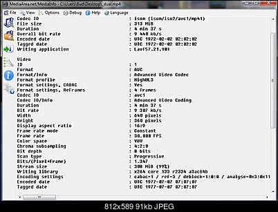

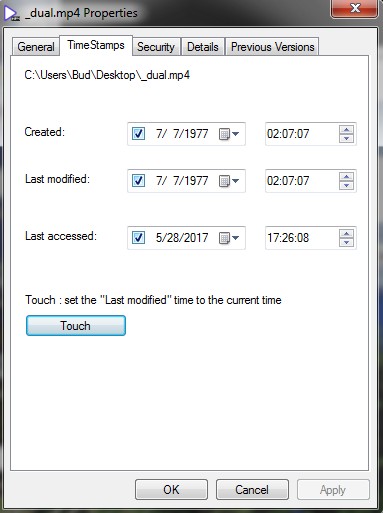

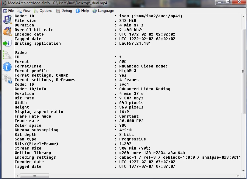

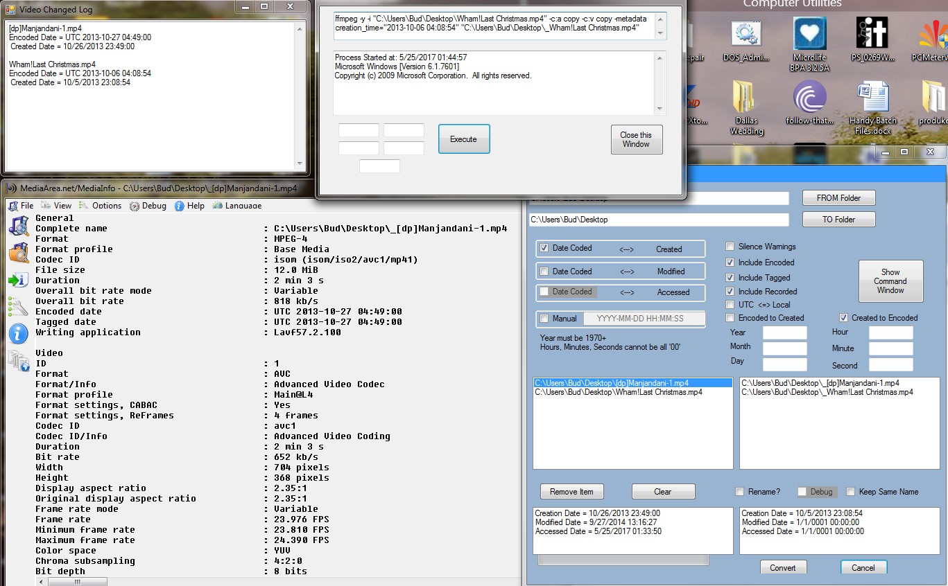

    UPDATE: I stand corrected. I can set a video from the VIDEO encoded date but would need to adjust my program. I just need to have MediaInfo query from a different area. I created a video with a hex editor so the dates are different:

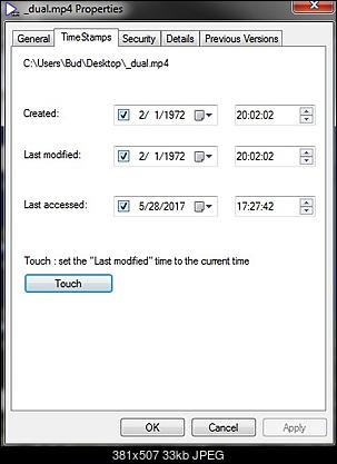

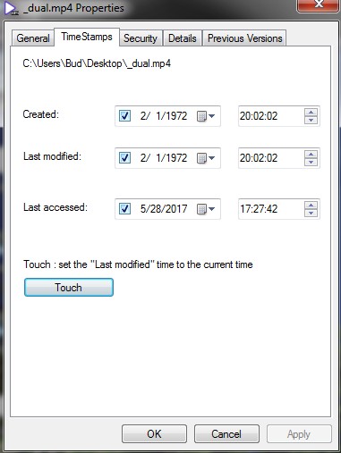

    Then I altered the Created with the regular method:
ID:	41744Click image for larger version
    Then I changed the query for the Video:
ID:	41746Click image for larger version
    I guess he doesn't need the new version:
    Budman1

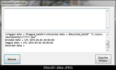

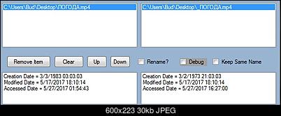

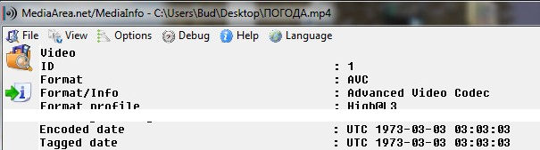

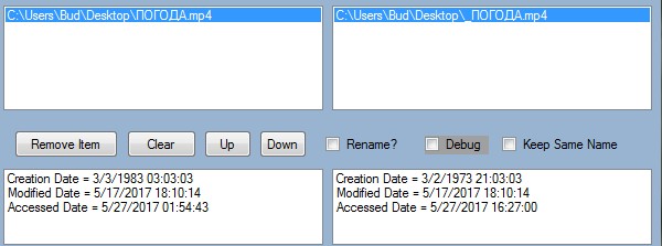

    In trying to make my program accept Cyrillic characters, it works for some, for others there appears to be a problem of noisy busses or I/O because extra characters are being dropped and/or added to the string being sent to the CLI(CMD) Window. For that reason I pulled the links and am rewriting back the way it was. If Cyrillic is needed, you can copy the script from the media Info window and copy straight to a CMD window and it should work.
    I should have a new link in a couple days.
