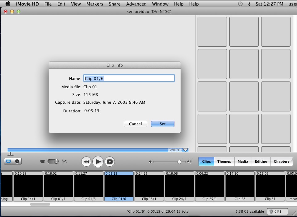

    Here's a screenshot in case that helps!
Name:	Screen Shot 2017-05-20 at 12.27.04 PM.jpg
  4. Check under the media tab as well and get the information for individual clips.
    Is your audio playing?
    Do you have Quicktime 7 loaded as well as QTX? I believe QTX does not have any DV codecs.
