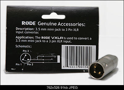

  4. You're probably trying to connect TRS 1/8" jack , wired with both tip and ring connected to the receiver +signal, and the sleeve connected to ground. Connecting that to balanced XLR input won't work.... feeding the same signal to both XLR + and - input pins will result in no signal -- as you have aleady discovered.
    You need to use an adaptor like this: https://www.bhphotovideo.com/c/product/387850-REG/Rode_VXLR_VXLR_Mono_Mini_Jack.html
    That is wired like this Click image for larger version
ID:	41684 which should do what you need
    Don't forget to make sure that any phantom power on the XLR input is turned off. It probably wouldn't damage the receiver output anyway, but best to not chance it....
