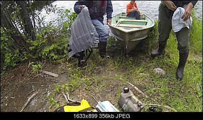

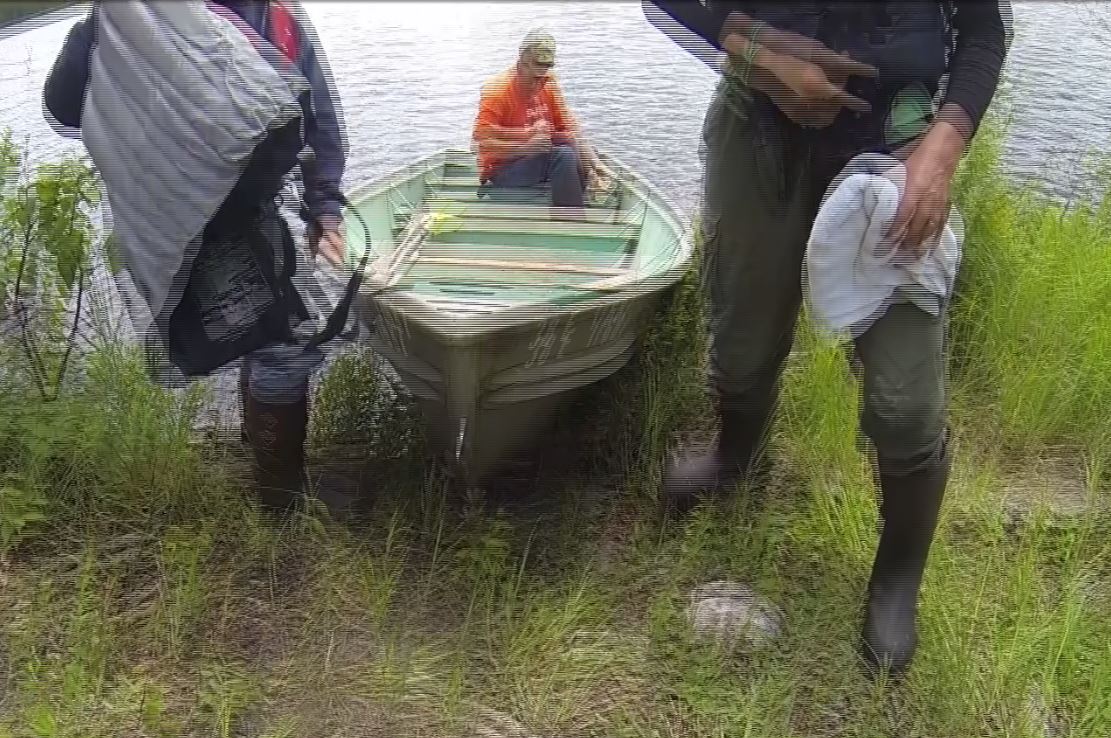

  3. Here are pictures of the problem. Two images showing essentially the same frame. The high quality picture is from the MP4 file that I created with Premiere Pro. The poor quality pictures is from the Blu-ray that I burned using Adobe Elements from the MP4. The source video came from a GoPro Hero3 @ 1920x1080 resolution.

  4. Blu-Ray has to be 1920x1080 30i interlaced or 1280x720, 60p progressive frames. Note that making 30fps (30i) interlaced footage from 30fps progressive could end up weird.
    If original footage is 30p then make 1280x720 60p footage just duplicating frames. I have no idea how to set it up in Premiere so it would not try to make new frames using blend and similar method, the best thing here seems to just duplicating frames.
    If original footage is 60p, then again, make 1280x720 60p Blu-Ray (btw no one will notice, there will be no one approaching you and saying, hey, this is not 1920x1080, but just 1280x720). If for some reason you insist on keeping resolution 1920x1080 then you have to make footage interlaced with that risk software not handling this well. But definitely give it 60p source to begin with, not 30p as you did. You might eliminate creating those "ghost" frames.
    Why would you not make Blu-Ray right from your timeline, from those original clips?

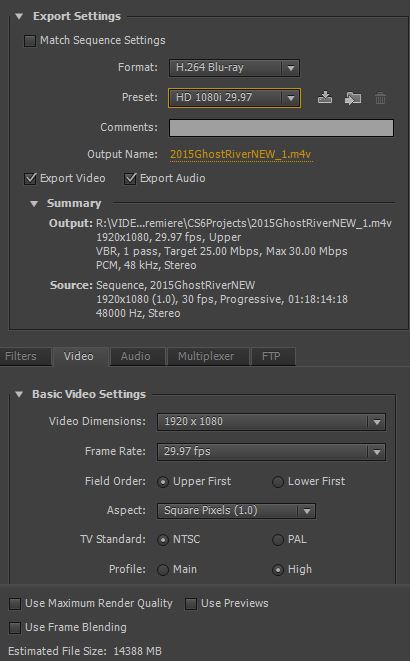

  5. Thanks for the suggestions _Al_. I still must not be doing something correct. The individual video clips on my Premiere Pro timeline are a mix of 30 fps and 60 fps mostly at 1920x1080 resolution. I took you advice and rather than trying to burn the blu ray from the MP4, I made a new export from the original PP sequence using the "H.264 Blu-ray" format with the "HD 1080i 29.97" preset selected. I then burned this export to a Blu-ray and am still getting the same jagged edges. I am surprised that I am getting this kind of issue using PP's default Blu-ray export. I must still have something wrong. It the problem that I am using Adobe Elements to burn it? I would be happy to try a different burning software but I don't have anything else. Ideally I would like to be able to make a simple menu with chapter markers but even just having the video burned without titles would be OK if the quality was high. I attached a photo of my PP settings I used for the export.

  6. So direct timeline render did not help, so it is interlace problem, or rather making progressive footage as interlaced. You shoot interlace, you encode interlace. If you try to make interlace , that is the other story. You can always burn 60p as data, but sure no menu, chapter.
    I talked about 1280x720 60p for Blu-Ray - because it is not interlaced . Your problem is making your footage interlaced.
    Making your 60p footage as 30i would get rid of half information anyway, sure resolution is kept (but one field has 1920x540 anyway, it is just your TV or player that computes it back to 1920x1080, each frame , 60 frames per second), but anyway, what is true, real resolution of your video anyway, 1080 lines per frame? I'd think it is not.
    720p keeps temporal resolution and does not make footage interlaced. Sure downscale looks at the first sight as drastic measure, but it is really not in our case (comparing to 1920x1080i). Not sure why folks are afraid to export 720p60 and put it on BD, it looks great.
    Hopefully Premiere would just duplicate frames for those 30fps clips. If you can prohibit making some blending or such in settings, I'd do so.
    Your sequence is set to 30p, not sure how Premiere works , if it calculates output from sequence properties or directly from clip properties, there might be problem also, you might do a quick test with sequence set to 60p (or 59.94p, whatever your clip fps is)
