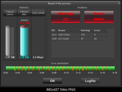

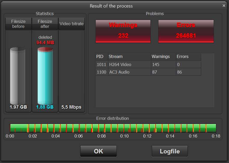

  5. Also, TSDcotor seems to readily identify the issues as "sync_byte_error" and "packet discontinuity"

  7. could tsdoctor repair it ? videoredo has a "quickstream fix" that might be able to help , I think it might be functional in the trial version
    You mentioned "regardless of player" - I'm assuming software - but could you play it in camera ?
    if you demux a/v with tsmuxer, can you remux (either back into transport stream or other container e.g. try mkvmerge) and play audio and/or video stream separately or together without errors?
