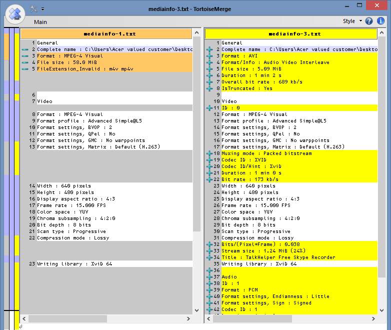

  12. Like everyone is saying, something looks odd here. Please post a MediaInfo report of a known good video.

  18. Thanks. I don't know what to think, though. Is MediaInfo merely guessing about the "bad" files?
