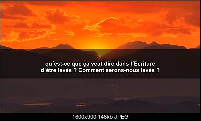

    I have been looking into how I could possibly hardcode subtitles on a transparent box, so as to make them more visible on top of the videos I make. I have seen many different threads on the internet, but I must admit I just cannot understand how to run FFMPEG, so I thought I would stick with VirtualDubMod. I found one way which is the closest way I found to do it: The logo filter in VirtualDub. I have prepared a transparent box png file with Gimp, which is just the size of my video.
    See here.
    But unfortunately the box is coming on top of the subtitles, as you can see from the screenshot above.
    Do any of you have any idea how I could solve this issue, or if there is any other way I could come to this goal?

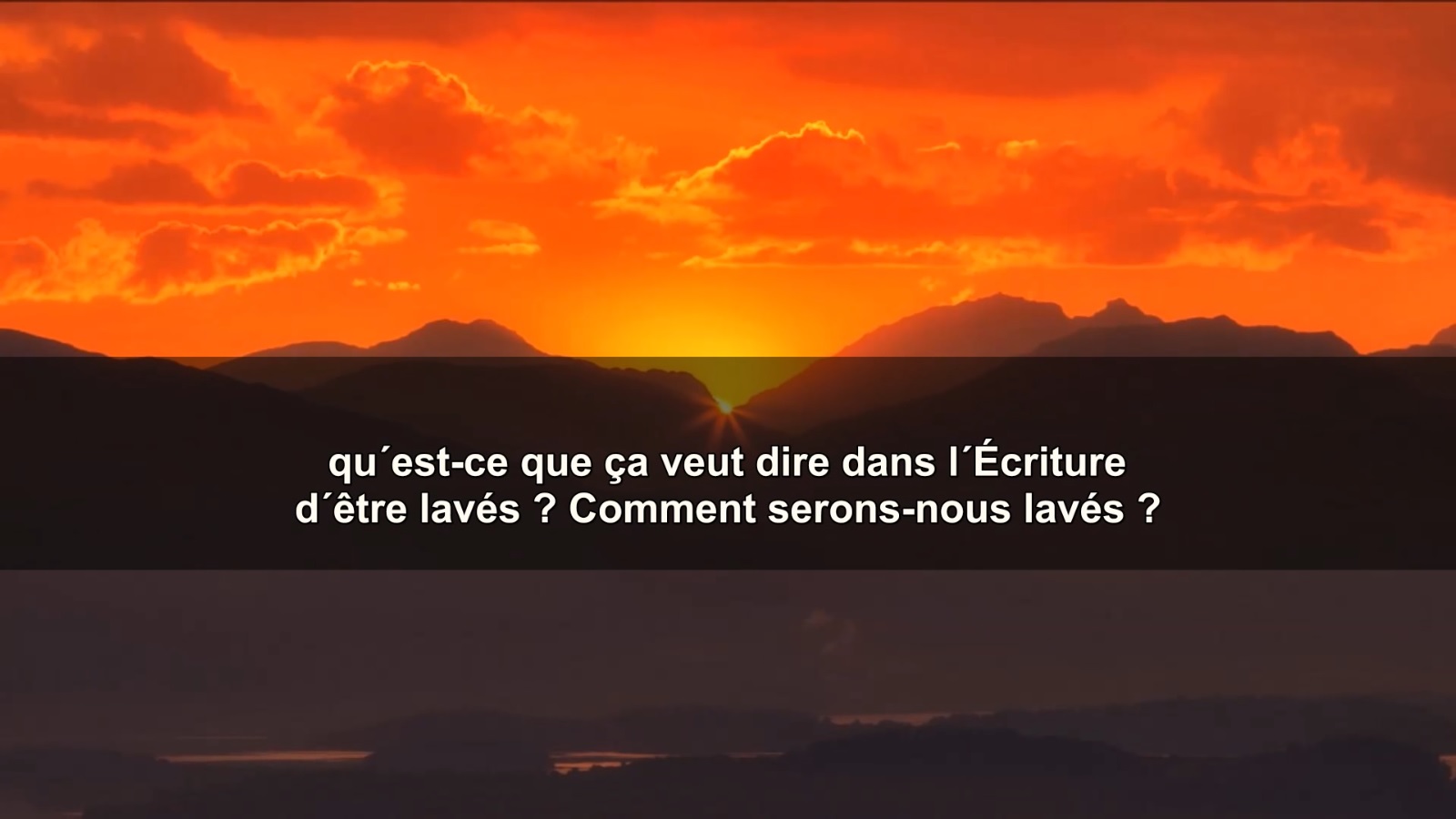

  6. Wonderful. Thank you so much sneaker. The filters do indeed work from top to bottom. This is what it looks like now: Click image for larger version
    I'm glad there is a simple way to do it. Again, thanks a lot for your time and help.
