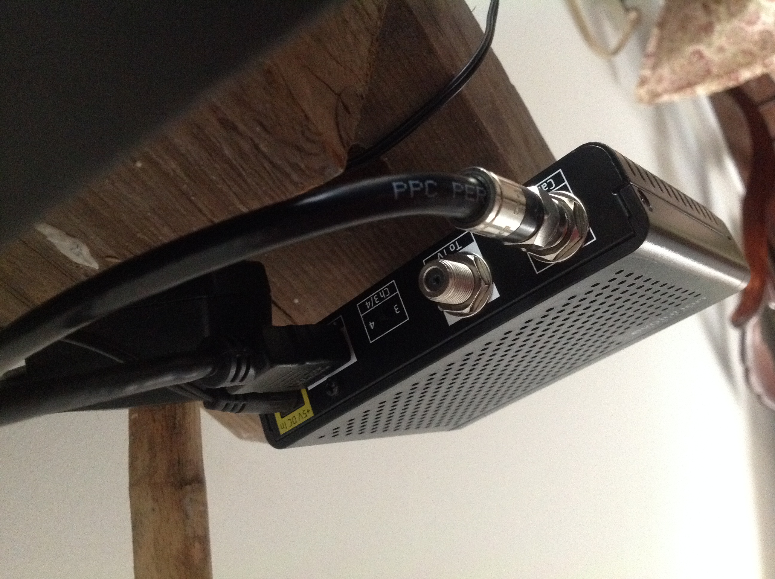

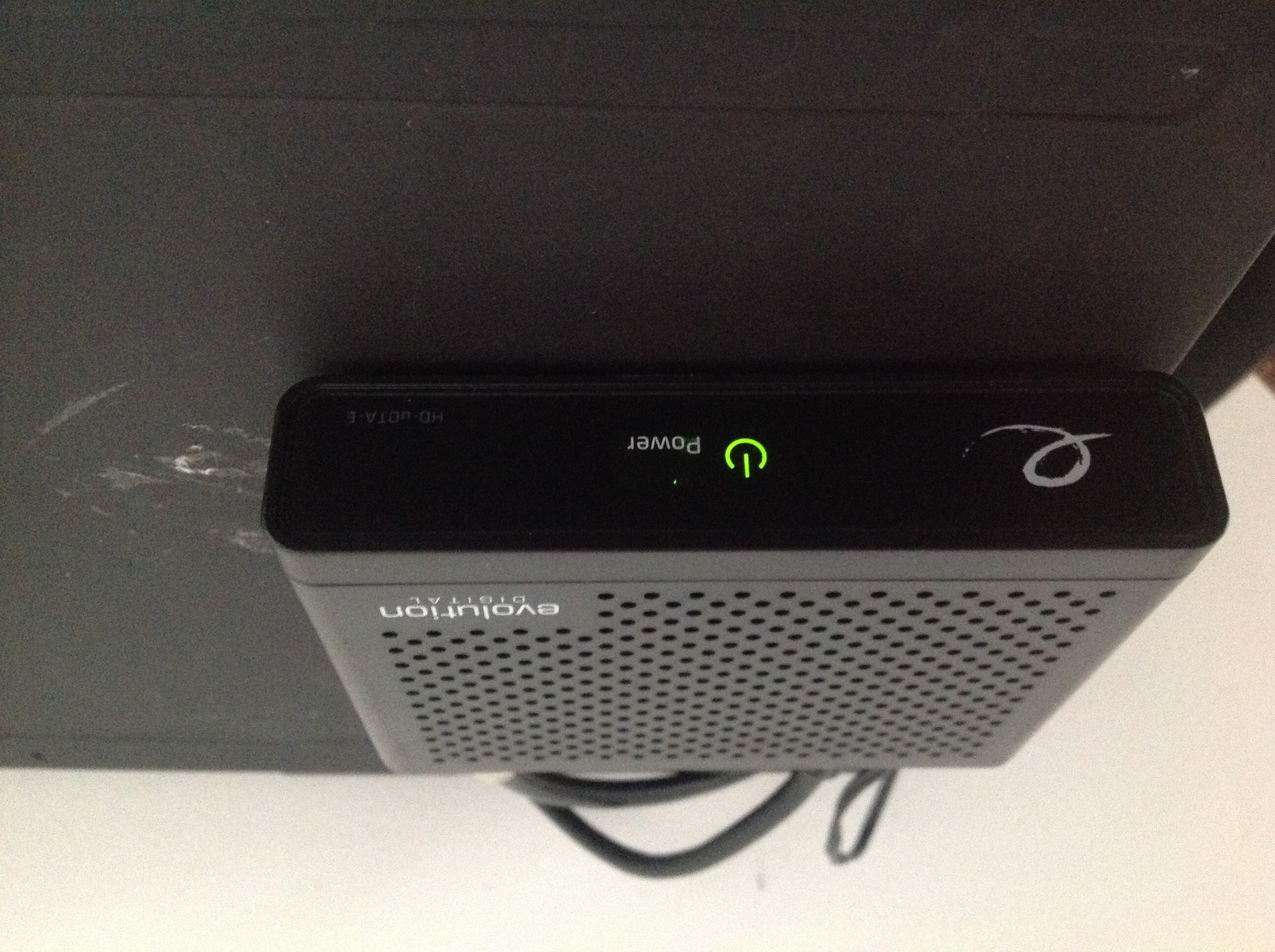

    [Attachment 41544 - Click to enlarge]
    [Attachment 41545 - Click to enlarge]
    here is the Evolution box from Adams Cable

    Your Evolution cable box has only RF out for its SD connection, so it uses an analog channel (3 or 4) to provide an SD signal. You need to connect the cable box RF out to the Magnavox 515H/F7's Antenna In with a short RF coax cable, and tune the Magnavox to either analog channel 3 or 4 depending on which setting is selected on the "3/4 switch" on the back of the Evolution cable box.
    The TV needs to be connected to the Magnavox 515H/F7 using the lower set of AV connections (labeled OUT) at the rear of Magnavox 515H/F7, or using the Magnavox 515H/F7's HDMI connection.
    Note that the Magnavox 515H/F7 can only record whatever channel the cable box is tuned to at the time. A DVD recorder can't change channels on the cable box.
    If the TV has only one HDMI port, and you want to use HDMI for both the cable box and the Magnavox then you need an HDMI switch and 3 HDMI cables. (The cables won't be included with the switch).

  5. Ugh: now that you've posted photos of it, I can see the Evolution isn't a proper cable box. Its one of those godforsaken garbage DTA pods the cablecos now force on their budget customers who refuse to give up their "boxless" service plans.
    You have no decent recording options available from this piece of junk. The only possible Magnavox connection is what usually-quiet described: RF output to your Magnavox antenna input, with the Magnavox tuned permanently to channel 3/4.
    Recorded picture quality from that connection will be somewhere between mediocre and dismal. If its a smallish HDTV, you might be able to tolerate it. But if you have a 32" or larger screen, its gonna look ugly. If all you use the Magnavox for is disposable time-shift recording, you might find the results acceptable. You can get somewhat better recording quality from an actual decoder box with the line output connection described in my first reply, but you have to pay $10-$20 per month extra for that (and you'd still end up with letterbox black borders). Or, you could purchase an HDMI>Composite adapter from Amazon, and connect it between the Evolution and your Magnavox. This will give you full widescreen recordings, tho not true HDTV.
    Cable and satellite service are no longer compatible with Magnavox (or other) dvd recorders for reasonable picture quality. If at all possible, use an off-air antenna connected to the Magnavox for local channels: the unit is optimized to make best possible recordings from its own tuner. The minute you bypass the internal tuner with external cable or satellite hardware, recording quality and timer convenience go out the window.

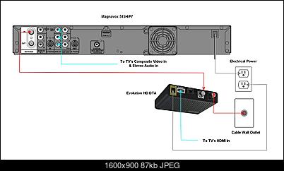

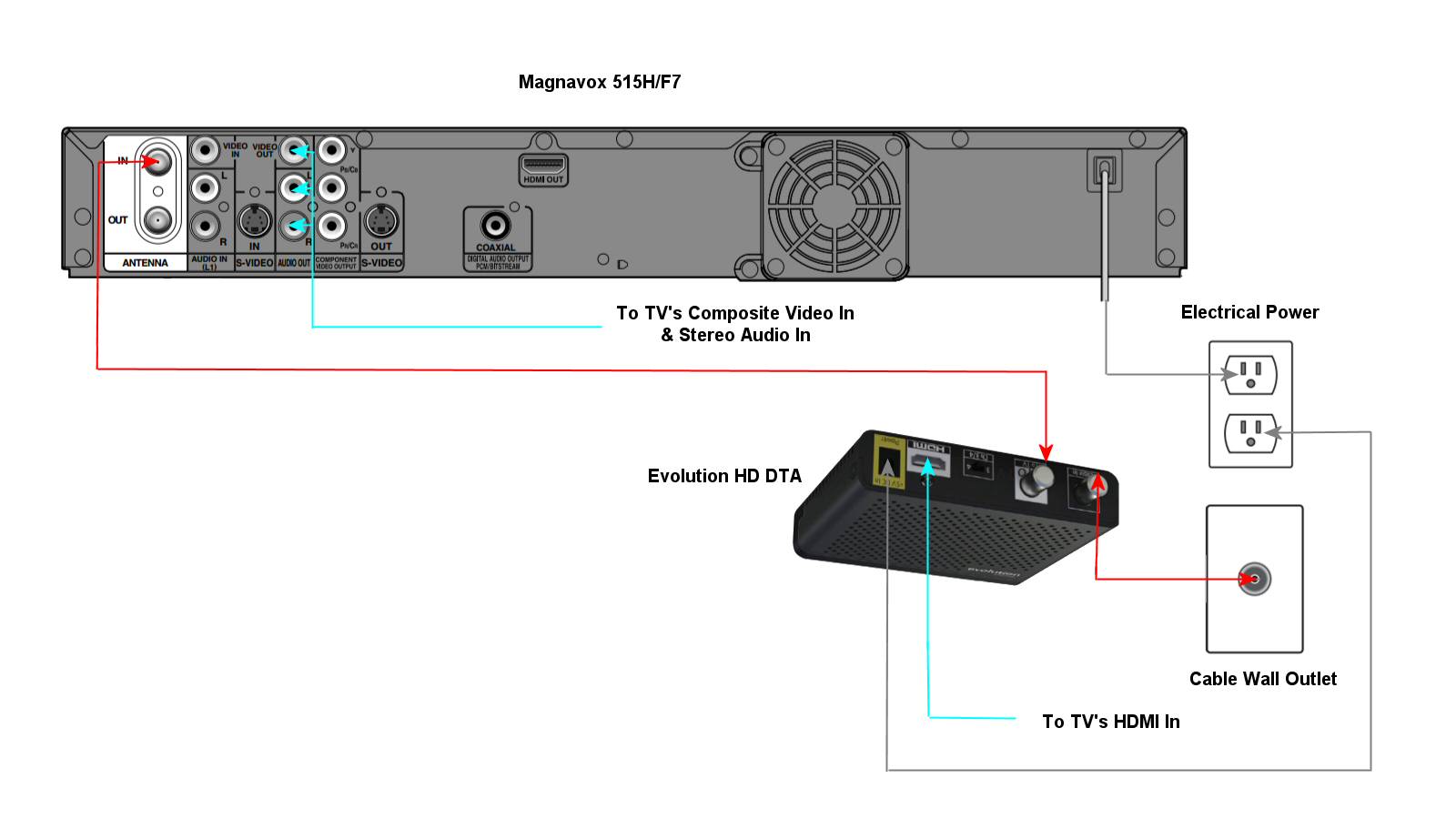

    One last try... Here is a diagram showing the connections. I suggest to Pmint that he does not connect the Evolution box to the TV using HDMI until after he verifies that the Composite video and Stereo audio connection from the Magnavox are able to display a picture to the TV and provide audio.

    Hi there, thanks a lot for thediagram. I have done this. I have also tried the other suggested connections. Appears the box and the magnavox do not recognize each other. All I get is still a blank screen and no audio. The magnavox menu screen display shows up on the TV using AV output but channel selections scan is useless. Goes through the process but channel 3 Never appears. Do you think another DVR is worth trying? I have a JVC. Or is it likely the cable company just doesn't want customers to use their own DVR?

    Analog channel 3 is not a DTV channel. It is an analog channel, a "TV" channel as far as the Magnavox goes. To switch the Magnavox from tuning DTV to tuning Analog TV (and vice versa), you have to press the TV/DTV button on the remote.
    If you cannot make it work, go ahead and try the JVC, as long as it has an analog tuner.
