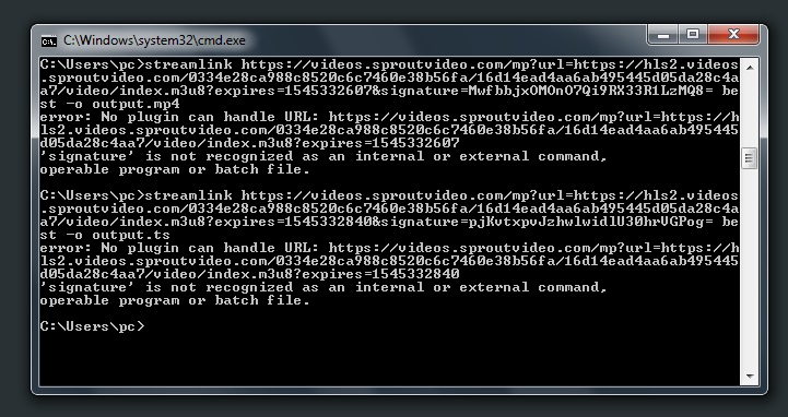

    I need to download this video
    https://videos.sproutvideo.com/embed/1c9addb2101deccb94/c47e1b02cd42383e
    I use streamlink but it does not work
    [Attachment 47536 - Click to enlarge]

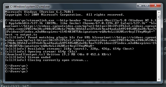

  15. Originally Posted by LZAA View Post
    Tube Digger.
    I can't buy the program Tube Digger
  16. Thank you but I want a way to download 66 videos
  17. Member Emeritus
    May 2014
    Originally Posted by mahmoud ragab View Post
    Your streamlink command line is incorrect.
    It doesn't include;
    the user agent header
    hlsvariant
    and the proper quotation marks. See the example streamlink command line that you quoted in your post but apparently didn't read.

  20. Originally Posted by ponens View Post
    It doesn't include;
    hlsvariant
    Thank you brother
    He's working
    [Attachment 47696 - Click to enlarge]
