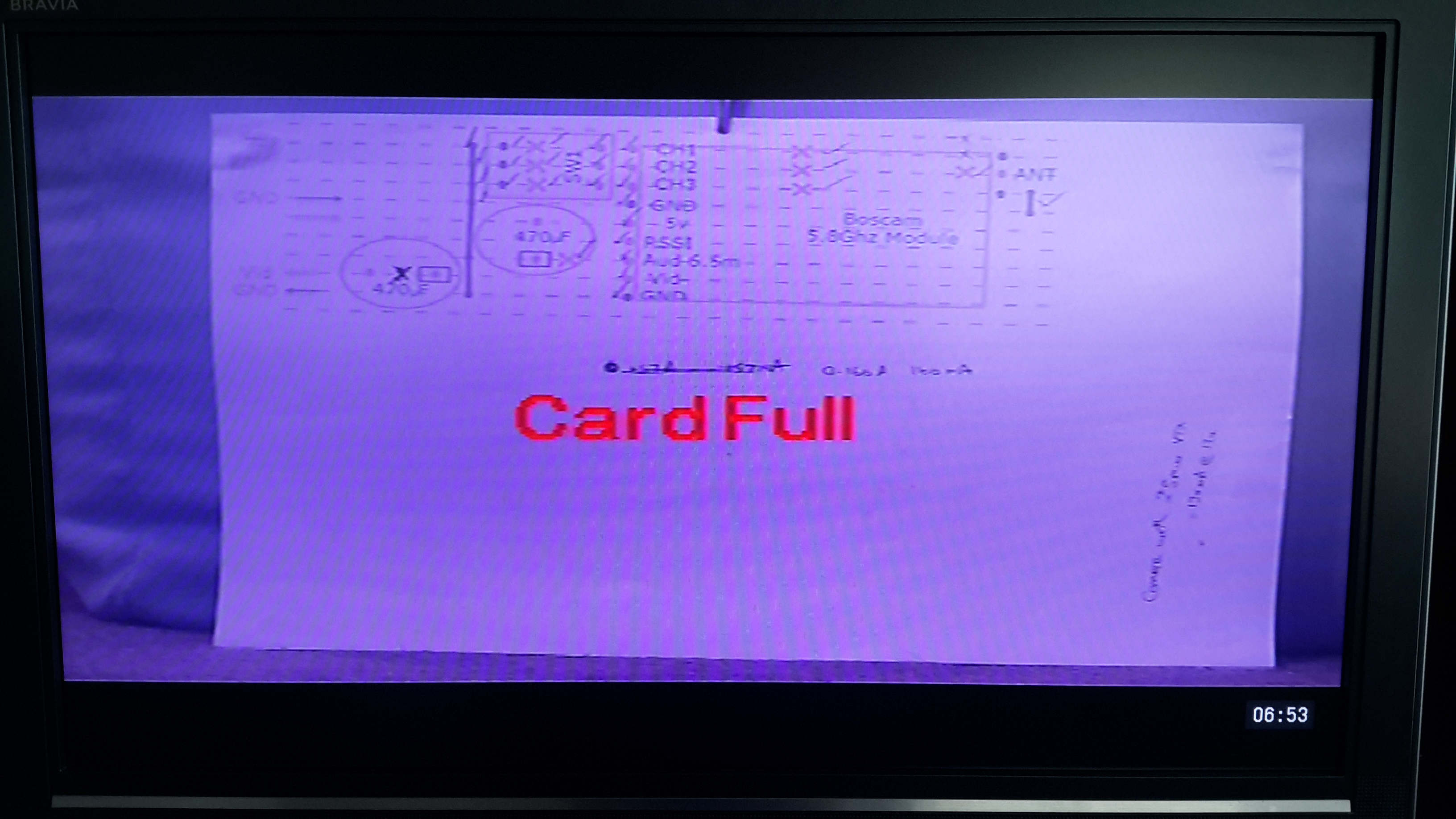

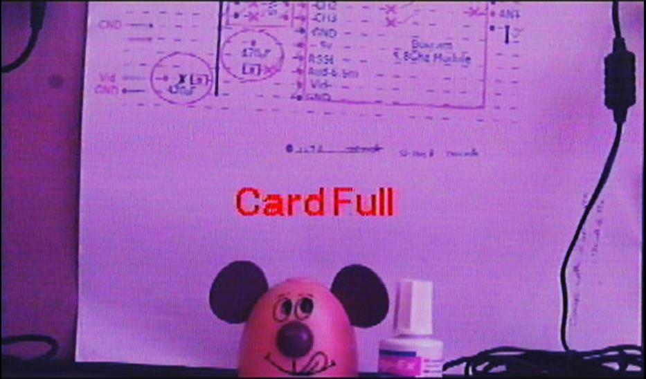

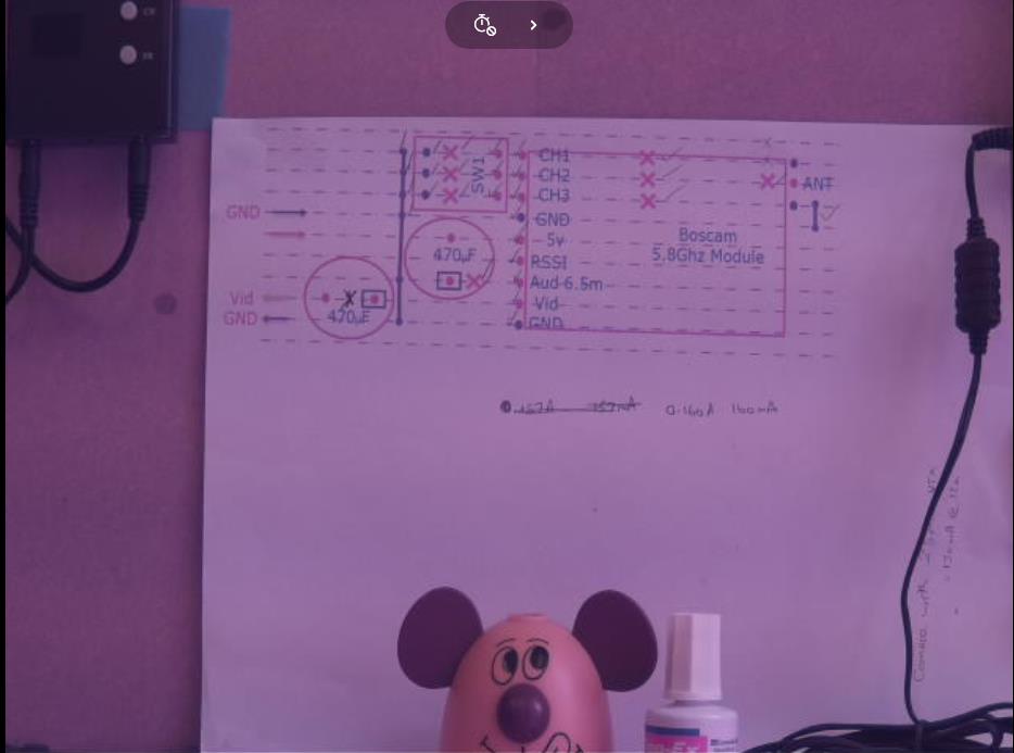

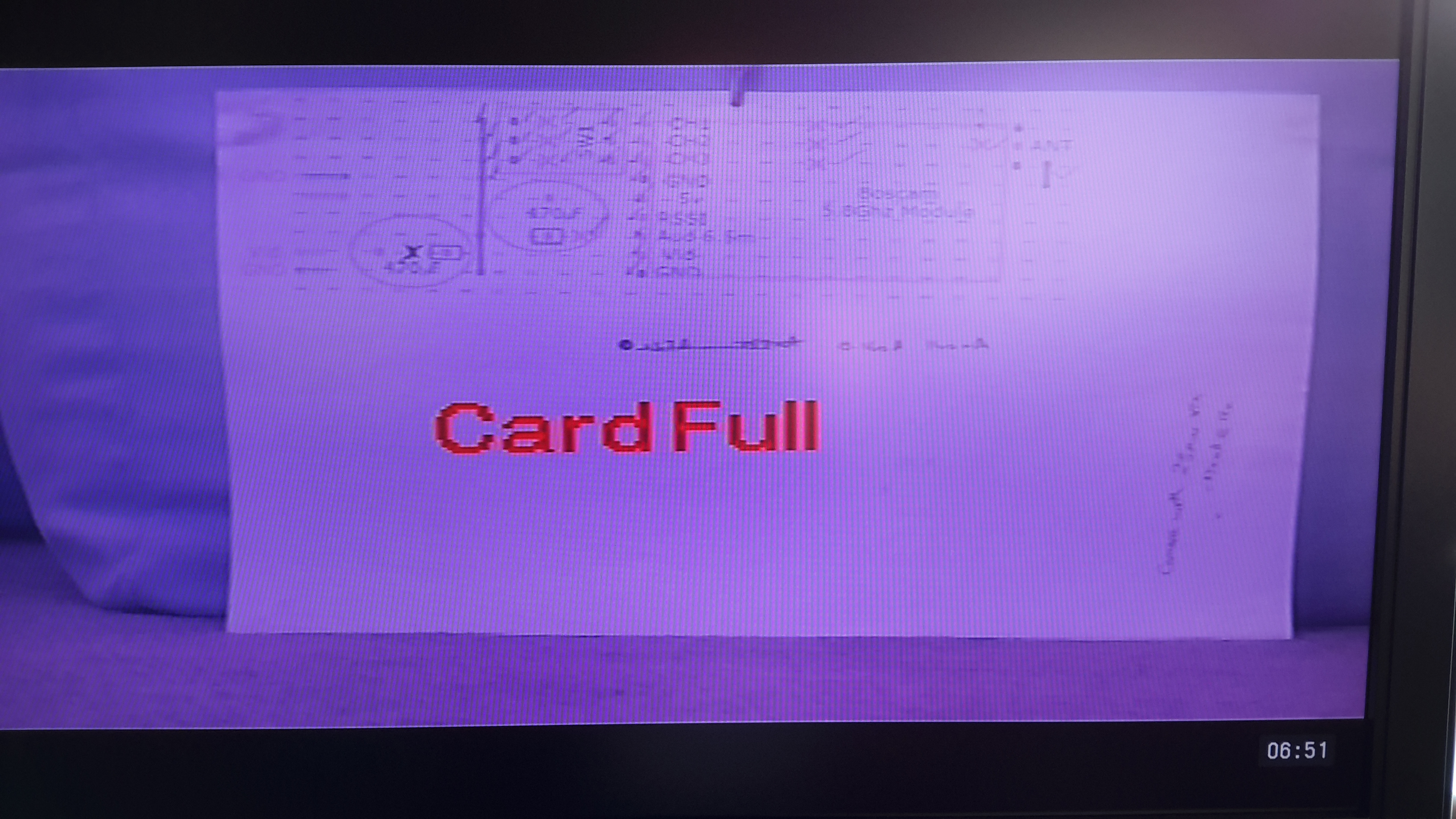

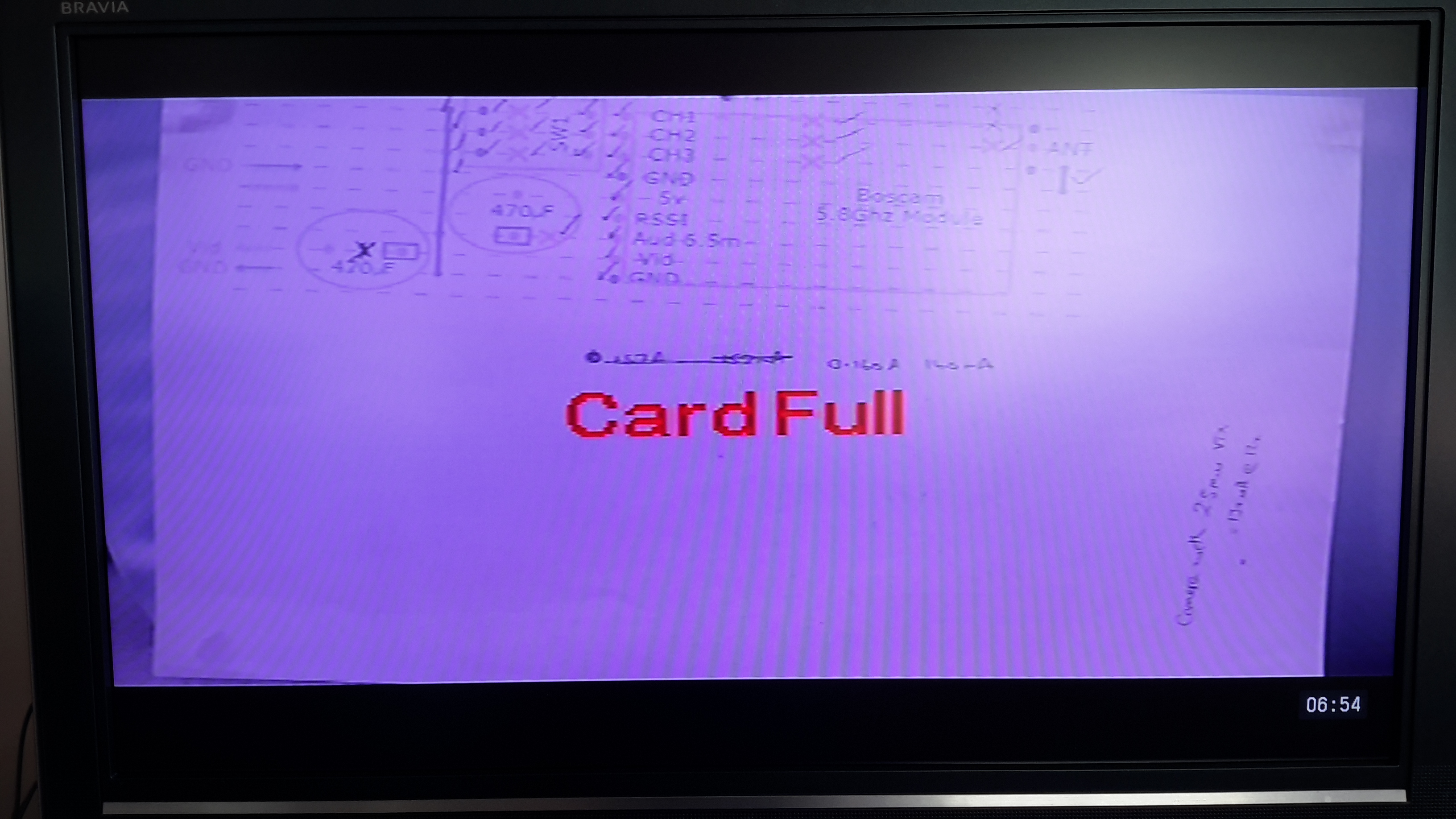

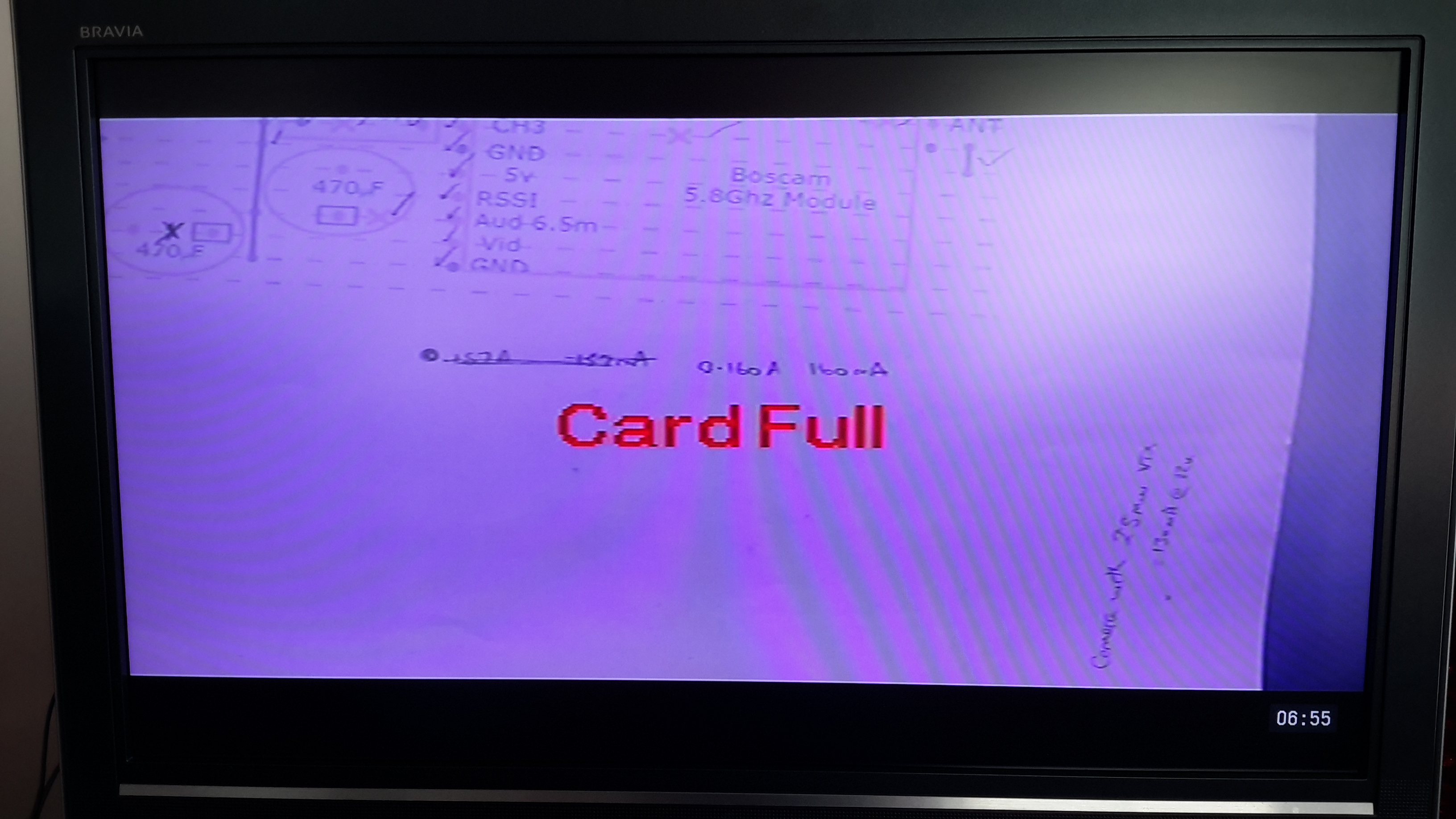

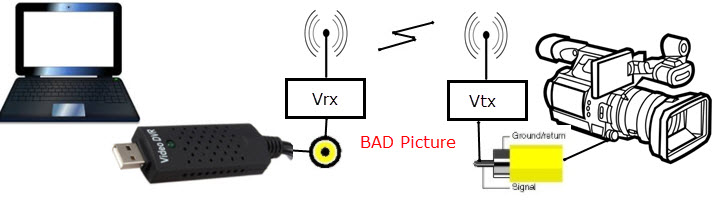

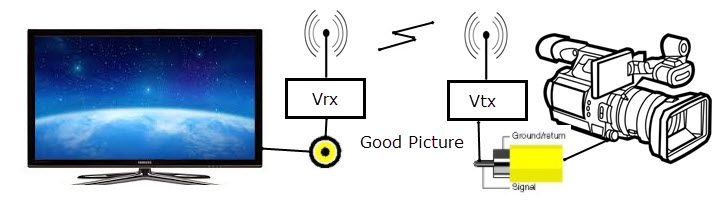

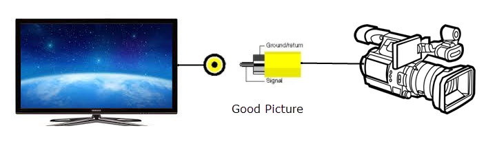

  3. Hi Thanks for the reply
    It would be worth pointing out that I'm new to this and maybe all Analogue to USB converters (how ever expensive) would suffer from the same issue. If thats true though, why is the picture so clear when I connect the Mobius camera using the built in USB out direct to the Laptop?
    I have attached some pictures, 1 example of what I am trying to do, 2 picture from the Mobius when connected to Laptop, 3 picture when using my cheap USB converter.
    Like i said above, all my tests point at the Converter being the cause of the picture degradation and not the Video transmission like I first thought it would be.
    Ultimately, I dont what to buy another converter if basically they are all the same

  4. Formerly 'vaporeon800' Brad's Avatar
    Apr 2001
    Vancouver, Canada
    The direct USB connection isn't limited to any analog video standard.
    I think it's still doable with your current hardware, depending upon:
    1. Can the camera remain stationary while you want to read the text?

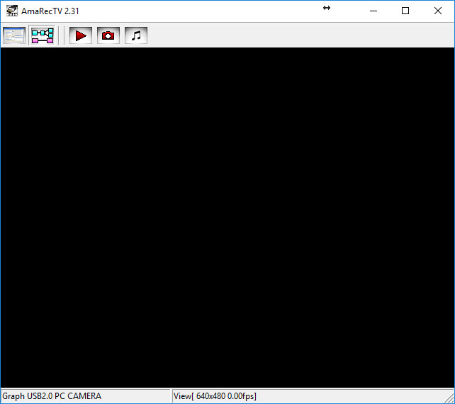

    2. Can you use alternative software to view the composite-to-USB feed? i.e. AmaRecTV

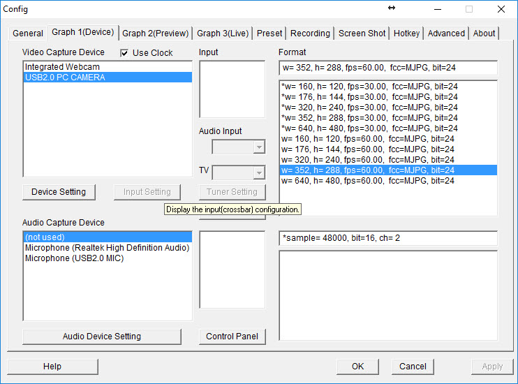

  5. Stationary, not sure it will be perfect, I still have to test that. Imagine a camera on a fork truck, I imagine a slight wobble. The camera will be used to visually check stock in a high up position to ensure an auditor can remain in the ground and in a safe position from the working zone. The goal is to limit the number of pallets required to be retrieved from storage to be visually inspected.
    Alternative software, I used Win10 Camera app on both tests and noticed excellent results from the Camera with built in USB function so I eliminated the software and drivers since in both tests the driver used was the same. I have just downloaded the AmaRecTV app but I dont seem to get a picture. the connection seems OK but get 0 fps. I can get audio. It also does not work with my built in webcam on the laptop so maybe I am doing something wrong? I did install the codec.
    I tried all the resolutions show in the picture, I seem to get an error "Aspect none. Underscan" on some resolutions, other give me "Aspect Fix Windowif that means anything.
    EDIT: I'll point out that I checked the camera was sending a signal using the Win10 app

  6. I gather FPV (First Person View) drone cameras with analog radio links (which I think is what you are talking about) intentionally sacrifice quality for low latency, needed to allow you to fly through obstacles etc.
    If you need super high quality you should set up a second digital-only radio link that bypasses all that horrible conversion -- or else drop the analog link and switch to digital-only, accepting higher latency.
    Getting a better composite->USB converter will help, but it will never be as good as an all-digital link.
    To sum up, as I understand it:
    Camera -> USB -> Laptop
        "Perfect Picture"
    Camera -> USB -> Converter #1 -> Composite -> TV
        "Perfect Picture" (added interlace artifacts & chroma bleed etc)
    Camera -> USB -> Converter #1 -> Composite -> TX -> 5.8Ghz -> RX -> Composite -> TV
        "Near Perfect Picture" (added noise, interference, ghosts, fading)
    Camera -> USB -> Converter #1 -> Composite -> TX -> 5.8Ghz -> RX -> Composite -> "Cheap" Converter #2 -> USB
        "picture is shocking, blocks not text!" (no kidding)
    Camera -> USB -> TX -> 4G telcom -> RX -> USB (hypothetical second radio link)
        Probably Perfect Picture with slight delay
    You don't need to install the codec, so feel free to uninstall it even if you do keep the app.
    Looking at your AmaRecTV results, I'm confused.
    1. It appears to spit out only compressed MJPEG with no option for uncompressed. I was under the impression that all Easycaps only offer uncompressed. This will limit the quality of video capture, depending on the degree of compression imposed. The actual "Preview pin" you view in realtime may nevertheless be uncompressed, but maybe not.
    2. You've got 288 line rates but no accompanying 50Hz option, just 60/30. And a 480 option but no 576. Which did you select in the "basic Win10 Camera application"? (I'm not familiar with the app.)
    3. The listing you linked claims, "With USB 2.0 connection: the output resolution will be full-screen DVD video resolution up to 720x480 at 30 fps for NTSC and 720 x 576 at 25 fps for PAL." Which is wrong not just because of the lack of 576/25/50: the max you're getting horizontally is 640, not 720.
    Maybe try installing the driver linked from that page, though I would be wary of mucking things up further.

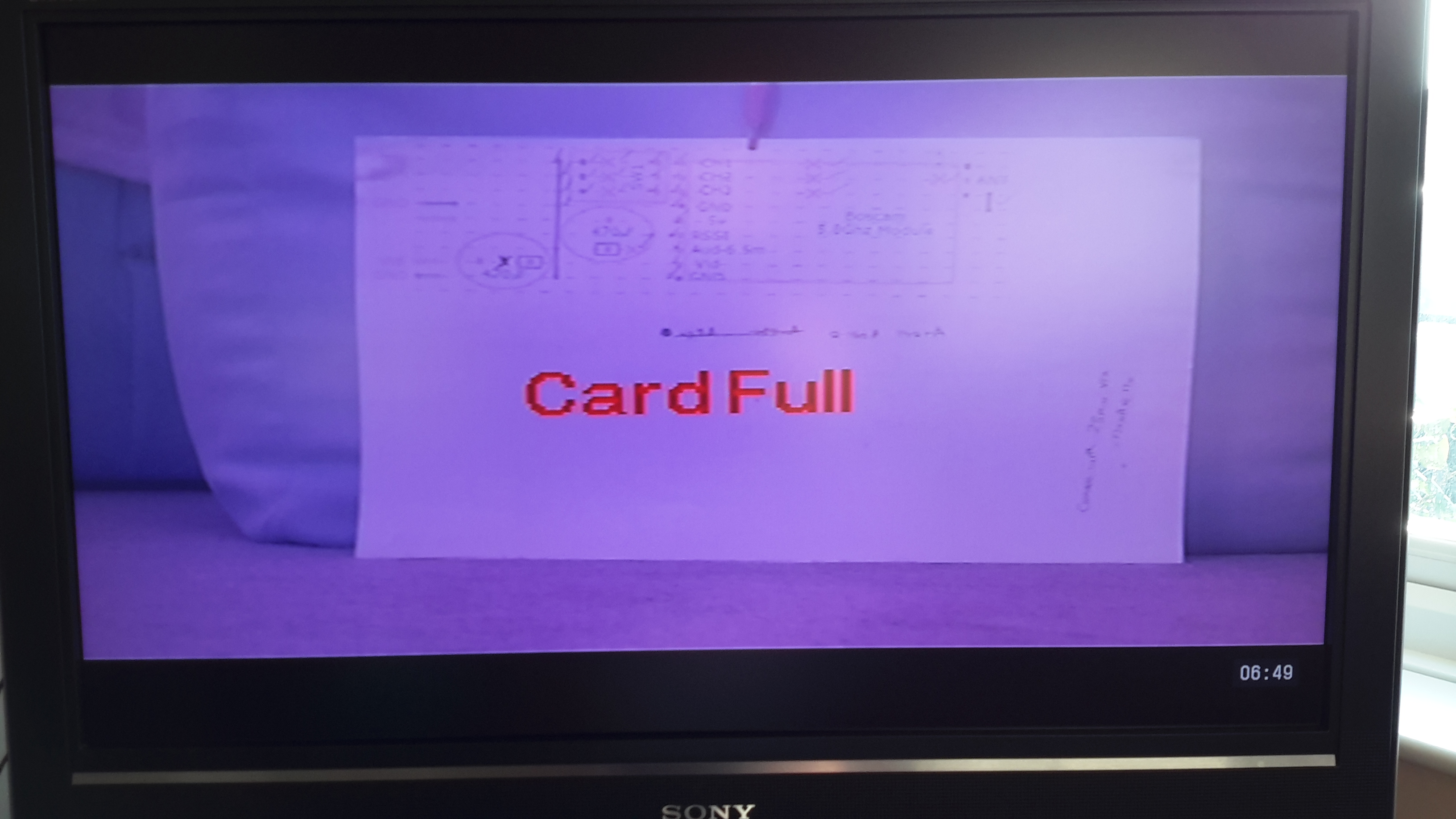

    I noticed that if I'm close enough to the text <600mm and zoomed in (x12) then the issue is not as noticeable. So I should check the TV again just in case since it could be what was said earlier about FPV (i.e. the camera entering an FPV resolution when I make it output the composite feed rather than the digital USB feed).
    If it is then I need to test a different type of camera, probably a standard camcorder over my 5.8 Ghz
    On a positive note, my 5.8 Ghz diversity circuit is getting much better

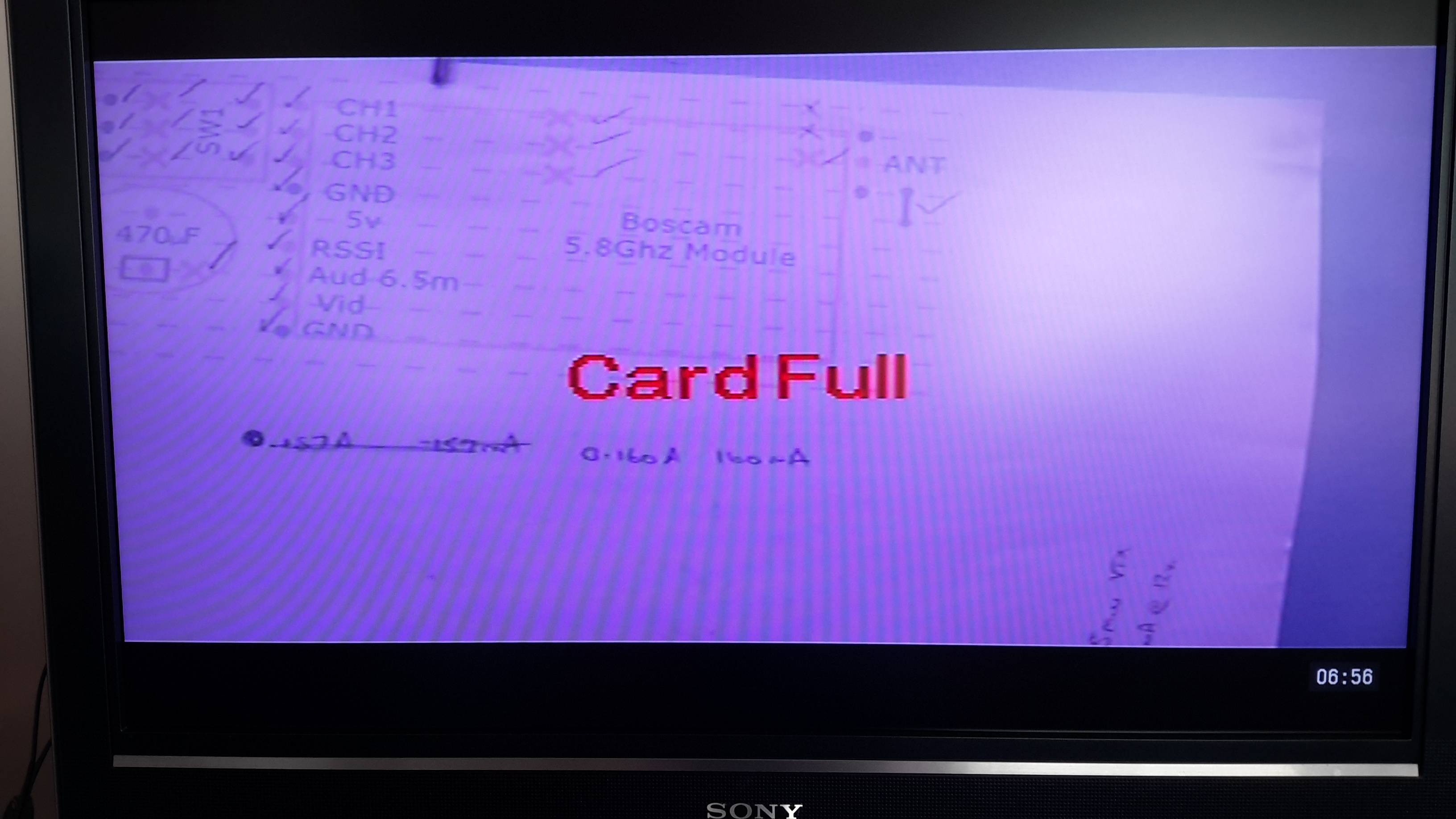

  17. Hi everyone,
    I just wanted to nip back and thank you guys for your help last weekend.
    I did retest the Camera AV out, through 5.8GHz video link, into the TV again and confirmed the picture was OK (basically I think proving the AV signal was clear enough into the cheap USB Converter, leaving just the Converter or the software / driver that must be introducing the poor quality). I've attached photo's of the screen (its the best I can do), the image name being the distance from the picture.
    @vaporeon800 I tried the VitrualDub, however it does not seem to make any difference. Its is worth pointing out that VirtualDub can only preview the picture at 2fps, where as Windows 10 Camera App has a little lag but nothing like VirtualDub.
    A couple of videos so you can see what is happening
    Win10 App Recording
    VirtualDub Recording
    I'm still working on the problem being something to do with the USB converter at the moment, however since I still have no suggestion that any other converter would do a better job I'm a bit stuck.

    My converter is based on the UTV630 Chipset
    Dutch page that provides a rundown of various Easycap chipsets and the guy's experiences with them.
    Originally Posted by Google Translate
    Easycaps with an XYUSB01 / 02 chipset Video:
    This is a kind of webcam chip that broadcasts a MJPG (Motion JPEG) stream with a resolution of 640 × 480 pixels and a variable frame rate up to 60 frames per second and default about 25 frames per second. Probably progressive scan, so your video is already directly interlaced at the input: the vertical resolution is halved, and then the remaining lines are duplicated randomly to restore the aspect ratio. As a result, diagonal lines may seem rough and the image is generally less sharp.
    Russian page that seems to indicate the UVC / "webcam" Easycaps are all equivalent.
    3. Easycap standard UVC
    - Single chip (Happens on chips XYUSB01, XYUSB02 and AMT-630 ... it is possible and still is ...)
    - VID & PID [18EC: 5850]
    > The software is used differently, both for webcams ... for example UsbWeb
    Seems to explain the issues you've had.
