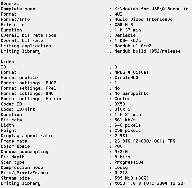

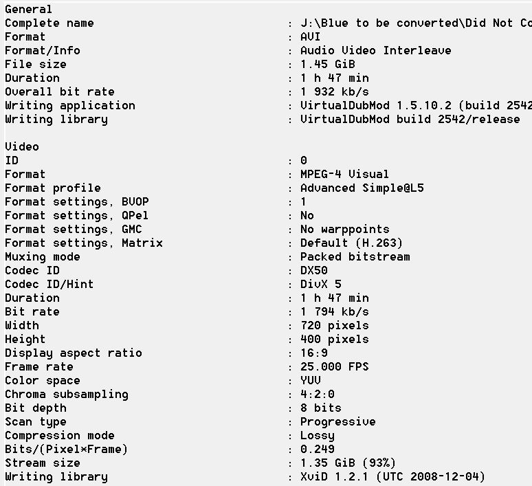

  7. I have read through some very informative answers, thank you all for your contributions.
    More info from this one forum than the 6 others i tried before.
    Taking the advice of using Mediainfo to compare the contents of the video section in each file.
    8 comparison files and i just don't see a significant difference or anything that stands out between them.
    Just wondering, could it be possible that any or all of the unplayable files are protected somehow.
    Is that something that would not show up in Mediainfo ?
    I don't know how to acquire information on the player itself as it is factory installed (assuming in Japan) when the car is assembled.
    Files that play
    Birdman
    Dredd
    Bunny
    Ted
    Files that do not play
    21Jump
    Arrival
    Contact
    District 9
    Quick view between two files.
  8. I didn't look too closely, but I didn't see anything consistent in the video properties. What about the audio?
