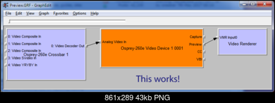

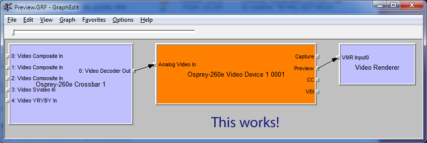

    EDIT: GraphEdit was easier to pick up than I thought. I created graphs for the Preview and Capture pins of my device and the test pattern appears! I can change the pattern properties and they update in the rendered view. So why am I getting a black screen in all my capture apps?

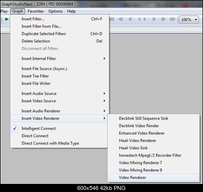

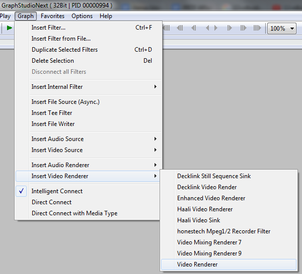

    One difference I can think of between GraphEdit and VirtualDub is that your graph is using one of the VMRs as the renderer while VirtualDub uses something else for its Overlay/Preview. AmaRecTV's options are "Auto/Overlay/Priority to EVR". I think Overlay is the one labelled Video Renderer in my screenshot.
    Do the other Renderer options in GraphEdit all work?
