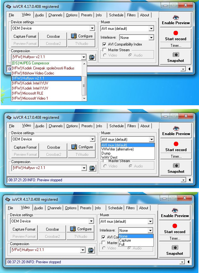

  12. Hi, so I decided to make a VHS record to my computer again. I just need to advise how I should set it up. Thanks for help.
    Compression
    Muxer
    Interleave
  13. Use the Capture Format button to select the color format. Set it to YUY2 or UYVY or some other YUV 4:2:2 variant.
    Your capture device has a very poor comb filter for separating the chroma subcarrier from the composite signal. This causes little dancing dots wherever there is color. Check to see if your capture device has a selectable comb filter (probably not). If you can capture s-video instead of composite (probably not) you might avoid the problem.
    You need a line time base corrector to reduce the horizontal wiggle on all the scan lines. This can't really be fixed in software. To do this you'll need an S-VHS deck with line TBC. Or you can pass the signal through an old DVD recorder with a line TBC before capturing.
    Your VCR is over-sharpening causing halos. If it has a sharpness filter you can control (most don't) turn it off/down. You can do better in software. If your capture device has a sharpness setting -- set it to neutral.
    Advanced filtering in AviSynth can alleviate (to some extent) some of these issues but you're better off not getting them in the first place.
