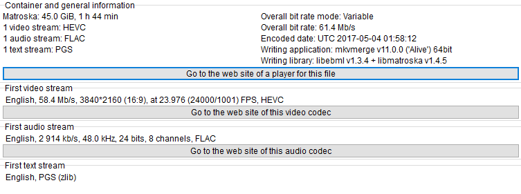

    Just so I know what to look for, the file I want to reencode is the video stream in this mkv. I currently have it extracted using mkvextract. Using -crf 18, what kind of data loss would I be looking at when reencoding from the source? Will the bitrate be drastically different or does that matter much when going from h265 to h264

  14. Most people consider crf 18 "transparent under normal viewing conditions", i.e. you wouldn't see a difference to the source when viewing the moving picture at normal viewing distance. Note that crf is just an attempt at constant quality but is not 100% absolute and the quality you want/need is subjective. You have to do your own tests. Consider crf 18 a starting point.
  15. Just used the command recommended, looks like I get a file half the size of what I had despite going away from h265. I understand that it's probably a placebo, but I am looking to retain all or as much as possible of the quality in the original file. Do you have a command I can run for that instead of just "transparent under normal viewing conditions"

    Thus: Try smaller values for CRF than 18, e.g. 15 or even 12.
