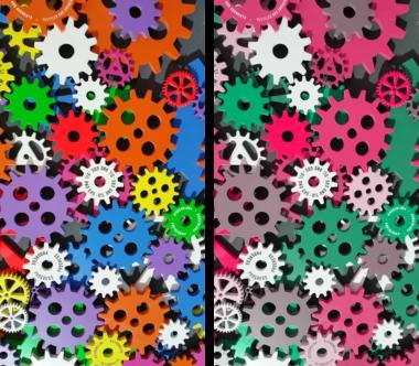

    That doesn't sound right. Loss of the chroma signal (of the s-video luma/chroma pair) would lead to a black and white (ie, greyscale) picture. Loss of the U channel of a YUV source would lead to a greyscale + red/green. But you couldn't get that with a bad s-video connection/cable. It would have to happen inside the TBC, after it separates the multiplexed chroma from the s-video input.
    Full color image on left, loss of U (of YUV) on right:
    [Attachment 41388 - Click to enlarge]
