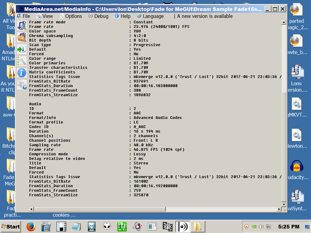

  17. I may have to post a screen shot of mediaInfo or its text version of my sample before continuing.
    So even though the drag and drop way works to Virtual Dub , it's not proper technique (?)
    The MediaInfo i can do yet today.
  18. Here is the MediaInfo text version of the clip I had selected. It may not even be a good
    item to practice on.
    It comes from when I arbitrarily selected 800x600 resolution.
    The audio is AAC which means before I did any audio processing with Goldwave.
  19. Originally Posted by loninappleton View Post
    Drag/drop usually works fine as an alternative to File -> Open Video File. The latter does let you select other options though.
    Since you're not supplying the information asked for there no point in continuing.
