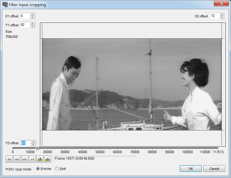

  8. Originally Posted by loninappleton View Post
    Virtual Dub gives me fits for a specific reason:
    it's slide controls are defined within such a narrow band that I get hand fatigue.
    Then use the little arrows by the crop values.
    [Attachment 41397 - Click to enlarge]

  26. Originally Posted by jagabo View Post
    I have quoted this image again. Little arrows, yes. But no path to get to this screen.
    I did install FadeFx into the filter folder location. I don't know how these little arrows or the
    dialog in FadeFX would work together. Or if a filter tool made in 2003 will work with anything.

    If you're not aware of the path to the cropping window in VD, choose 'Video> Filters> null transform' and then select
    the 'Cropping...' dialog box and the cropping window will appear. You can drag the video edges down or use the offset numbers.
    Most any filter selected will also make the cropping window appear if you do need special filtering.
    'null transform' doesn't filter, it's just the easy way to get to the cropping window without using one of the video filters.
    Cropping will require a re-encode, though.
