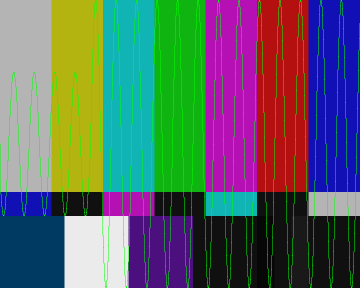

  2. A lot of THX certified DVDs include test patterns. I don't recall if there are any A/V sync tests. You could use AviSynth to generate ColorBars and overlay a graph of the audio.
    ColorBars(width=720, height=576)
    AssumeFPS(25)
    AudioGraph(0)
    Keep in mind that audio compression usually adds a delay of 10 to 30 milliseconds.

    So I could overlay the AudioGraph in the burned video, capture it, run AudioGraph on the capture, and visually see any offset, yeah? I suppose Subtract + DelayAudio could be used to determine the number of ms? Assuming levels can be matched relatively closely...

  4. Originally Posted by vaporeon800 View Post
    Yes.
    Yes. You can even use the horizontal position of the amplitude change to determine the delay. In my sample script the amplitude change happens at the start of a frame. Here' I added a 10 ms delay to the audio with DelayAudio(0.010):
    [Attachment 41370 - Click to enlarge]
    With a 25 fps video we know that the duration of each frame is 40 ms. You can see the audio change amplitude at about 1/4 the width of the frame, 40 * 1/4 = 10.
