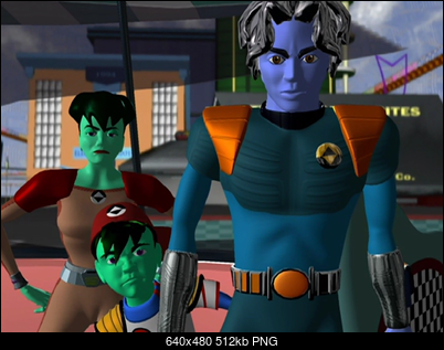

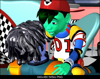

  1. I have a source that I cannot tell if it needs chroma sharpening or if it is benefiting it or not. I see things I both like and dislike happen when I apply mergechroma(awarpsharp2(depth=4)) to the video.
    Some colors like red seem to get darker and some colors like gold seem to stop bleeding when used. I like that it appears to be removing the slight color bleed on the right of things, but I don't like that in some places darkens things a bit or introduces a tad bit of bleed on the opposite side it removed it from. Things are a lot easier to notice when zoomed in using a paint program.
    Would you say the chroma sharpening is fine and is benefiting it, or something I should pass on?
    No Chroma Sharpen = Top
    Chroma Sharpened = Bottom

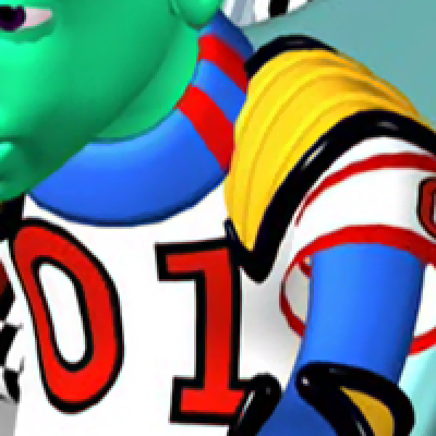

    original cropped, 2x zoom
    mergechroma(awarpsharp2(depth=4)) cropped, 2x zoom
    chromareconstructor, 2x zoom

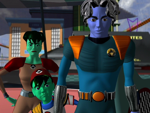

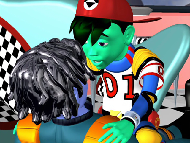

    I'm sorry to post on such an old thread, but I've been working on upscaling Reboot to 4K for a few months with a group on Discord. A couple others are the only ones left really pushing to finish this. And we're very close! But we're running into issues with the quality of all releases. We were able to purchase a copy of the Russian release thanks to some very helpful people. The image detail is leaps and bounds better than the US release, but the picture quality changes from episode to episode. Some have poor saturation, others have the wrong color range, while some are just completely wrong chroma/luma.
