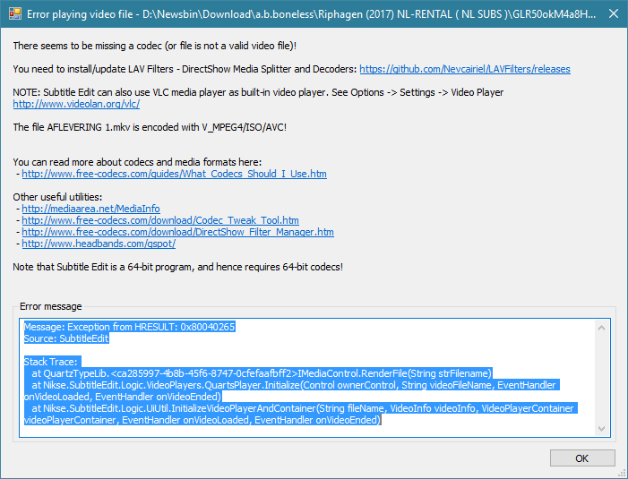

  3. I tried that and started out with an error...
    Windows 10 x64, VLC 2.2.4 Weatherfox

    Have no idea what to do.
    Should be installing additional stuff .. but what?

  4. Open the .srt, not the .mkv. (If you open the .mkv Subtitle Edit needs LAVFilters or VLC to show the video. Well, like the error message says. Just gotta read...)
    If you have subtitles embed in an .mkv instead of in separate files you can use MKVToolNix to delay the subtitles. Drag&drop the .mkv file into MKVToolNix GUI, select the subtitle track and then set the "delay" field to e.g. "2500" (ms).

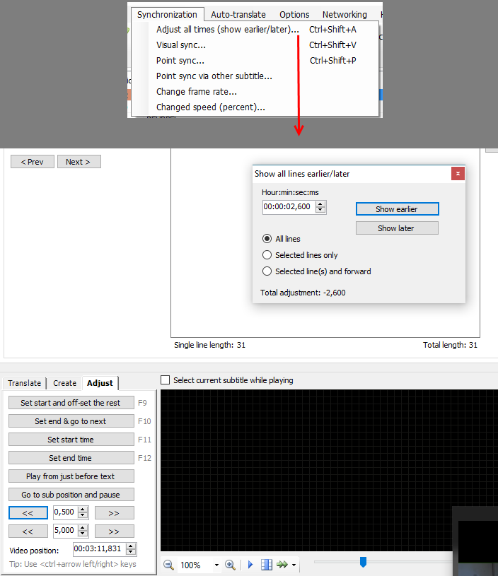

  5. Thanks again.
    Figured it out...
    Installed VLC player was 32b, so in Subtitle Edit, settings, I could not select the VLC player (option was greyed out)
    I installed VLC player x64 version.
    Now I got it working: this time, in settings, VLC could be selected and video was played back.
    Selected Synchronization-> Adjust all times-> 2,6 sec [Show earlier] button.
    Checked - it was fine, file save.
    No extra codec needed, just the x64 version of VLC.
    Things are perfect now!
    Many thanks again!

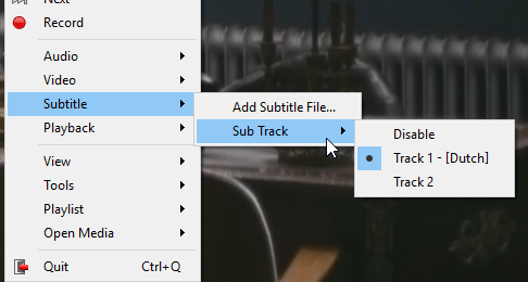

  6. Getting back on this. Maybe someone could help.
    This is the situation.
    So I have a .mkv and a .srt (Dutch)
    the video has a 'burned in/embedded' subtitle translating spoken German into Dutch
    on the remote control, when selecting subtitles, 2/two subtitles shown.
    I can either select the 'burned in/embedded' subtitle (spoken German->Dutch subtitle) or the Dutch subtitle, but obviously the German audio isn't translated.

  8. Used MKVToolNIX
    Regretfully the result will still be the same, either
    a. the audio Dutch-embedded Dutch subtitles are displayed only - the embedded audio German-Dutch subtitle is not displayed then
    or
    b. the audio Dutch-embedded Dutch subtitle are not displayed - the German audio-embedded Dutch subtitle is displayed
    I can still select from 2 subtitles within VLC - so when playing I should constantly switch between subtitles.

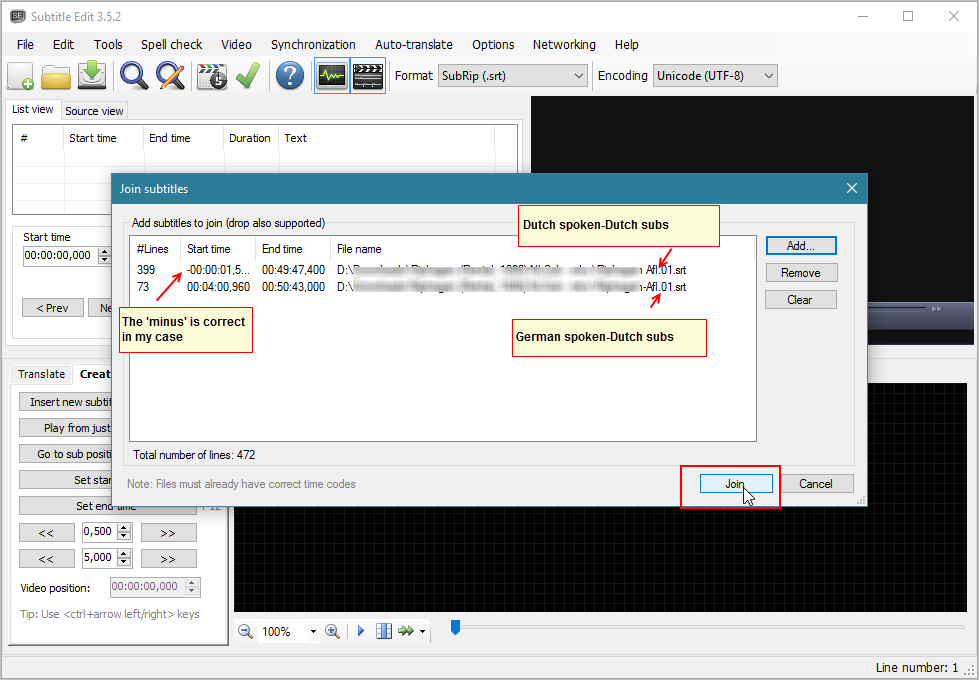

  15. Originally Posted by netmask56 View Post
    sneaker - will this method insert the German - Dutch subs at the correct timecode of the new sub file? I'm assuming the Dutch srt dialog starts close to the beginning of the film. I'm interested in doing this for a project of my own.... The way your post reads to me is the Dutch subs will start at the beginning and then at the end the German subs will start but of course the film has finished by then?
    I'm sure it means insert at the appropriate time code?
    @netmask56
    FWIW,
    please allow me to add below screenshot.
    sp: add the two subtitles, join, then Tools->Sort by->Start time (I am not sure this action is necessary, maybe not, but I did it)
    then save as a new .srt
    good luck!
