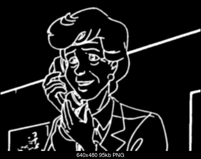

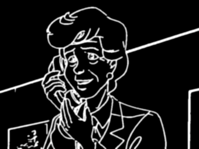

  9. e.g. using hysteria as a base function with some expanding and blurring to soften . The areas in 100% white will be the areas where you apply the filters to . All 100% black areas will be unfiltered. You would adjust it as you see fit, it's just a quick example
    hysteria(showmask=true)
    mt_expand(4, u=-128,v=-128)
    mt_binarize(150)
    binomialblur(3)

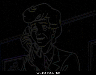

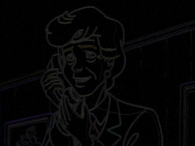

    Here is an amplified difference between your two screenshots of original and global blur. Notice the similarities ? Your "global" blur basically blurred the same areas anyways. My point is for this type of cartoon style, that approach won't make a huge difference. But you can play with masks, it's a good learning exercise, and learning about manipulating masks could be useful in the future for other projects

  10. I'm afraid I don't 100% understand how that mask is used.
    I do not want my video coming out all black and white. I realize that's just showing the mask, but when I remove them to get the colors and normal view back, the mask is no longer in the script?? It's not being used if it's removed.
    Was that not a mask and just a way to see what a mask would filter? Or was mt_expand(4) the mask?

  14. Originally Posted by killerteengohan View Post
    You asked help with generating the mask.
    You need to be able to "see" the mask in order to know how to adjust it. You might have to adjust the parameters for other sources or scenes. You might want to feather the mask more etc... or maybe you want bright lines only etc.... For masks, areas in 100% white will be 100% applied. 50% white will only be 50% applied . 0% white (100% black) will only show the original (ie. unfiltered)
    Apply the filter through the mask with overlay or mt_merge
    Another way to think of it is : what areas are "damaged" by your global blur that aren't located around lines ? Can you point that out ? Because in this type of cartoon art style, every boundary is demarcated by a line .
    Are you saying that using Blur(0.2) is damaging a lot of things and not just softening the video some?
    I'm saying it's already mostly targeting areas around dark lines. The black areas in amplified difference indicates no (or very little) difference in your screenshots . The areas that are affected are.... the dark lines. So you're not going to get much difference applying blur through a dark line mask vs. globally.
