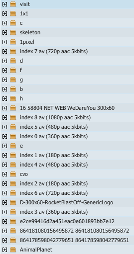

The M3U8 links are easy enough to find but contain the aforementioned variable frame size adverts inserted. That said, I have noticed that the occasional video (without adverts) is downloadable with JDownloader via an "index" file (see screen capture below). With JDownloader, the M3U8 files (labeled with letters) are "picked up" but there are also these other files that start with "index" followed by a number (higher number = higher quality). Are these "index" files HDS? Can someone explain how to find these "index" files via Developer Tools/Web Console?
Again, not all streams are available to download this way via JDownloader so I'd like to see if it's possible to identify/locate the same "index" files on other streams.

I have found my solution so I thought I’d update this thread for those searching in the future.
It seems some sites are wrapping their URLs in a uplynk “preplay” M3U8 that bundles/injects the adverts but, from what I have been able to gather, the akamaihd “master” M3U8 is discoverable via the page source. So, if you’re having this issue, look in the source (not just the Developer Tools/Web Console)!
As for the JDownloader “index” files: I can only guess that JDownloader must be parsing the akamaihd URL from the source on some pages and generating “index” files.
