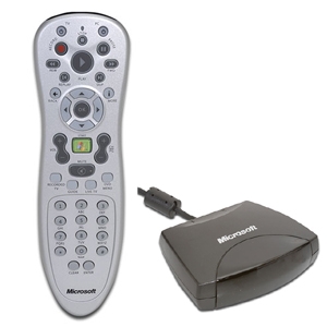

You petty much need this MCE Remote Kit
Only the HVR-2250/2255 has direct IR receiver/IR blaster function support with in MCE -
So you didn't change any settings on MCE but MCE just knows how to send IR command to RNG110 via MCE remote?
My MCE remote is this one: Microsoft Media Center Learning Remote Controller
This IR receiver comes with two output ports labeled "1" and "2".
Isn't this your MCE IR receiver? -

No it isn't. The model I bought is discontinued, but the USB receiver included with mine also has 2 IR blaster ports. All the kits with an RC6 MCE remote and MCE USB IR receiver/IR blaster work the same way even if the appearance varies.Last edited by usually_quiet; 28th May 2018 at 22:18.
