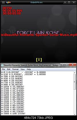

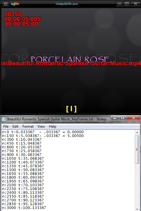

    Be sure of the exact time for the Keyframe ("I Frame"). I use Avisynth to display the video and display the Keyframe type at the bottom
    FFmpegSource2("C:\Users\Bud\Desktop\Beautiful Romantic Spanish Guitar Music.mp4", atrack=-1).Crop(0,0,-0,-0)
    ScriptClip(Last, """Subtitle("[ "+Chr(FFPICT_TYPE)+" ]", size=(Height*56.0/720), align=2)""", after_frame=true)
    Subtitle("C:\Users\Bud\Desktop\Various test Formats\Beautiful Romantic Spanish Guitar Music.mp4", x=480, y=200, font="Arial", size=24, text_color=$ff0000, align=3)
    ShowFrameNumber(scroll=true, x=10, y=27, font="Arial", size=24, text_color=$ff0000)
    ShowTime(x=72, y=44, font="Arial", size=24, text_color=$ff0000)
    ShowSMPTE(fps=29.97, x=68, y=61, font="Arial", size=24, text_color=$ff0000)
Name:	Key Frame.jpg

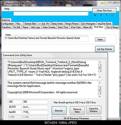

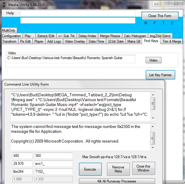

    Then verify this by retrieving a list with ffmpeg. FFmpeg sometimes adds a decimal to the times, consistant throughout and starting at Frame "0", so I just subtract as shown to verify with Player times.
    "C:\Users\Bud\Desktop\ffmpeg.exe" -i "C:\Users\Bud\Desktop\Various test Formats\Beautiful Romantic Spanish Guitar Music.mp4" -vf select="eq(pict_type\,PICT_TYPE_I)" -vsync 2 -f null NUL -loglevel debug 2>&1| for /f "tokens=4,8,9 delims=. " %d in ('findstr "pict_type:I"') do echo %d %e.%f>>"C:\Users\Bud\Desktop\Beautiful Romantic Spanish Guitar Music_KeyFrames.txt"

    So far I haven't had any problems cutting this way or joining with black or distortions between joins
