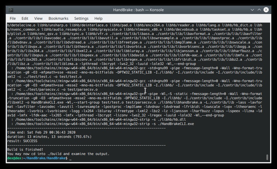

  26. Member
    Mar 2018
    Brazil
    yup, installing the additional dependencies listed at the site https://handbrake.fr/docs/en/1.3.0/developer/build-windows.html solved the errors
    what I did was I ran this: sudo apt-get install automake autoconf autopoint build-essential cmake gcc git intltool libtool libtool-bin m4 make nasm ninja-build patch pkg-config python tar zlib1g-dev (I noticed 1 or 2 actually were installed, the rest was ok)
    than this: sudo apt-get install meson (because I'm using latest 19.10)
    and than: sudo apt-get install bison bzip2 curl flex g++ gzip pax (I actually ran this one just for the sake of it even though mingw toolchain was already compiled successfully; apparently it was needed to correctly compile the mingw toolchain)
    after doing these 3 the final build ran; no errors interrupting
  27. Member
    Jul 2018
    Serbia
    @AntW93 thx for guide v3
    On Kubuntu 19.10
    [Attachment 52187 - Click to enlarge]
    Vidcoder with fdk aac
