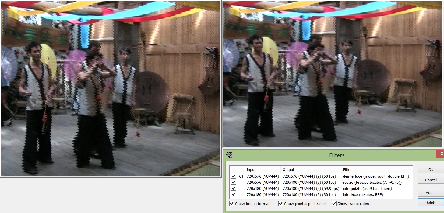

    Here is a PAL DV example in vdub. For your case, you have to set the field order correct (TFF VS. BFF, and you have interpolate options ie. blending vs. duplicates when resampling the 50FPS to 59.94FPS)

    Thanks poisondeathray
    That's exactly what I was looking for. Every steps is working fine.
