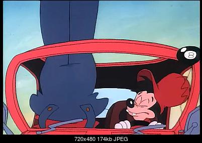

    Here's the result: (mkv). The video looks way better on vlc media player, but on my hd tv it's too clear and unnatural. I'd like to make it more smooth or something, but it takes forever to convert. Since I have around 200 episodes to convert, I'd like to find a faster way, with good results.
    If there is someone with great skills on anime, any advices would be much apreciate. By the way, a have no idea of what I am doing, basically I'm doing some screenshot comparaison to guide my self.
    One other thing I'have notice something that I don't know if it could be fix, the lines are not straight, is it AA ?, can it be fix to straight or better results ?
Name:	Test B3.3c.mkv14.681.jpg
    Thank you for your time. I don't know if I'm posting to the right place, if not let me know or if you know any other sites where I could ask, that would be helpful.

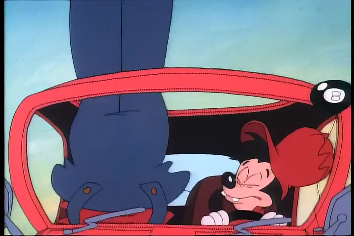

  2. That last MSharpen() is way overdoing it. I played around with some dot crawl removal and got something that I think works a little better. Try this:
    Mpeg2Source("Dingo ext.1.d2v", CPU2="xxxxxx", Info=3)
    Crop(10,0,-6,-0)
    BilinearResize(512,height) # some halo reduction, noise reduction, faster processing
    ColorYUV(off_y=-3, off_u=-1) # minor brightness, color adjustments
    #reduce dot crawl artifacts
    SeparateFields()
    evn = SelectEven().Dup(threshold=8.0, maxcopies=1, blend=true, show=false)
    odd = SelectOdd().Dup(threshold=8.0, maxcopies=1, blend=true, show=false)
    Interleave(evn,odd)
    Weave()
    TFM(cthresh=4, slow=2)
    TDecimate(mode=1)
    dehalo_alpha(rx=1.5, ry=1.0, brightstr=1.5)
    McTemporalDenoise(settings="medium")
    aWarpSharp2(thresh=128, blur=2, type=0, depth=16, chroma=4)
    #MSharpen(threshold=10, strength=25, mask=false, highq=true)
    Hysteria() # fine tune this
    nnedi3_rpow2(2, cshift="Spline36Resize", fwidth=720, fheight=height)
    MergeChroma(last, aWarpSharp(depth=10))
    The fairly high Dup() threshold might cause some frames with only very small motions (like when a character far in the background is speaking and only his lips are moving) to lose those motions. You can reduce the threshold to lower the likelihood of that but you'll get less effective dot crawl removal.
  3. Wow thank you. The result is great and those lines look much better. How did you do to make those lines thicker ? Was it hysteria ?, cause I tried many linedarken and did not get that result. Other than that the result is very much what I was looking for, except for a little thing.... I feel sometime that the video is not fluid, kind of slow motions. On what should I play to improve this ? is it what you describe with the Dup() threshol ?

  4. Originally Posted by Altruo View Post
    Yes, Hysteria() is the line thickener/darkener. You can probably get better results playing with the parameters.
