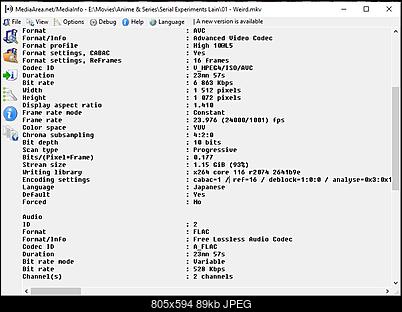

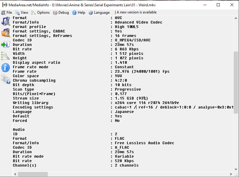

  4. Well... shit. Apparently I'll have to re-encode. If i just put the exact same bitrate of the original video:
    On Handbrake or whatever, select 2-Pass Encoding and Very Slow preset, will I lose any of the quality?

  5. Technically yes. If you'll see it is a different question. 6800 kbps is relatively decent so maybe you won't notice.
