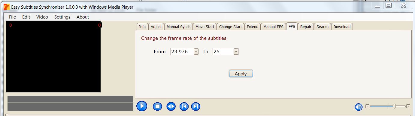

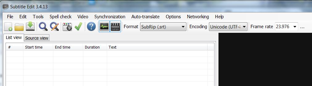

  10. I would also recommend Subtitle Edit. It has many sync options and can do stretching by percentage as well.
  11. Member netmask56's Avatar
    Sep 2005
    Sydney, Australia
    3 screenshots of subtitle editing programs.
