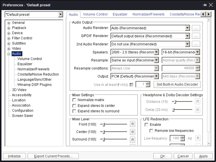

  14. You might have to use a 32 bit Potplayer with the plugins (assuming Potplayer has a 64 bit version). I'm pretty sure RockSteady is only a 16 bit plugin as it's pretty old. Other than that, I can't help much because I just load them and they work.
    You'd probably want to have Potplayer set to downmix to stereo if you're using RockSteady (pic 1).

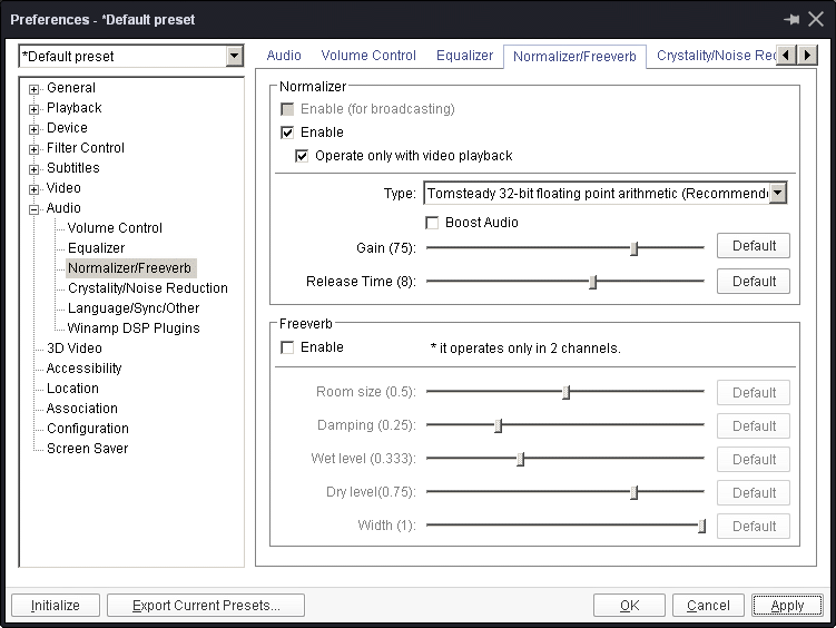

    If you use RockSteady, disable the built in normaliser (pic 2).

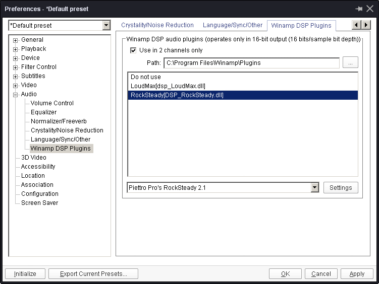

    RockSteady loads fine for me (pic 3).
