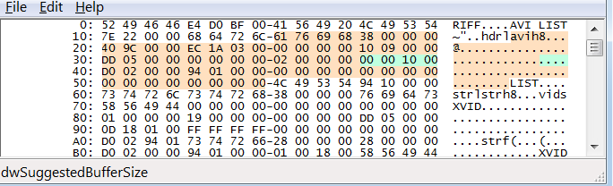

 Looking with Elecard Video Format Analyzer I see differences in dwQuality and dwSuggestedBufferSie (some RIFF variables...) and with Audio Sampling Rate:

 You can try changing the dwQuality and dwSuggestedBufferSize variables with a hex editor. VirtualDub's Hex editor shows you where they are when you click on them.
 [Attachment 41153 - Click to enlarge]
