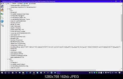

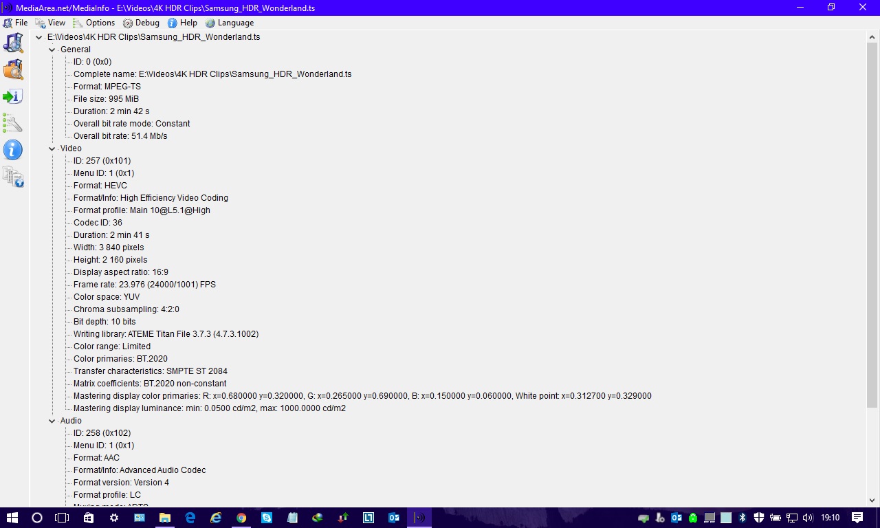

    I have uploaded two screenshots from MediaInfo.
    Video Codec.jpg is from a 4K video for which I do not know whether it has HDR or not. What I understand from what you said is that this video is not HDR. Is this correct?
    And Video Codec 2.jpg is from a 4K video I know has HDR. So does the fact that it has the HEVC codec confirm that it is HDR? Or is the HEVC codec also used for other video files which dont have HDR?

  4. Originally Posted by everway9 View Post
    If a files shows it to have the HEVC or AVC codec does that mean that the video definitely has HDR?
    No.
    Usually it is encoded in 10 or even 12 bit depth. And it uses BT.2020 colorspace, SMPTE ST 2084 transfer. You should see the values for min and max luminance. Max luminance for HDR is somewhere in the 1,000 to 10,000 nits (cd/m2) range. Currently mostly 1,000. SDR only 100.
    The above is usually called "HDR10" or "PQ". There are additional standards incl. HLG and Dolby Vision. I haven't seen those yet.
    Yes.
    It's HDR but HEVC is also used for non-HDR-videos.
    P.S.: For MediaInfo I recommend "View">"Text". Then you can also copy&paste.
