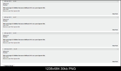

  9. aBigMeanie aedipuss's Avatar
    Oct 2005
    666th portal
    wow has all of vh given this poster up for dead as i have?Click image for larger version
    not sure i've ever seen one so shunned...
  10. Capturing Memories dellsam34's Avatar
    Jan 2016
    wow has all of vh given this poster up for dead as i have?Image
    [Attachment 41364 - Click to enlarge]
    No, the most knowledgeable members that actually benefit the forum don't have such attitude of ignoring other members, Single digit IQ ones don't count.
