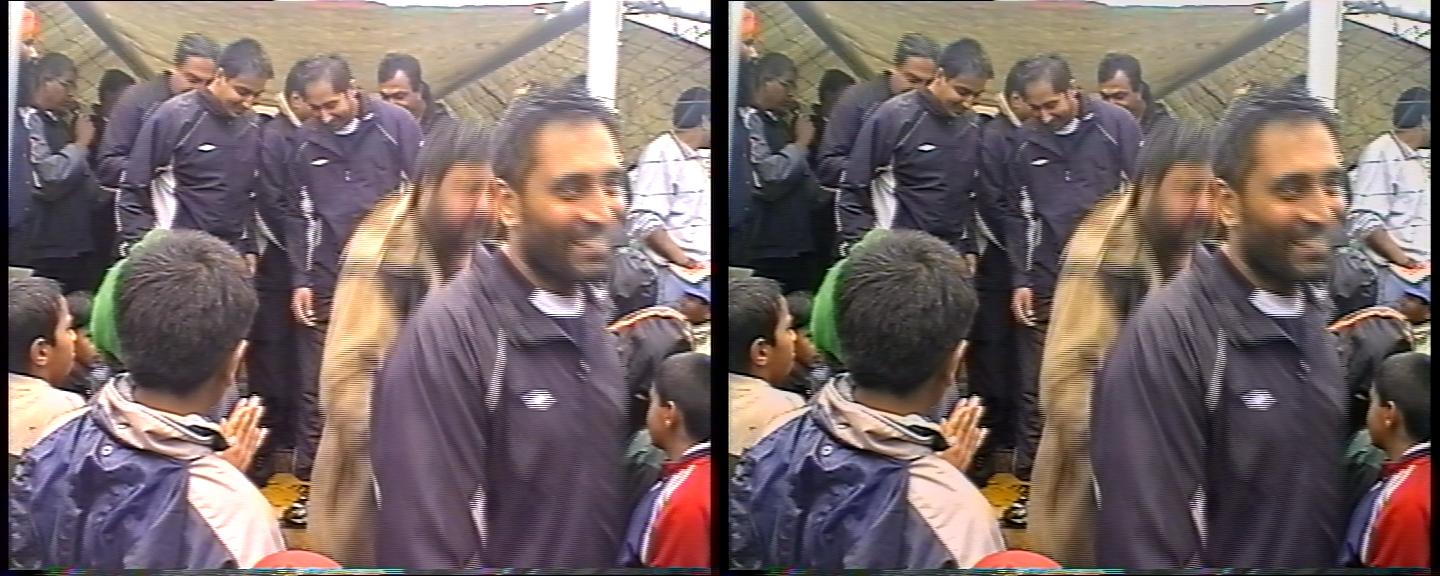

  2. Maybe something like:
    ColorYUV(gain_y=-20, off_y=-12, off_u=-1, off_v=-3, cont_u=-20, cont_v=-20)
    before/after:
    [Attachment 41124 - Click to enlarge]

    Part of the problem is lens flare, part of it is capturing at illegal video levels that leaves brights and upper midtones foggy. Jagabo's corrections should work pretty well for the sample posted. Skin tones still don't have enough blue, but that can be fixed in VirtualDub with something like ColorMill.

    This can be processed in dozens of ways. I used jagabo's color routine in the script below. You didn't answer the question about retaining alternate fields, so I kept SelectEven() in the script.

    Correct color balance is very subjective. This video is shot in heavy overcast light. It won't have the same bright colors as sunlight.

    Usually if things look too yellow add blue, not red. Yellow already has red in it.
