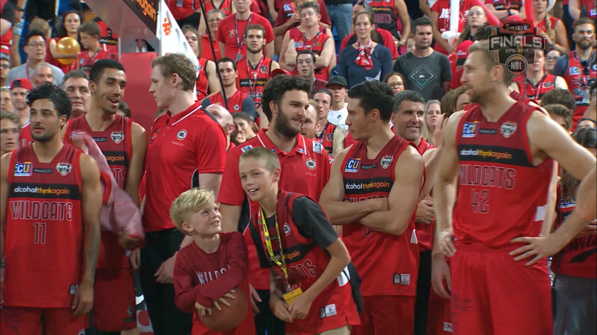

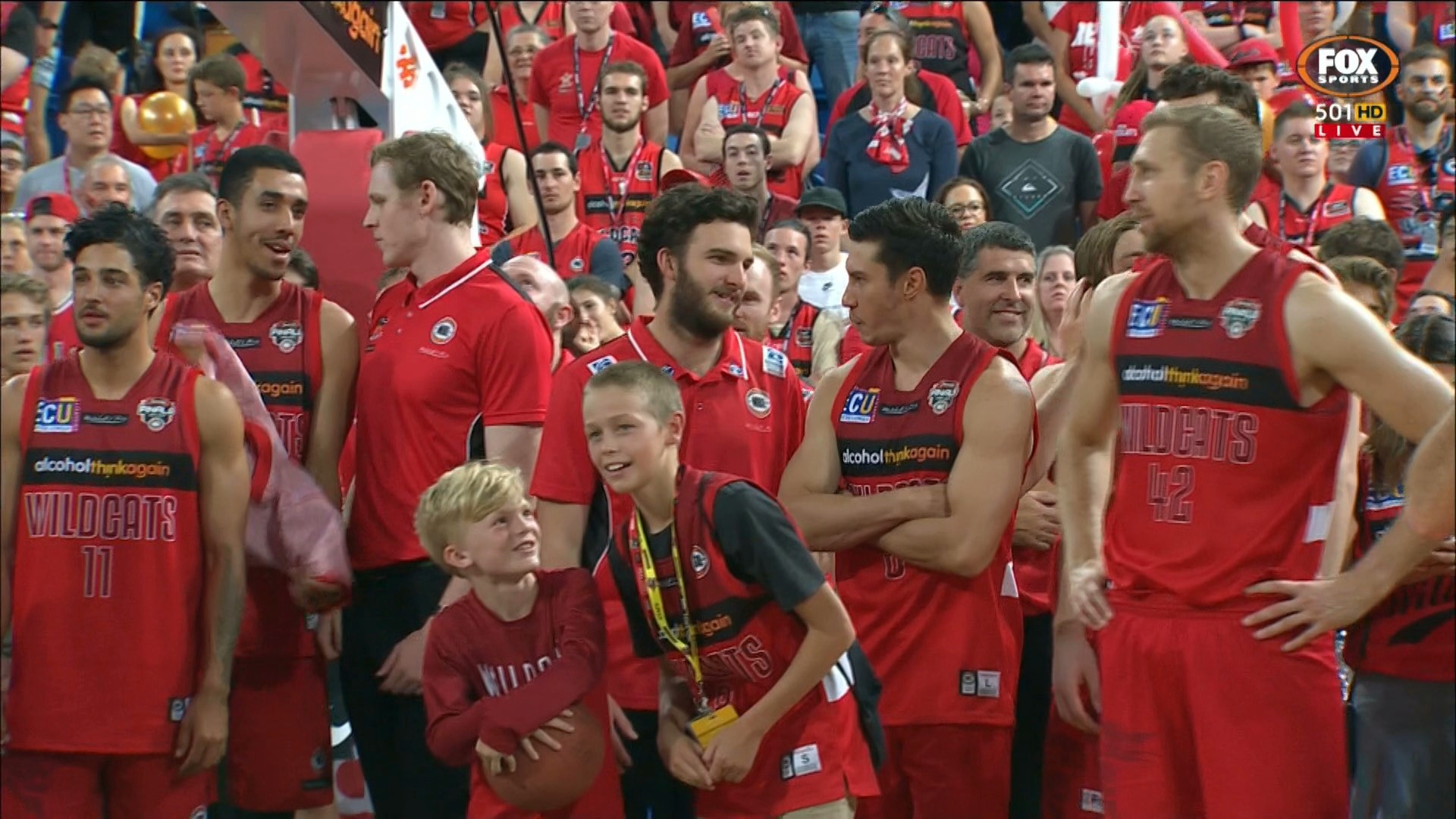

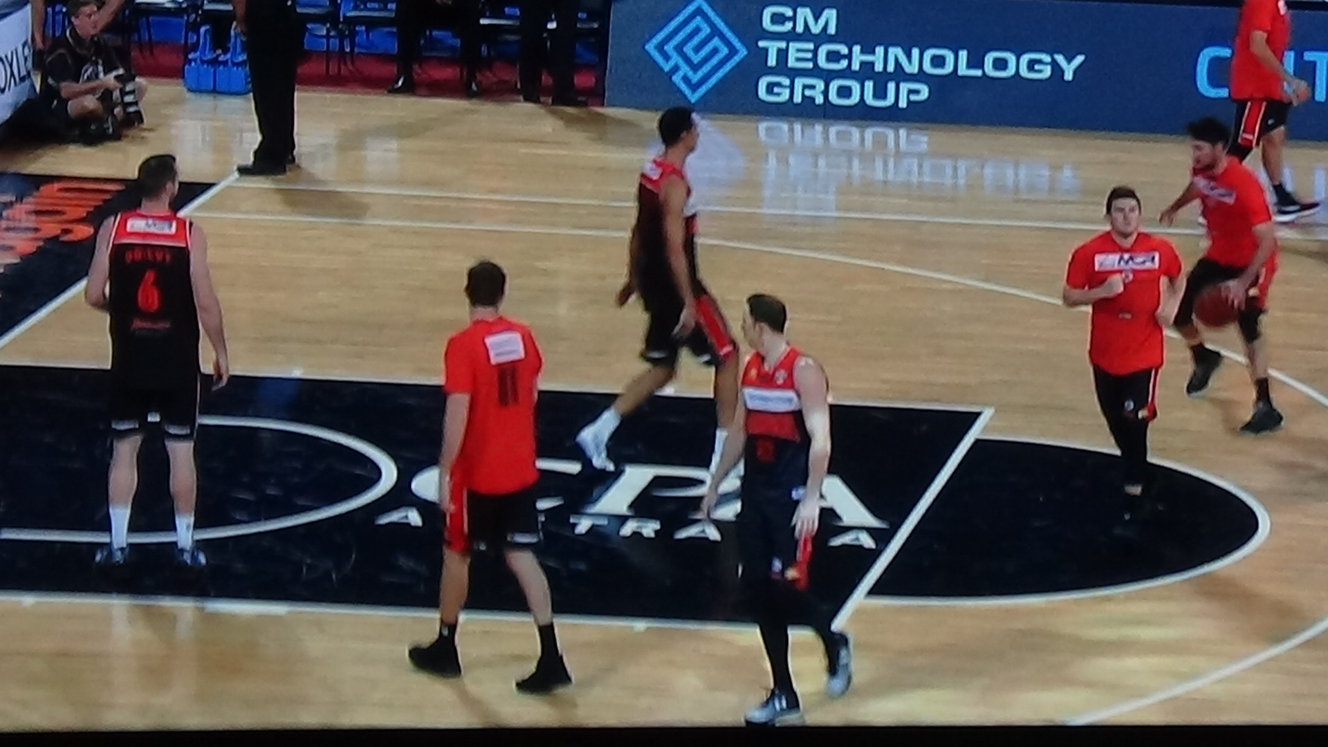

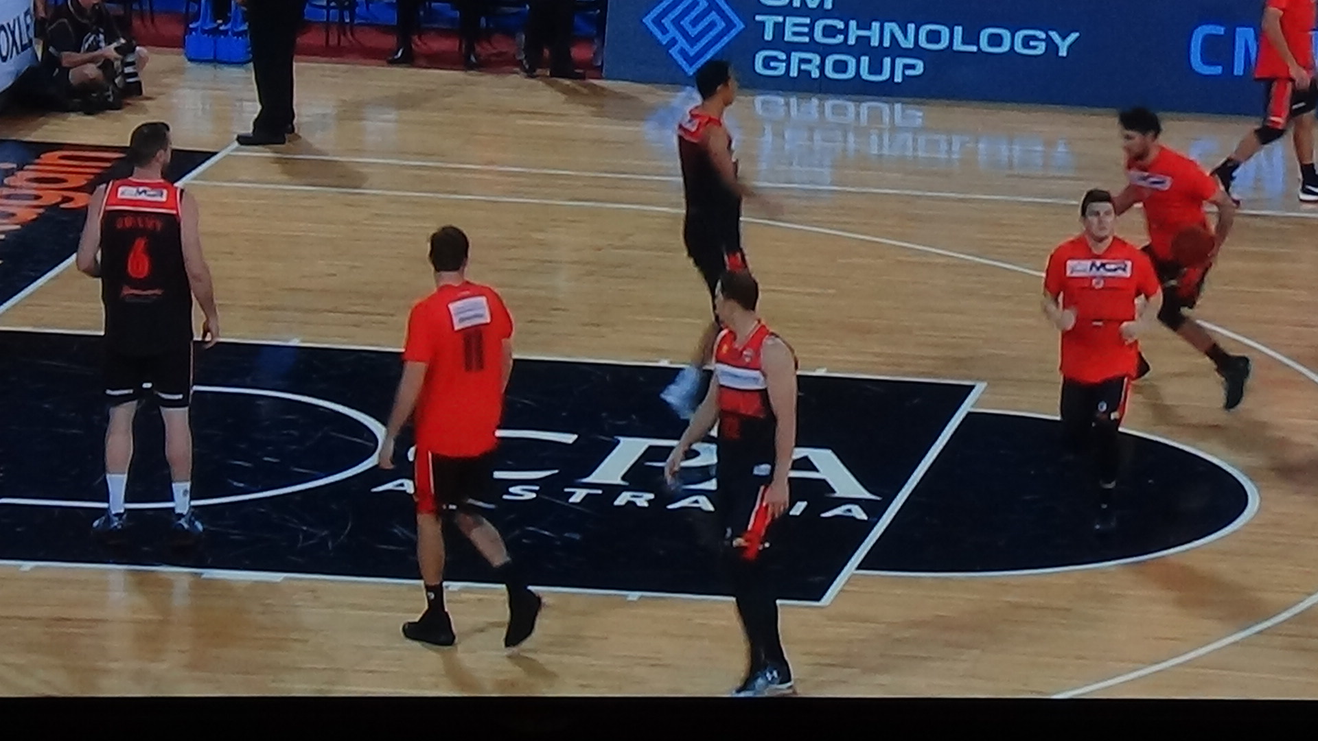

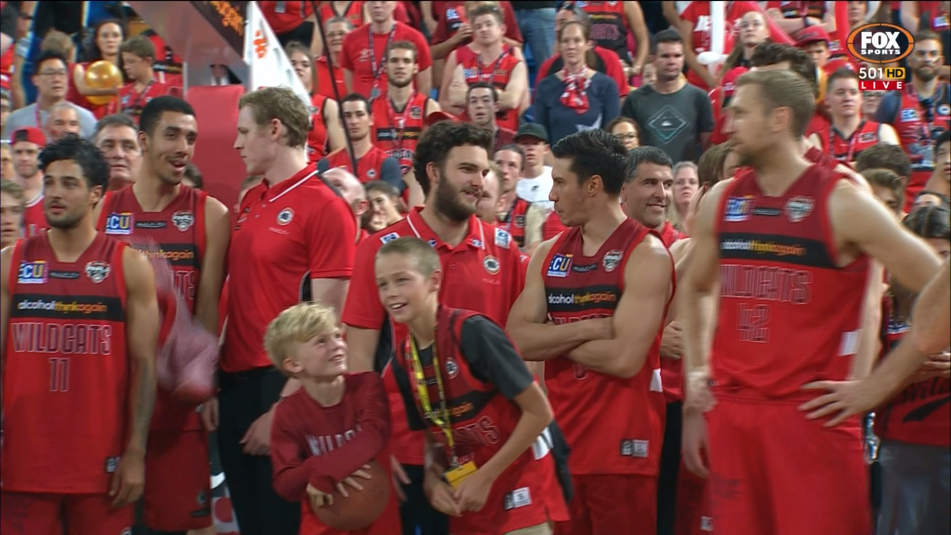

  1. Okay, burned Blu-Rays again. This time, set up my video camera on a stable surface, pulled up one of the internal white-balance patterns on my TV, white-balanced the camera, and took photos from each input.
    005 is the cable box. This is the target.
    006 is the first matrix conversion, from 601 to 709.
    007 is the second matrix conversion, 709 to 601.
    The latter two are very clearly a horrid shade of orange.
  2. Yeah...

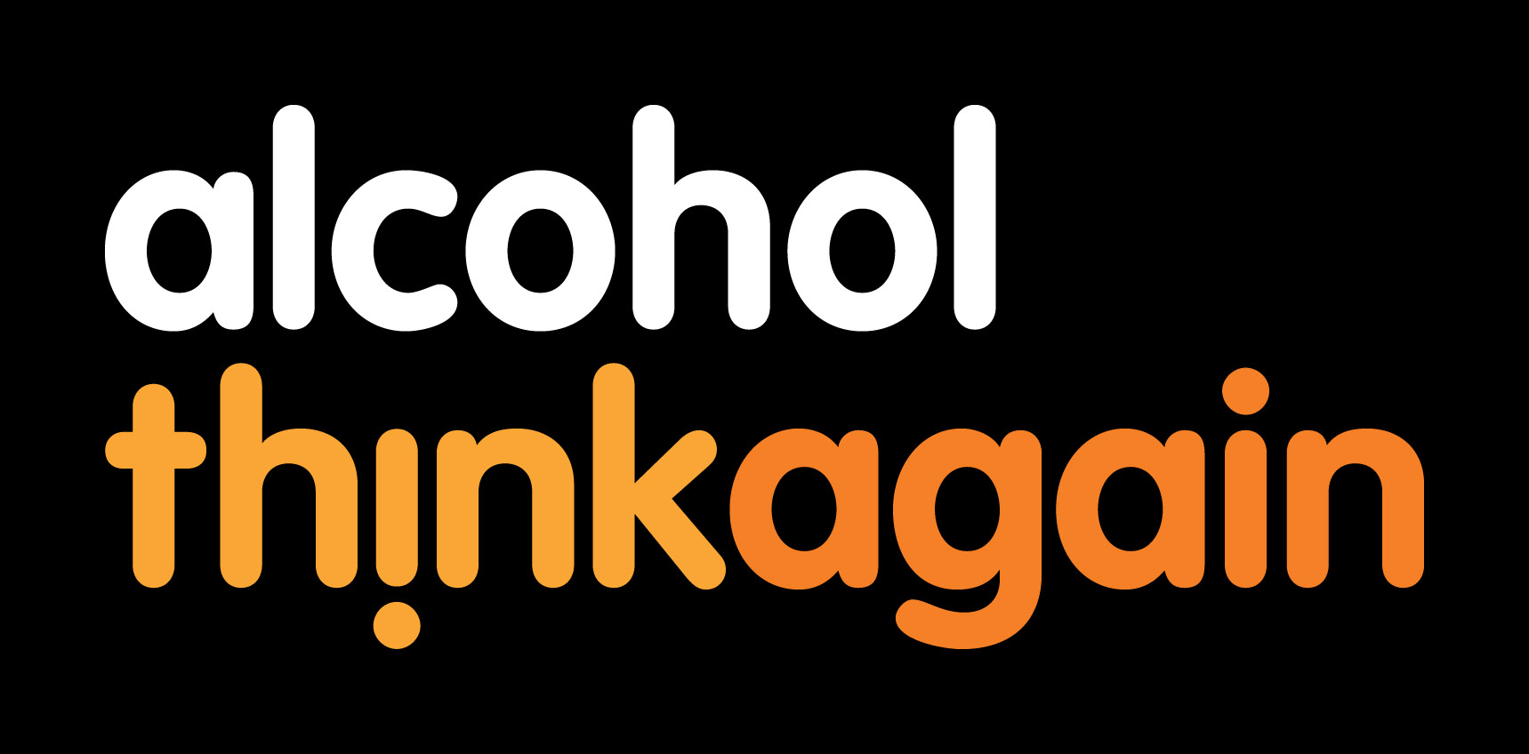

    I think everything is off, even your "target". I realize that it was taken from a camera, but much of the black detail is obscured
    But in terms of red/orange, the "alcohol think again" logo on the ground beneath the basket , I think the "again" supposed to be more orange, not red. A quick search on google shows some variation, but mostly more "orange" than red. Also go to another frame, with the gatorade jug. Usually that is orange, not red.
    So everything is off IMO, even your "goal" . I would use reference images of known colors and objects / logos as your guide. But it's up to you
  3. The lack of black detail is entirely to do with the exposure of the camera. I was erring on the side of not washing anything out. It seems to have tipped everything a bit towards red, too; the ATA logo is correct from the cable box on my TV screen.
    The exact colors aren't critical, it's more about the comparison between the cable version and the versions I can come up with.

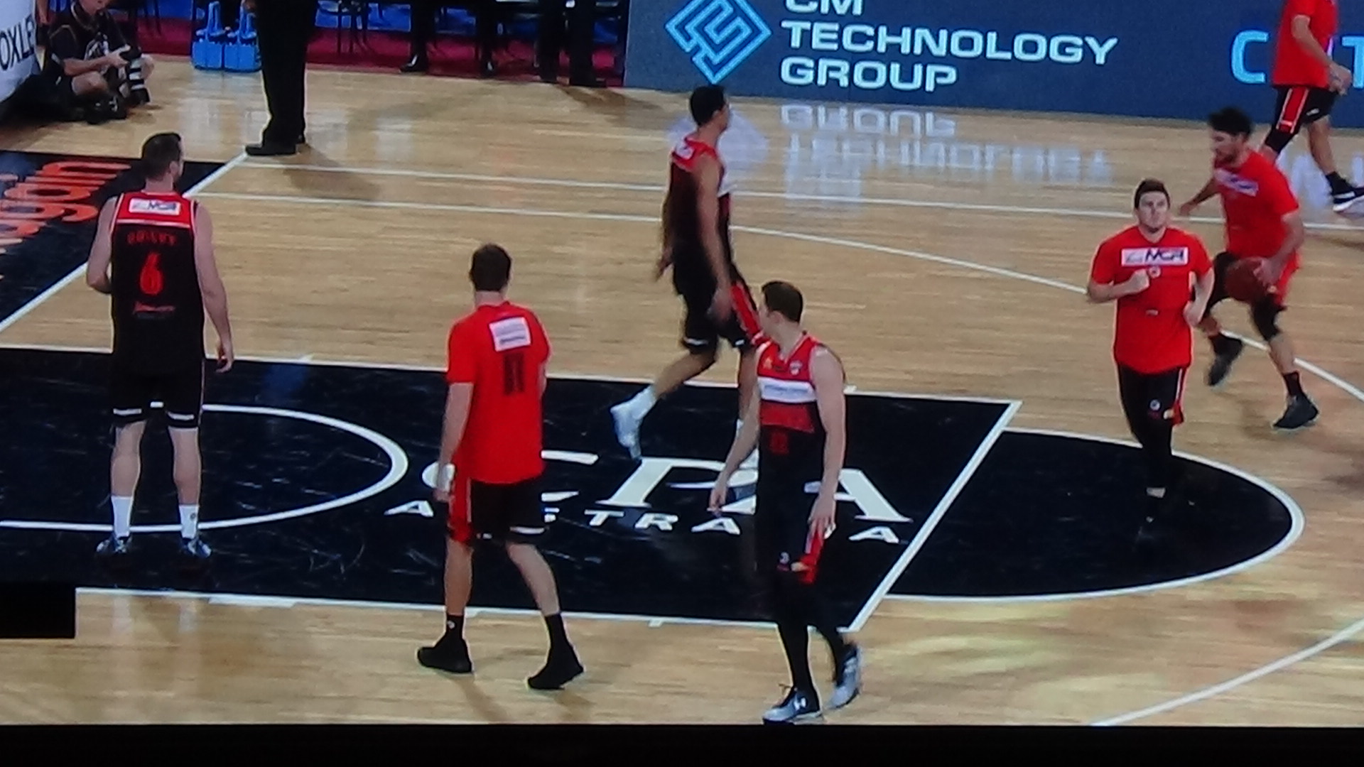

  4. Took another shot from the cable box.
  5. Difficult to judge those photos because of the exposure differences
    I think what you might want is 2 colormatrix shifts, one to "undo" the frameserver , and other to "undo" the 709 import.
    Can you upload 1 frame of the frameserver output as lagarith or ut ?

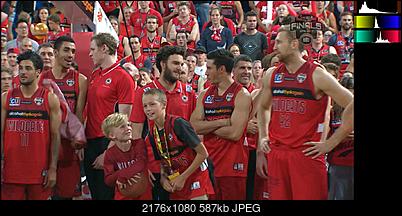

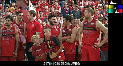

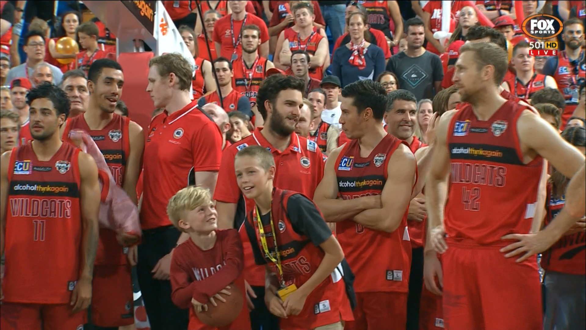

  6. I've got an mp4 file that hasn't been through television, or my crappy home capture methods. Only a couple of minutes of it though. Frame grabs from Premiere. So the MJPEG is coming in wrong, and the ffmpeg MP4 is coming in pretty much the same, except with more contrast for some reason. I tried setting fullrange to on in ffmpeg to see if that would help, and it didn't.
    Also attached a sample from the frameserver. Opened the frameserved AVI in Vdub, cut it down, fast recompress to Lagarith YUY2.
  7. Ugh, more fun.
    HD MP4 -> uncompressed UYVY AVI -> HD2SD -> 601 422 Ut -> Premiere...shifts red the other way, towards purple. Remains true if I output as uncompressed UYVY AVI from the HD2SD script.

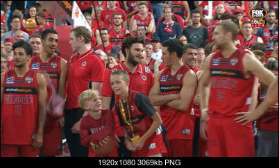

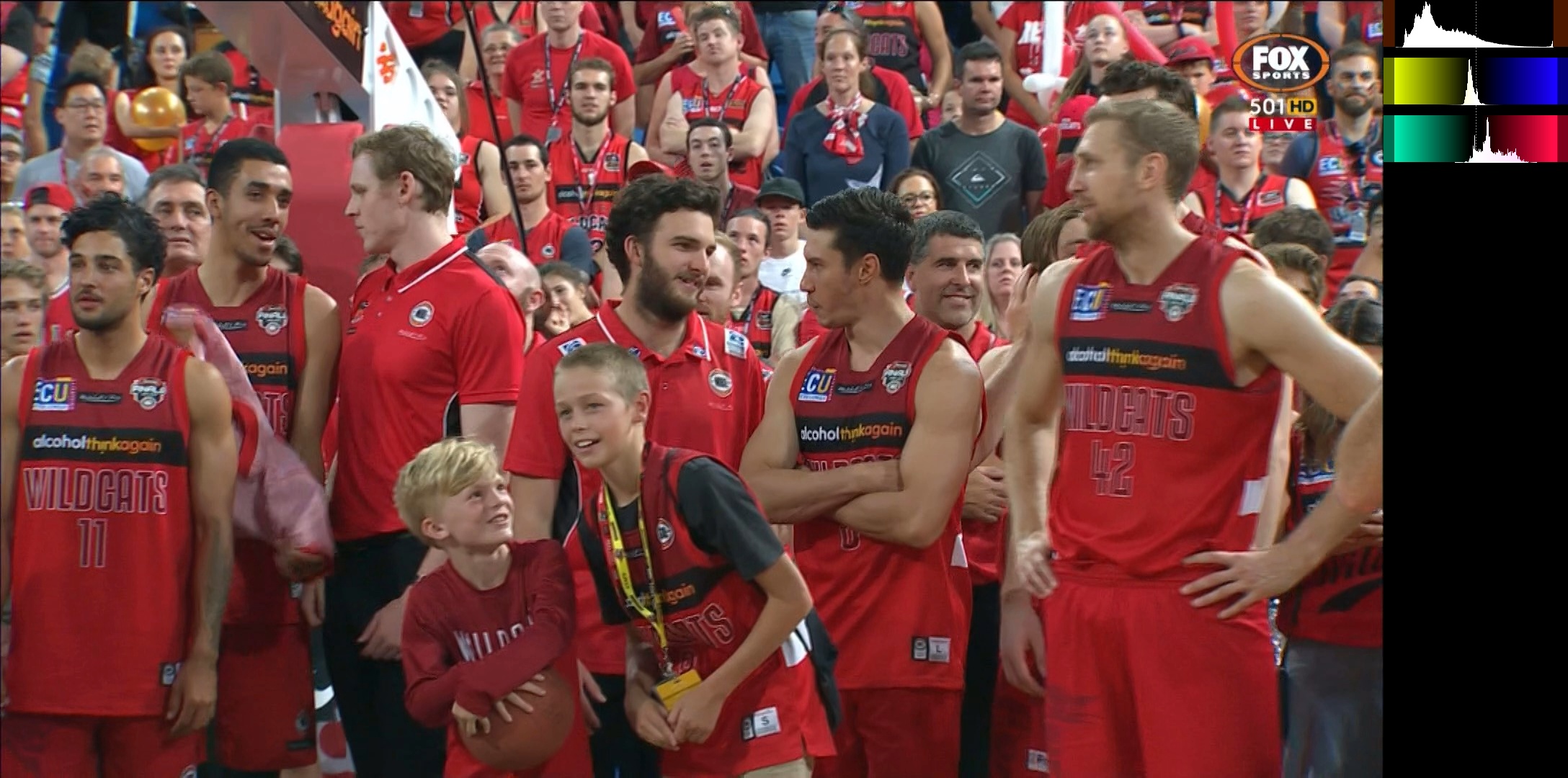

  8. The screenshot taken from the source mp4 looks more correct, at least to me. The "think" is more yellow, the "again" is more orange both matching the known logo. The "red" jerseys don't look oversaturated, and definitely not orange
    So basically you do the double shift mentioned earlier to "reverse" the problem incurred because of the frameserver and again from wrong import matrix. There is a slight yellow/green residual shift with that alone, perhaps from rounding, but it's easy to fix with something like coloryuv
    e.g
    AVISource("Frameserve.avi",audio=false)
    colormatrix(mode="rec.601->rec.709",clamp=0, interlaced=true)
    coloryuv(off_u=0.5, off_v=0.5)
    And the screenshot was taken by converting to RGB with 709
    How did I know what values to use off the u , v offsets ? Well you can do it by "eyeballing", but you can use histogram("levels") or any number of various monitoring/scopes in avisynth too
    I don't know what your ffmpeg mp4 is supposed to indicate. The ffmpeg -vf filter is because mjpeg decodes as full range yuvj422p (the "j" ) . In case you didn't notice, there were 2 versions of mp4's , one with the -vf filter, one without. The one with the filter should be full range data (same output from mjpeg decoder), but unflagged as full range. Thus it will look "illegal" on scopes, and over saturated. The point of doing it that way is so you have all the data so you can adjust it, instead of clipping or clamping. If you use the same command with MP4 input it won't work, unless it has been flagged full range. AVC will decode as standard range in ffmpeg unless it has a full range flag

  17. Well...it's bloody close, but it's still slightly off.

  19. So that's the same yellow green shift I mentioned earlier that coloryuv addressed; another way is smoothtweak(hue1=1, hue2=1) . Both give same results, both shift U,V to the right towards blue/red
    To do that in ffmpeg, one way is to apply a lut to u,v planes
    -vf lutyuv="u=val+1:v=val+1"
    If you had a linear chain of filters in ffmpeg, just separate them by comma
    Illustration (these are in jpg, to save bandwitdh), you can flip back and forth and notice the U,V shift
    src
    ffmpeg
    ffmpeg + avs (either coloryuv or smoothtweak as described above)
    ffmpeg + lut
  20. Originally Posted by koberulz View Post
    When you load an AVI directly in vdub (with the AVI driver) , file=>file information will list the VFW decoder used.
    As previously mentioned, it says 'internal DIB decoder' for the UYVY. It uses Ut for the Ut file.
    AviSynth doesn't support UYVY. So it has to find a filter that converts UYVY into something it does support. On my system it's one of UtVideo's filters * -- which converts to RGB32. Probably the same on yours. If you have ffdshow installed, you can use its "raw video" codec to convert UYVY to YUY2.
    * By the way, I determined this with GraphStudio.

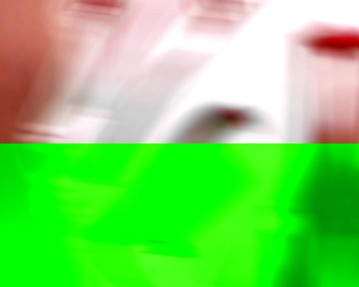

  26. The first frame is still green when I load it in VDub, but if I scrub past it and scrub back it's normal. Is that worth worrying about?
    Grabbed the msvc version, and there's no error anymore but Vdub completely locks up when I try to open the AVS using LwLibavVideoSource(), and I get a fatal error about being unable to read the source file if I use LSMASHVideoSource().
    The color shift in the EPS file appears isolated to PP, the PNGs in the sequence are fine in PS or Photo Viewer. The HD2SD avi file matches Premiere but the DVD-compliant m2v seems to match AE.
  27. Yes green frame is a problem . Do you get it without hd2sd ?
    Might be threading issue. Try threads=1 .
    FFVideoSource("video.avi", threads=1)
    for lsmash error, you sometimes get something like that when you have incompatible plugins autoloading in the avisynth plugins folder . Might be some of the ancient ones that hd2sd relies on. Some people manually load plugins in their scripts (plugins in subfolders, LoadPlugin(....) ) so you don't get those sorts of issues with old plugins
    But LWLibavVideoSource("BSB_sample.avi") works for me . I think I'm using an older version of the dll r901
  28. Yes, the green frame occurs without HD2SD. threads=1 changed nothing.
