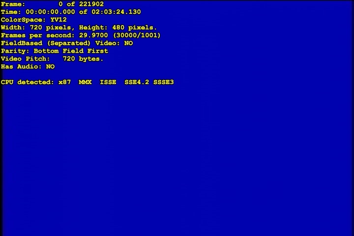

I'm trying to normalize the audio channels separately using the example from http://avisynth.nl/index.php/Normalize
I get this error. Getchannel: Attempted to request a channel that didn't exist.Code:video = AviSource("video.avi") left_ch = GetChannel(video,1).Normalize right_ch = GetChannel(video,2).Normalize return AudioDub(video, MergeChannels(left_ch, right_ch))
My AVI file is a Type 2 DV file. Here is the MediaInfo.
Code:General Format : AVI Format/Info : Audio Video Interleave Commercial name : DV Format profile : OpenDML File size : 24.9 GiB Duration : 2h 3mn Overall bit rate mode : Constant Overall bit rate : 28.9 Mbps Video ID : 0 Format : DV Duration : 2h 3mn Bit rate mode : Constant Bit rate : 24.4 Mbps Encoded bit rate : 28.8 Mbps Width : 720 pixels Height : 480 pixels Display aspect ratio : 4:3 Frame rate mode : Constant Frame rate : 29.970 fps Standard : NTSC Chroma subsampling : 4:1:1 Bit depth : 8 bits Scan type : Interlaced Scan order : Bottom Field First Compression mode : Lossy Bits/(Pixel*Frame) : 2.357 Time code of first frame : 00:55:49;05 Time code source : Subcode time code Stream size : 24.8 GiB (100%) Audio ID : 0-0 Format : PCM Muxing mode : DV Muxing mode, more info : Muxed in Video #1 Duration : 2h 3mn Bit rate mode : Constant Bit rate : 1 536 Kbps Encoded bit rate : 0 bps Channel(s) : 2 channels Sampling rate : 48.0 KHz Bit depth : 16 bits Stream size : 1.32 GiB (5%) Encoded stream size : 0.00 Byte (0%)
So there is no audio, at least "heard" by your AVISource VFW system
Is there audio when you use VLC, MPCHC etc... ?
This is bizarre:
Makes me think something is corrupted, at least with this videoCode:Bit rate : 1 536 Kbps Encoded bit rate : 0 bps Stream size : 1.32 GiB (5%) Encoded stream size : 0.00 Byte (0%)
Try another source filter as sneaker mentioned, and also test a different sample from that batch
