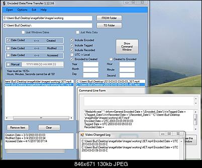

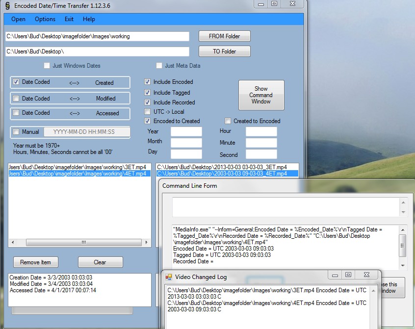

    Media Info should work with MPG IF the encoded date is actually encoded in it. If not It will just display information without the encoded/tagged dates.
    There is a MediaInfo CLI that you can use to obtain just this information. Below shows that the Encoded time is UTC 09:03:03 AM as set for this test and the correct local time for me is 03:03:03 AM because I am in USA CST (-6 Hours at March 03, -5 hrs during Daylight savings time.) Remember that normally the camera will put encoded in UTC which is NOT the local time the video was created.
Name:	ScreenHunter_214 Apr. 01 00.09.jpg

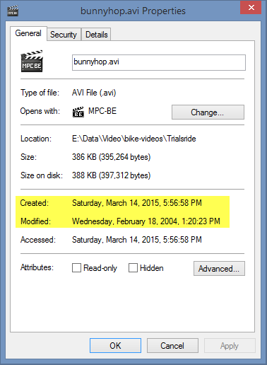

  6. Originally Posted by Moira123 View Post
    I tried the terminal thing and it is showing the same creation date as in the finder. Wrong. Its the copy date to the drive.
    On Windows anyway, if the file has been copied to a new drive, the Last Modified date will be earlier than the mislabeled Created date - and for unedited files, it will equal the original creation date.
    [Attachment 41112 - Click to enlarge]

    Raffriff42 is correct which is why i made the utility shown above and posted to this site change/add encoded date from the modified date if checked. This encoded date can then be used to change created modified date to match. Just depends on whether you check the created to encoded or encoded to created checkbox. Sometimes modified date is the only source of true video encoded time.

    Just so you know, the Utility takes the Windows Created OR the Manual OR the Windows Modified and sets it into the videos Encoded AND Tagged dates, if the Created to Encoded box is checked. If the Encoded to Created box is checked, it will take the Encoded OR Tagged OR Recorded date and set it into the corresponding Windows Created AND/OR Modified Dates.
    Also, if you try to modify say a video that does not allow Encoded/tagged/publisher/etc., FFMpeg will try to do it anyway and there goes the video so don't check alter original unless the original is a backup copy!!!!!!! You can also rename with date and time added to the original name as shown in the example above.
    I have made most everything drag and drop but error checking is minimal so as I mentioned I do not check things like every metadata tag for every video type and similar stuff. To be sure you can go to https://wiki.multimedia.cx/index.php/FFmpeg_Metadata and get a list of what is valid.

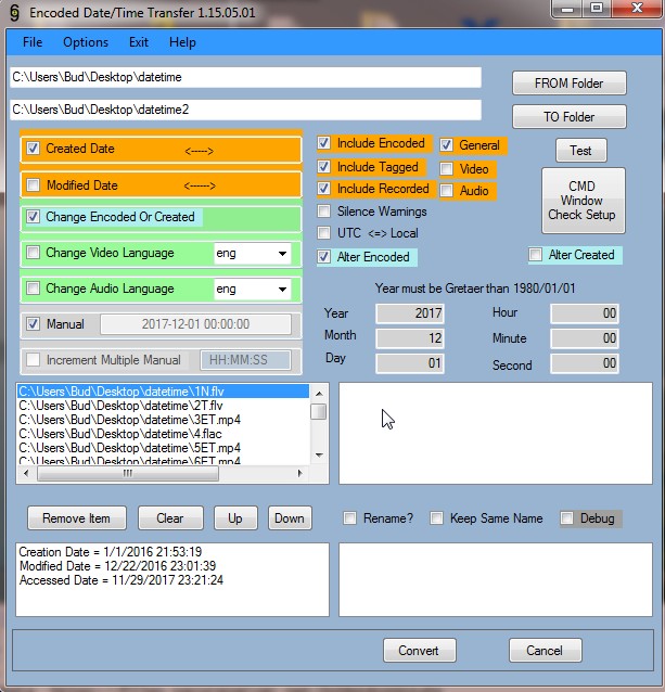

    Ok.. Major update and rewrite of code. Tests pretty well. You can now use Original Name or Date/time + Name or '-" + name.
    You can also silence the errors but get them in the summary window after. If you wish to set Encoded and Created both manually, set Encoded first then Created. Setting Encoded manually sets Created and modified to the original times.
    Change_Date_Time_NewForm3_1.12.4.6Beta Too many problems removed until reverted back without Cyrillic function
    UPDATE: https://forum.videohelp.com/threads/383072-Get-Original-Creation-Date?goto=newpost
    Budman1
    [Attachment 43891 - Click to enlarge]
