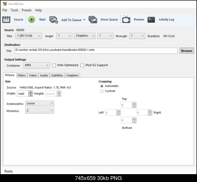

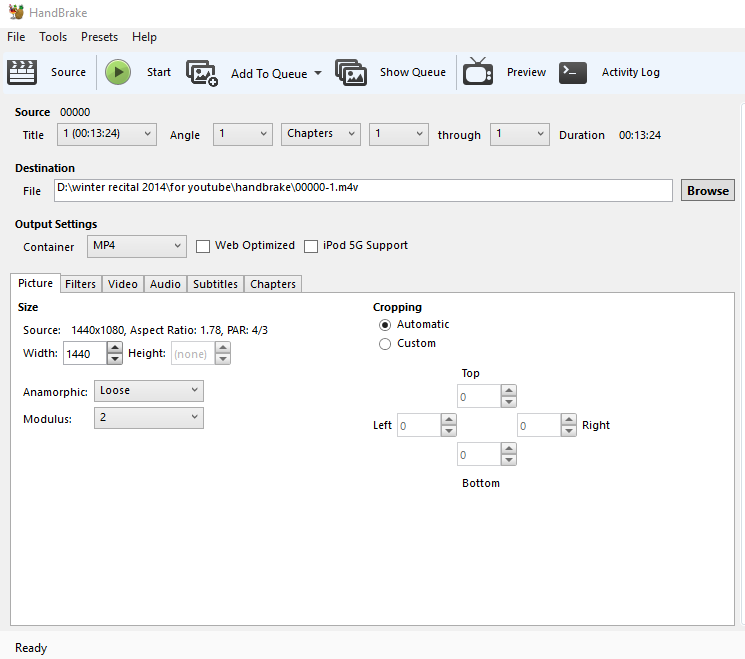

  3. If I drop it in handbrake, it tells me its 1440x1080, which comes out rectangular vertically and weird. If I stick it in Vegas, Vegas says its 1080i, 1920x1080 and looks fine. PAR in vegas says 16:9 and in Handbrake 4/3
    I'm not sure what to change to make it come out right, still new to handbrake
    Here's what it looks like if I just drop the file in and don't press anything
    And thanks a BILLION for your reply!

    I guess your Sony camera is recording in HDV 1080i, which actually records at 1440 × 1080 to save bandwidth. But when viewing the video it is designed to be played back at 16:9 (1920x1080). Similar to how all NTSC DVDs have a pixel resolution of 720x480, which either needs to be stretched to 16:9 or shrunk to 4:3 (~656x480) when played back by the DVD player.
    So if you are wanting to encode this video with handbrake, than you can just force it to resize your video to 1920x1080 by selecting "Anamorphic --> None", unclicking the "keep aspect ratio" and just forcing it to 1920x1080.
    Or maybe you have a AVCHD camera recording in 1440x1080, which can also be set to full 1920x1080 recording. The 1440x1080 also needs to be stretched on this format to 16:9 also.
  6. Thank you! I will try this!
  7. Handbrake will not allow me to set 1920x1080, whatever I type gets stuck back to 1440, Anamorphic is set to none and Keep aspect ratio is unchecked

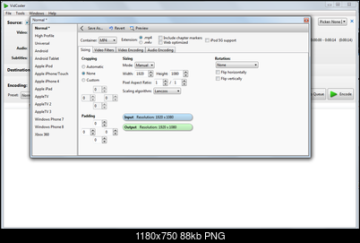

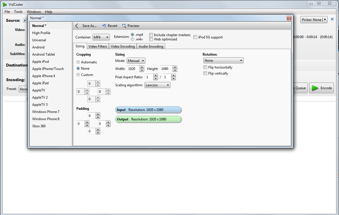

    Yeah Handbrake is a little buggy with anamorphic resolutions, been like that for a long time. I would try Vidcoder, which uses Handbrake's engine but a better GUI than standard Handbrake. Seems to allow for full manual mode when setting the resolution output.
    Be sure to set setting to
    Cropping: None (unless you need to crop)
    Sizing Mode: Manual (then set it to 1920x1080)
    Deinterlace: Yadif / Default / Default
    Framerate: Constant
    Once you are done, save your preset and use the new preset for encoding these 1440x1080 source videos.
