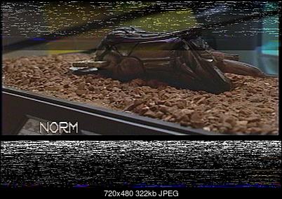

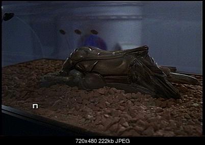

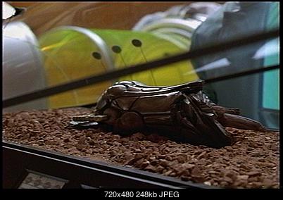

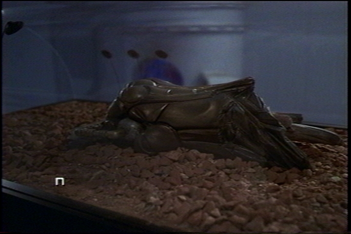

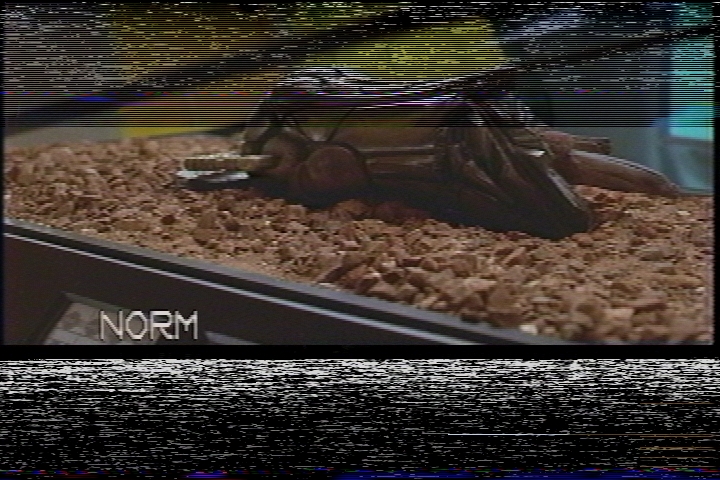

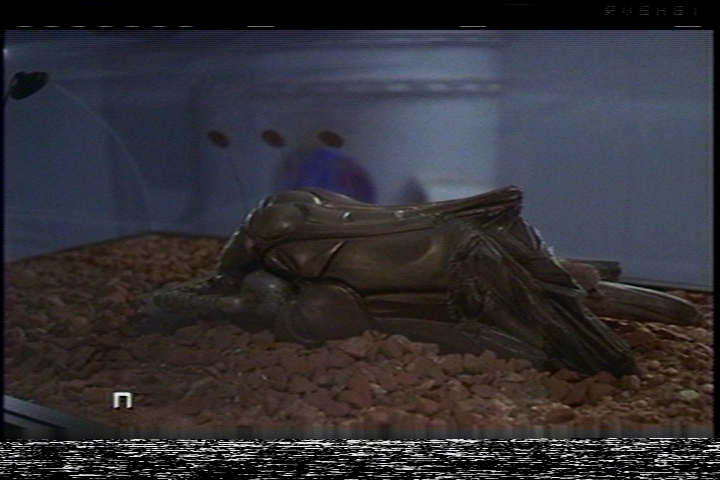

    I didn't get very far, because I discovered this isn't a normal alignment error. Here is my comment and the reply.
    Originally Posted by Me
    I've got a symptom that looks the same as your example here before alignment, but the degree of error changes every time that I Eject and then re-insert a tape. While checking this, it randomly played a tape perfectly, then was back to a partially-garbled image when I ejected and re-inserted the same tape. Any ideas what's going on? The VCR is a JVC HR-S5500U that I picked up.
    Originally Posted by 12voltvids
    It is probably one of the things I showed on the and other VJC videos I have done. The loose guide is a cause of intermittant alignment issues, and the capacitor in the PG pickup can cause the switching point to randomly appear in the picture and resembles an alignment error.
Name:	The Fifth Element (alignment issue demo) good V1 - 2.jpg
ID:	41733Click image for larger version
Name:	The Fifth Element (alignment issue demo) bad V1 - 2.jpg
ID:	41735Click image for larger version
Name:	The Fifth Element (alignment issue demo) good V1 - 1.jpg
ID:	41734Click image for larger version
Name:	The Fifth Element (alignment issue demo) bad V1 - 1.jpg

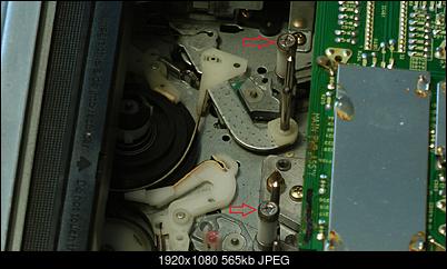

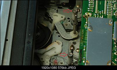

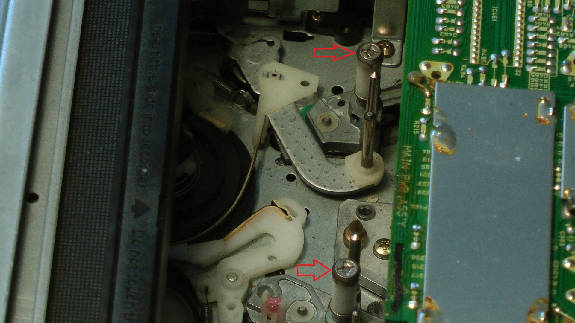

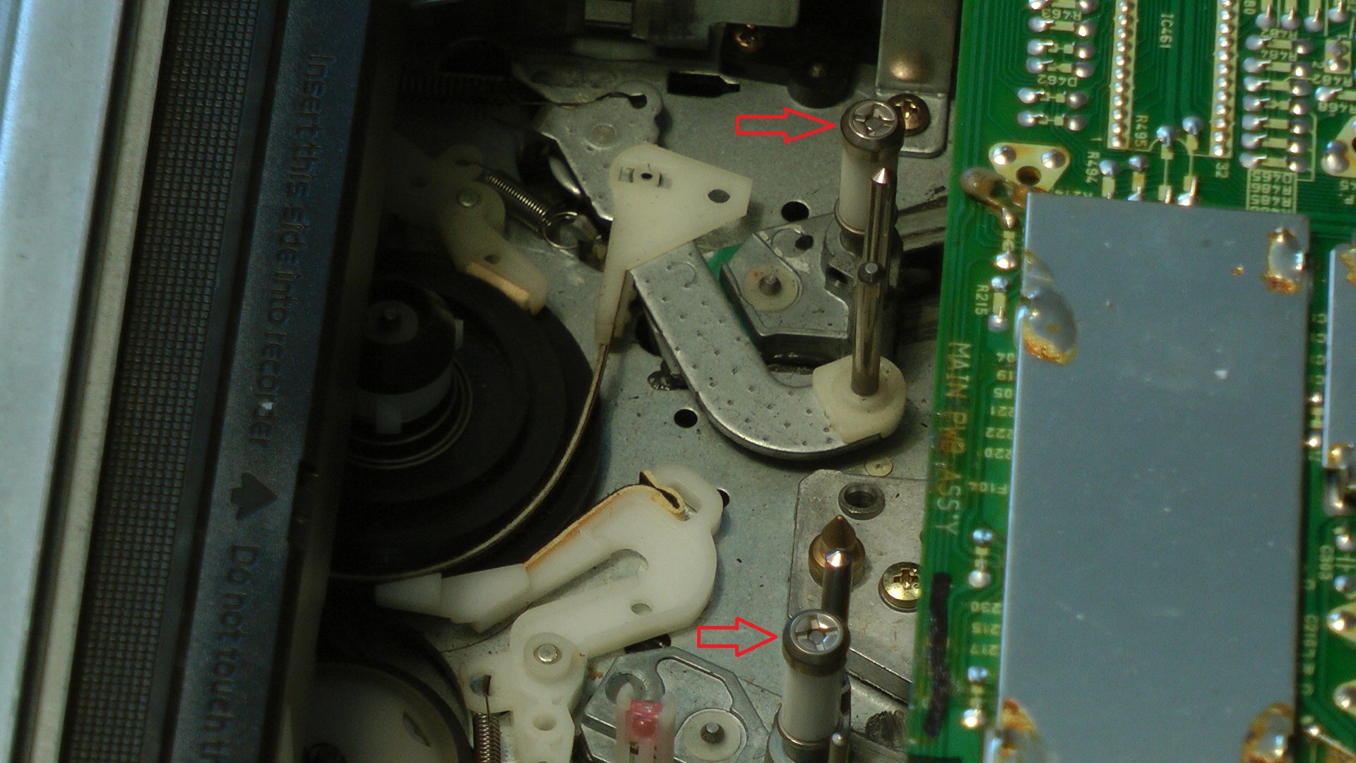

    I was shooting video of the VCR internals when I noticed this. I'd say these photos indicate that the guides didn't move at all between inserting the tape and then ejecting it. So it seems to be an electronic issue rather than mechanical; probably the capacitor failure he mentioned.
Name:	After insert 1.jpg
ID:	41731Click image for larger version
Name:	Before insert 1.jpg
    In the one 37-minute capture I made while playback was working, I didn't like the picture quality anyway. It has the same "dark trailing" to the right of brights as my JVC HM-DH5U, visible on the "N" in the screenshot. So I may just end up dropping this off to 12voltvids and he can make a video repairing it, if he chooses.

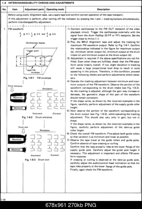

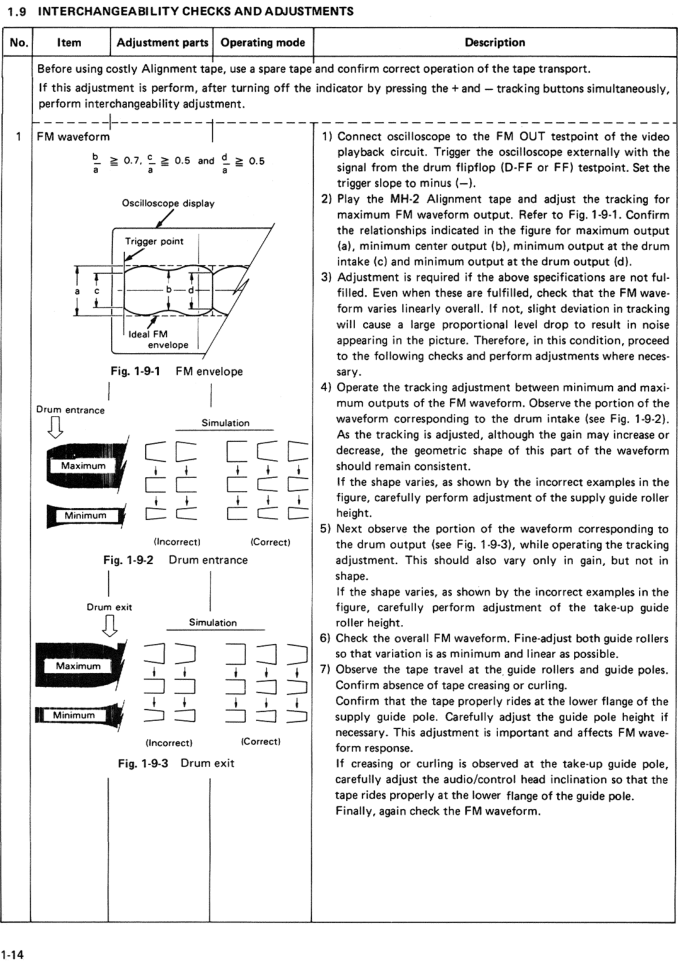

    Here is the page from the JVC HR-S5500E service manual that I found online, since I couldn't find a free source for the US version and I'm not interested enough to buy it. The only numbers provided are ratios.
Name:	JVC HR-S5500E service manual, section 1.PNG
    What counts is the position when the tape is loaded. It takes only a minute change to screw up the picture. Make sure those guides with the slant poles have no up-and-down play and that they travel all the way to the stops when the tape is loaded.

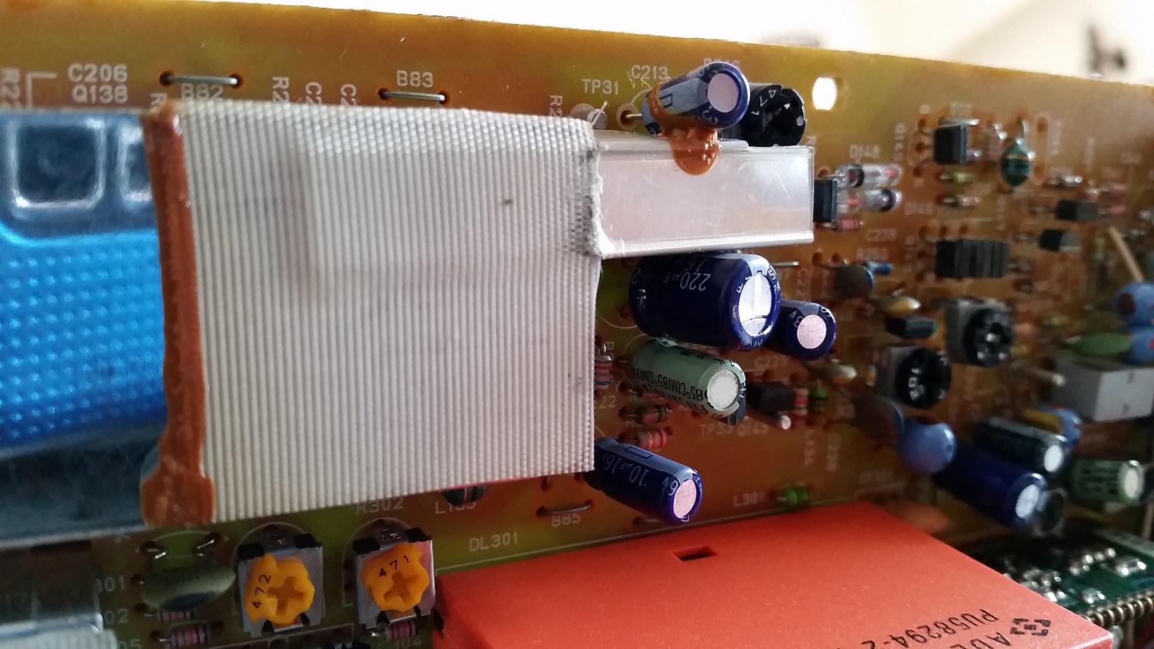

  18. Formerly 'vaporeon800' Brad's Avatar
    Apr 2001
    Vancouver, Canada

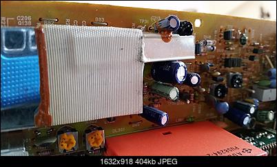

    Oh, I completely missed the fact that the black terminal board with the RCA/S-Video jacks is all one piece with the mainboard that pulls upward completely. I thought I would have to separate them and pull towards the front of the unit. That was simple indeed. Thanks.
    EDIT: Eww.

    Aug 2010
    San Francisco, California
    Don't eat jelly doughnuts when you work on the VCR.
    Seriously, where'd that gunk come from?
  20. Formerly 'vaporeon800' Brad's Avatar
    Apr 2001
    Vancouver, Canada
    Oh. I assumed it was leaked electrolyte. I see now that the first Google result for "leaked electrolyte" quotes Wikipedia's capacitor plague article:
    Originally Posted by Wikipedia
    The leaked electrolyte can be confused with thick elastic glue sometimes used to secure the capacitors against shock. A dark brown or black crust up the side of a capacitor is invariably glue, not electrolyte. The glue itself is harmless.
