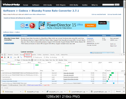

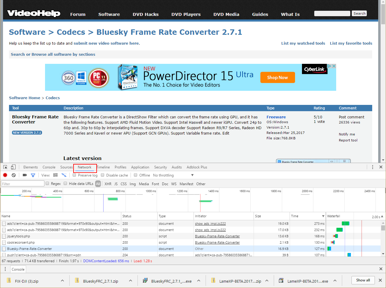

  13. I'm a MEGA Super Moderator Baldrick's Avatar
    Are all pages slow? Like www.videohelp.com/software/MKVtoolnix
    If you can download files fast it must be something that blocks the site rendering. In for example Chrome turn on Developer tools under More tools. Click on the Network tab. Reload the forum page and see if you something that loads really slow.
    It looks like:
  14. Member koberulz's Avatar
    Oct 2006
    Australia
    It seems to spend most of its time just 'Waiting for www.videohelp.com'.
Name:	Screenshot 2017-03-26 14.36.39.png
  15. I'm a MEGA Super Moderator Baldrick's Avatar
    Very strange. I have never seen the Status code 304 (see https://www.w3.org/Protocols/HTTP/HTRESP.html ). It should be 200.
    See also http://www.telerik.com/blogs/understanding-http-304-responses
  16. Member koberulz's Avatar
    Oct 2006
    Australia
    I just hit F5 on this page after seeing the dev tools suggestion in this thread in order to generate that last screenshot. Hitting Ctrl+F5 results in this.
Name:	Screenshot 2017-03-26 17.11.54.png
