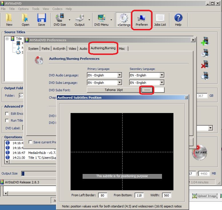

    Hi, I have a .MKV and a .srt and when I ran everything as usual I ended up with the subtitle covered by the bottom edge of my CRT TV bezel [old and poor, don't bug me about it please]. There is quite a bit of distance from the bottom of the video image and the bottom of the screen. I worked at a TV station for 20 years but left before learning much about digital TV so I have a _bit_ of knowledge: the TV image is over scanned to make the picture look bigger, which makes the problem worse - or may be the whole problem.
    I would like to set AVStoDVD to put the subs at least 3 inches [x pixels] higher on the screen.
    Has anyone ever asked anything like this before? Would AVStoDVD even recognize the need? Am I stuck? Not a total Newbie to AVStoDVD, per se, but, some of the alphabet jumbles I have seen in other answers went right over my head.

    Yes this can be done in AvstoDVD. Open the preferences/authoring-burning tab
    To the right of where it says "DVD subs font" there are three buttons. The middle
    button controls the subs position.
    After you set it remember to save current preferences as default.
    Then reload the project
  4. You can also raise them after having made the DVD by using DVDSubEdit. The user manual explains how:
    http://download.videohelp.com/DVDSubEdit/UserManual/helpfile.htm
    You'll want to read 2.7 Modifying the subtitle vertical positions by hand. Or section 2.8.

    Sambat and Davexnet: Thank you! I never would have thought to click on the ...
    Now to find out how much is enough.
