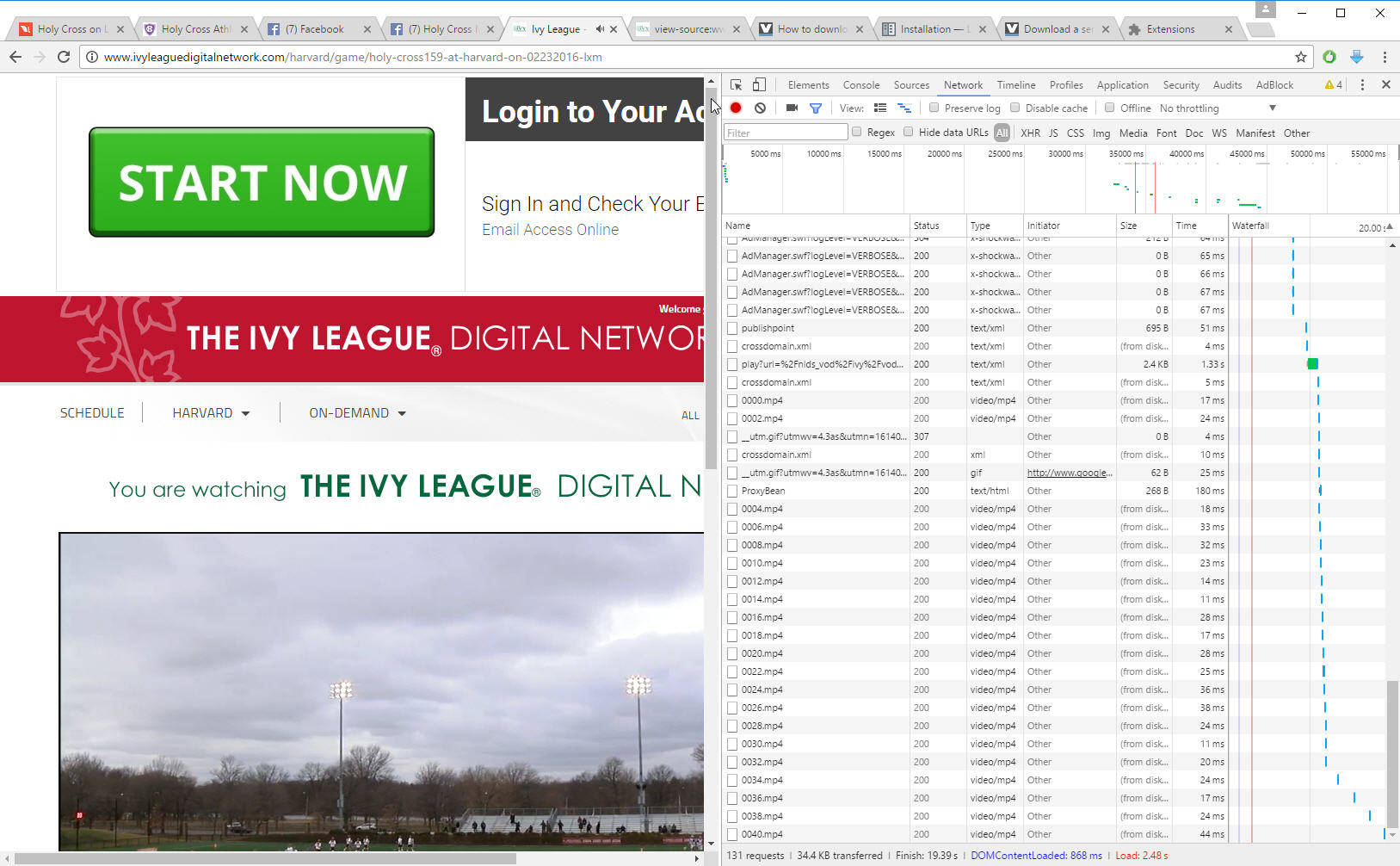

    Here is a link to a pic showing the Chrome Developer Tool network log (I couldn't figure out how to attach it to the post) - http://vogithebear.com/network%20console.jpg

  4. With a little guessing I came up with this m3u8 link:
    http://aznlvod01.cdnllnwnl.nlss.neulioncloud.com/nlds_vod/ivy/vod/2016/02/23/10335/2_1..._3000.mp4.m3u8
    I can't view the page without an account/password but if you view the page source and search for m3u8 you'll probably find such a link.
    You can use ffmpeg or youtube-dl to download via the link:
    ffmpeg -i http://aznlvod01.cdnllnwnl.nlss.neulioncloud.com/nlds_vod/ivy/vod/2016/02/23/10335/2_10335_t1_mlc-harv_2016_h_whole_1_3000.mp4.m3u8 -vcodec copy -acodec copy -bsf:a aac_adtstoasc output.mp4
